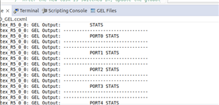

    I tried to comment the loop in the following screenshot where the code was stuck trying to find a PHY :
    As a result, the code completes the initialization and the scheduler starts, and we get in the idle task, but I have several failed :
    Also, I don't understand why MAC port 1 is searching for a PHY even if we attrbuted .phyaddress = ENETPHY_INVALID_PHYADRRESS
    I can double check if the code goes to CSL_serdesIPSelect(), because SERDES2_LN2_CTRL_LANE_FUNC_SEL is still 0.
    I am using CCS' debugger to go through the code after the boot is complete, so I think the ethfw's Serdes configuration should erase the one from u-boot, but I am not sure. I can still deactivate it from u-boot, can you confirm from which file I can do it ?

    Here you can see the screenshot of the statistics :
    You won't get the statistics correctly using gel script or by reading the CPSW registers, because by default ETHFW running a task to read CPSW statistics.
    Please use the patch shared in below FAQ for collecting the CPSW statistics.

    I applied the patch that you mentioned, and below are the stats :
    From above statistics, it seems like only Tx from CPSW Port-1 is happening, but no Rx packets.
    Can you check your PHY side if PHY is available, or peer side if it is MAC2MAC connection.
