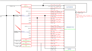

        could you check the PMIC used in your design?
       Semon
  • we used PMIC-A&B

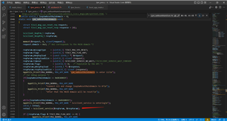

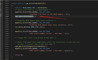

  • hello Karan
         please help check why enter mcu_only mode, the print is unknown symbols?
        Semon
    Sciclient_procBootReleaseProcessor, ProcId 0x20...
    Calling Sciclient_procBootRequestProcessor, ProcId 0x20...
    Sciclient_procBootSetProcessorCfg, ProcId 0x20, EntryPoint 0x70000000...
    Sciclient_pmSetModuleClkFreq, DevId 0xca @ 2000000000Hz...
    Sciclient_pmSetModuleState Off, DevId 0xca...
    Sciclient_pmSetModuleState On, DevId 0xca...
    Sleeping for 30 seconds after each stage
    âïïôíáððúàóôáòôåäàáôà÷ôðñððñàõóåãííêâïïôàáððúàôïôáìàîõíàâïïôåäàãïòåóàýàøííêâïïôàáððúàâïïôåäàãïòåàéäàãñðàáôàñðõõõððñàõóåãóííêâïïôàáððúàâïïôåäàãïòåàéäàãññàáôàññùðôððñàõóåãóííêâïïôàáððúàâïïôåäàãïòåàéäàãñòàáôàòöôõóððñàõóåãóííêâïïôàáððúàâïïôåäàãïòåàéäàãñóàáôàò÷øðòððòàõóåãóííêâïïôàáððúàâïïôåäàãïòåàéäàãñöàáôàòùñôóððñàõóåãóííêâïïôàáððúàâïïôåäàãïòåàéäàãñ÷àáôàóðôøôððñàõóåãóííêâïïôàáððúàâïïôåäàãïòåàéäàãñøàáôàóñø÷÷ððñàõóåãóííêâïïôàáððúàâïïôåäàãïòåàéäàãðàáôàôøñðõððñàõóåãóííêííêíãõàâïïôàôáóëàóôáòôåäàáôà÷ôðñððñàõóåãóàáîäàæéîéóèåäàáôà÷øöñòððôàõóåãóíííêãáììéîçàòðíóçÿåøéôÿòåóðïîóåôáóëííêåøéôéîçàòðíóçÿöäåöíïîéôïòæøîáííêòåóðïîäåòàôáóëàóèïõìäàèáöåàåøéôåäííêíãõàïîìùàáððúàéîóéäåàíãõàïîìùàôáóëáííêíãõàïîìùàáððúàäéóáâìéîçàíáøôÿïõôòçÿåîàæïòàôíðóåîóñúôàéîàíáéîàäïíáéîáííêíãõàïîìùàáððúàóôáôåàéîæïàúúàãõòòåîôìùàéîàáãôéöåàíïäåáííêíãõàïîìùàáððúàìåäàìäõàóèïõìäàâåàïîííêíãõàïîìùàáððúàóìååðéîçàæïòàñðóìàðìåáóåàíåáóõòåàôðñóóàáîäàôðñóôáííêíãõàïîìùàáððúàåøðåãôåäàöáìõåóàéîàáãôéöåàíïäåúííêôðñóóúàèéçèííêôðñóôúàèéçèííêíãõàïîìùàáððúàããããããããããããããããããããããããããããáãôéöåàíþàíãõàïîìùàíïäåããããããããããããããããããããããããããããííêíãõàïîìùàáððúàéóóõåéîçàáàó÷àòåóåôàôïàôèåàíáéîàäïíáéîîîîííêíãõàïîìùàáððúàåîáâìéîçàíáéîàäïíáéîàäååðàóìååðàéóïìáôéïîîîîííêíãõàïîìùàáððúàðíéãàóôáôåàãèáîçåúàáãôéöåàíþàíãõàïîìùîîîííêíãõàïîìùàáððúàéîôÿôïðàýàðøðííêíãõàïîìùàáððúàéîôÿóôáòôõðàýàðøðííêíãõàïîìùàáððúàéîôÿçðéïàýàðøðííêíãõàïîìùàáððúàéîôÿçðéïñÿøàýàðøðííêíãõàïîìùàáððúàòåáäàæóíÿîóìååðÿôòéççåòóàýàðøóííêíãõàïîìùàáððúà÷òéôåàæóíÿîóìååðÿôòéççåòóàýàðøòííêíãõàïîìùàáððúàòåáäàæóíÿîóìååðÿôòéççåòóàýàðøòííêíãõàïîìùàáððúà÷òéôåàéîôÿóôáòôõðàýàðøòííêíãõàïîìùàáððúàéîôÿôïðàýàðøðííêíãõàïîìùàáððúà÷òéôåàéîôÿóôáòôõðàýàðøãøííêíãõàïîìùàáððúàéîôÿçðéïàýàðøðííêíãõàïîìùàáððúàéîôÿôïðàýàðøðííêíãõàïîìùàáððúà÷òéôåàéîôÿçðéïàýàðøòííêíãõàïîìùàáððúàæéîáìàòåáäàéîôÿôïðàýàðøðííêíãõàïîìùàáððúàæéîáìàòåáäàæóíÿîóìååðÿôòéççåòóàýàðøòííêíãõàïîìùàáððúàðíéãàóôáôåàãèáîçåúàáãôéöåàíþàíãõàïîìùîîîäïîåííêíãõàïîìùàáððúàãããããããããããããããããããããããããáãôéöåàíþàíãõàïîìùàíïäåàäïîåããããããããããããããããããããããããããííêíãõàïîìùàáððúàóôáôåàéîæïàúúàîï÷àéîàíãõàïîìùàíïäåáííêíãõàïîìùàáððúàìåäàìäõàóèïõìäàâåàïææííêíãõàïîìùàáððúàóìååðéîçàæïòàñðóìàðìåáóåàíåáóõòåàôðñóóàáîäàôðñóôáííêíãõàïîìùàáððúàåøðåãôåäàöáìõåóàéîàíãõàïîìùàíïäåúííêôðñóóúàèéçèííêôðñóôúàìï÷ííêíãõàïîìùàáððúàããããããããããããããããããããããããããããíãõàïîìùàíþàáãôéöåàíïäåããããããããããããããããããããããããããããííêíãõàïîìùàáððúàðíéãàóôáôåàãèáîçåúàíãõàïîìùàíþàáãôéöåîîîííêíãõàïîìùàáððúàéîôÿôïðàýàðøðííêíãõàïîìùàáððúà÷òéôåàãïîæéçÿñàýàðøãðííêíãõàïîìùàáððúà÷òéôåàæóíÿîóìååðÿôòéççåòóàýàðøóííêíãõàïîìùàáððúà÷òéôåàãïîæéçÿñàýàðøðííêíãõàïîìùàáððúàòåáäàæóíÿîóìååðÿôòéççåòóàýàðøóííêíãõàïîìùàáððúàðíéãàóôáôåàãèáîçåúàíãõàïîìùàíþàáãôéöåîîîäïîåííêíãõàïîìùàáððúàäéóáâìéîçàíáéîàäïíáéîàäååðàóìååðàéóïìáôéïîîîîííêíãõàïîìùàáððúàãïîæéçõòåà÷ëõðíãõòíáéîàáîäàíáéîò÷ëõðíãõàâòéäçåóîîîííªûãõàïîìùàáððúà÷ëõðíãõòíáéîàáîäàíáéîò÷ëõðíãõàâòéäçåóàãïîæéçõòåäàóõããåóóæõììùáííêíãõàïîìùàáððúàãïîæéçõòéîçàóãéãìéåîôÿâïáòäàæïòàíáéîàäïíáéîííêíãõàïîìùàáððúàäïéîçàâïáòäàéîéôîîîííêMCU only app: Trying to access MAIN domain peripherals...
    MCU only app: Writing to DDR...
    MCU only app: Reading from DDR...
    MCU only app: Read value matches the value written for DDR!
    MCU only app: Writing to MSMC...
    MCU only app: Reading from MSMC...

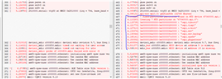

  • Hello Karthikey
         I tried the prebuild image for mcu_only test, with above error log,
         could you help check it
         the detail log is here:

  • Hi, Semom Zhang
    this a normal log in sd-spl mode, pls checkt it
    MobaXterm_COM26USBSerialPortCOM26_20241212_141830.txt
  • The rootfs is not mounting. Based on whether SD or eMMC that needs to be added in the dts. /dev/mmcblk1p2 is pointing to MMC SD.
    - Keerthy
    hello Keerthy
         customer set root device to mmcblk1p2
         and this is on main_sdhci1
          the problem is that after system power up, mmc1 is not initialized correctly, and cant work
          but the same image can work properly
         will the dts change cause the mmc1 not work?
        Semon

    MCU only app: Inside MCU ONLY task!
    MCU only app: Disabling MAXT_OUTRG_EN for TMPSENS1:4 in MAIN domain!
    MCU only app: STATE INFO :: CURRENTLY IN ACTIVE MODE!
    MCU only app: LED LD5 should be ON
    MCU only app: Sleeping for 10s, please measure TP133 and TP134!
    MCU only app: Expected values in ACTIVE mode:
    TP133: HIGH
    TP134: HIGH
    MCU only app: ############################ACTIVE -> MCU ONLY MODE############################
    MCU only app: Issueing a SW reset to the MAIN domain...
    MCU only app: Lpm_swResetMainDomain is enter 111
    MCU only app: Sciclient_service is entering
  • Hi, Semon Zhang
      I run "modprobe -r ti_k3_r5_remoteproc"  command in linux shell ,as above show, pls help check it , tks~
    Reguards
    liupingping
