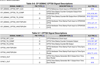

  • Thanks to both of you for the quick answers. My concern is regarding the pins to book in the sysconfig tool (where the name of the peripherals are not the same than in the datasheet or tech ref).
    Let's simplify to our most common use case. We'd like to get the reference time from ETH packets coming from the PTP master. From your answers, I guess that CP GEMAC CPTS0  (= CPSW0 CPTS ? ) ressource are used (rather than CPTS0).
    For now, these are internal only process and signals (which signals by the way? ) ?  so nothing to book in sysconfig, right ?

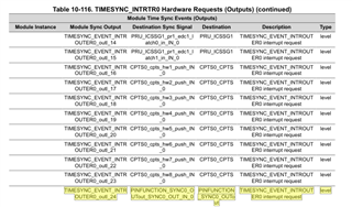

    Then I'd like to derive a trigger out sync on these reference time (to have IO or ADC synchronized acquisition)
    Which signals should I book in sysconfig ? It look like there is no SYNCx_OUT available in CP GEMAC CPTS0 only in CPTS0  !
    and how do I link it to the CPSW0 CPTS ? using the TSR ?
  • Hello JPK,
    It looks like there is a CP_GEMAC_CPTS0_TS_SYNC signal from the table listed in the AM64x datasheet.
    In the TRM Figure 12-344, you can also see that the CPSW CPTS has an output CPSW0_CPTS_SYNC_0 (I believe this should be the same signal as CP_GEMAC_CPTS0_TS_SYNC).
    However, if you'd like to test this out on an AM64x SK or EVM, we have an example where we used TSR (Time Sync Router) to route the signal from CPSW0_CPTS_GENF1 (ID 22) to the SYNC0_OUT signal (ID 24, pin D18) in https://e2e.ti.com/support/processors-group/processors/f/processors-forum/1300940/am6442-1-pps-from-sk-am64b
