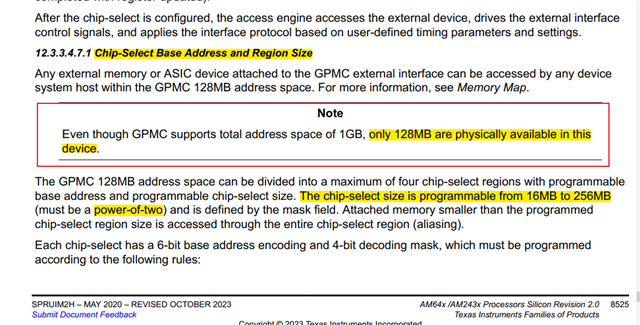

We used the MT29F4G08ABB 4Gb space, AD0~AD7 shared by address and data lines, and only CS0 was used.
However, from the following description in the TRM, does it mean that some of the space is not actually accessed? ? Or does the 128MB address space here only have this limitation when the address bus A0~A26 is used to directly access external devices?
For NAND devices with 8-bit address bus and sending addresses in batches, there is no such limitation? ?
