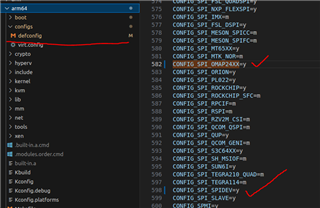

I need to enable the MCSPI3 function, and the TDA4 is the master. I followed the operation of this document and imitated SPI6 to set SPI3. The result was that the spidev node under /dev/ was not generated.

    The following are the modifications to the dts and spidev.c in my project. SDK is the  "ti-processor-sdk-linux-adas-j721e-evm-10_00_00_08-Linux-x86-Install"
    --- /home/sijia/Linux_SDK/board-support/ti-linux-kernel-6.6.32+git-ti/drivers/spi/spidev.c	2018-03-09 20:34:56.000000000 +0800
    +++ /home/sijia/TDA4_SDK/Linux/board-support/ti-linux-kernel-6.6.32+git-ti/drivers/spi/spidev.c	2024-11-13 11:02:24.822241076 +0800
    @@ -732,6 +732,7 @@
     static const struct of_device_id spidev_dt_ids[] = {
    +	{ .compatible = "linux,spidev", .data = &spidev_of_check },
     	{ .compatible = "cisco,spi-petra", .data = &spidev_of_check },
     	{ .compatible = "dh,dhcom-board", .data = &spidev_of_check },
     	{ .compatible = "lineartechnology,ltc2488", .data = &spidev_of_check },
    --- /home/sijia/Linux_SDK/board-support/ti-linux-kernel-6.6.32+git-ti/arch/arm64/boot/dts/ti/k3-j721e-common-proc-board.dts	2018-03-09 20:34:56.000000000 +0800
    +++ /home/sijia/TDA4_SDK/Linux/board-support/ti-linux-kernel-6.6.32+git-ti/arch/arm64/boot/dts/ti/k3-j721e-common-proc-board.dts	2024-11-13 10:19:44.085397874 +0800
    @@ -334,6 +334,15 @@
     			J721E_IOPAD(0x200, PIN_INPUT, 7) /* (AC4) UART1_CTSn.GPIO0_127 */
    +	spi3_pins_default: spi3_pins_default {
    +        pinctrl-single,pins = <
    +            J721E_IOPAD(0x144, PIN_INPUT, 4) /* (Y25) PRG0_PRU1_GPO17.SPI3_CLK */
    +            J721E_IOPAD(0x148, PIN_INPUT, 4) /* (AA26) PRG0_PRU1_GPO18.SPI3_D0 */
    +            J721E_IOPAD(0x14c, PIN_INPUT, 4) /* (AA29) PRG0_PRU1_GPO19.SPI3_D1 */
    +            J721E_IOPAD(0x11c, PIN_INPUT, 4) /* (AA24) PRG0_PRU1_GPO7.SPI3_CS0 */
     &wkup_pmx0 {
    @@ -995,3 +1004,16 @@
    +&main_spi3 {
    +	status = "okay";
    +    pinctrl-names = "default";
    +    pinctrl-0 = <&spi3_pins_default>;
    +    spidev@0 {
    +        spi-max-frequency = <24000000>;
    +        reg = <0>;
    +        compatible = "linux,spidev";
    \ No newline at end of file
    After I modified it, I executed
    #make linux
    and then executed
    #sudo make linux_install
    to update my SD card.
    Below is the startup log
    2555.start_log.txt

  • Hi Sijia,
    Looks like the 6.6 Linux kernel used in 10.0 SDK has some additional checks for spidev and the compatible field needs to be unique.
    https://e2e.ti.com/cfs-file/__key/communityserver-discussions-components-files/791/0001_2D00_J721E_2D00_TDA4VM_2D00_10.0_2D00_SDK_2D00_enable_2D00_spi3.patch
    ^ Could you try above patch? With this, I see spidev get created under /dev.
    Takuma
  • Hello, Takuma
        It works. Thank a lot.
