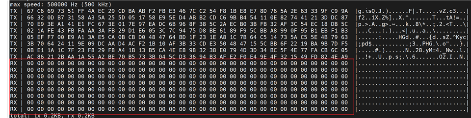

latest SDK + spi patch from  0001-J721E-TDA4VM-10.0-SDK-enable-spi3.patch, TDA4VM as SPI master,Tx(D1) works well from spi waveform view, but Rx(D0) seems wrong
we use TDA4VM to control mmwave chip via SPI under linux, for simplify we run spidev_test for example ,RX is always 0, as Rx(D0) is pulled up, 0xFF....is expected
