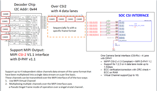

Hello TI,
May you provide a specific guideline for below?

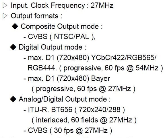

Our custom board (AM6254) CSI0 is connected to an external decoder (it also connects to main_i2c1 of the SOC), pin to pin as below picture.
The decoder outputs 4 streaming videos to AM6254.

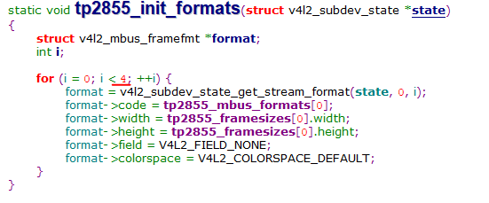

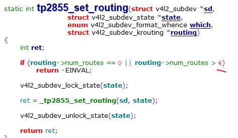

We want to create four video interface on AM6254, /dev/video0 ~video1~ video2 and ~ video3, to receive the stream videos.
Firstly, we want to know,
1) Is possible for SoC to receive separated 4 video streams?

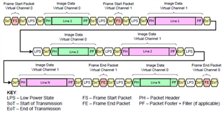

2) If the video streams are interleaved and combined a consequence stream and send to SoC, to receive the stream separated, do we need to implement any software part ?
If so, please guide. Thanks.
(Note, in our custom board, we could see the four video streams output signals properly from the decoder ( we checked at the output pin of the decoder chip).
Also the i2c between the decoder and SoC works fine)

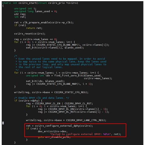

We try but failed; we could not see /dev/video after power on.

  • Hi Paul,
    No, this is not possible. You'll have to use a CSI aggregator such as the FPD-Link serdes. Please refer to this app note: Developing Multiple-Camera Applications on AM6x.

    The Decider Chip has CSI-2 V1.1 interface.
    Suppose we send the 4-camera streams over CSI-2, interleaved data transmission using virtual channels, we think it is possible?
    May you guide now ?
    < CSI2 Interface>
    < Interleaved data transmission using virtual channels>
  • Hi Paul,
    Yes, this should be possible. You can make the decoder chip operate as a single camera with 4 virtual channels. Please refer to the OV2312 sensor driver as an example. This driver has 2 virtual channels which is communicated to the V4L2 framework here: https://git.ti.com/cgit/ti-linux-kernel/ti-linux-kernel/tree/drivers/media/i2c/ov2312.c?h=ti-linux-6.6.y#n196
    If you implement the driver properly, the CSI-2 Rx driver on the SoC will create 4 video device nodes, each corresponding to a virtual channel.
    Jianzhong
  • hello Jianzhong
    Thank, we will try the driver out.
    May you provide a reference dts setting that is close to configuration? (we found a related dts setting  in k3-fpdlink-ov2312-0-X.dtso, but it is set with ds90ub960, look more complitcated).
  • Hi Paul,
    Your system is equivalent to a single camera with 4 virtual channels, instead of 4 cameras. So the dts should be simple. You can take a look at either of the following ones:
    Jianzhong

  • Hello Jianzhong,
    2 addtional source_stream were added for 4 caemras, as below.
    May you suggest more?
    FYI,
    Based on our camear input format/resolution (CVBS [NTSC  720*480 30fps]),
    we want to have the same output from decoder or INPUT to CSI2 RX AM62x.
    4-Camera (CVBS[NTSC  720*480 30fps]) -> Decoder Chip (NTSC  720*480 30fps)  via CSI2 4CH4LANE_297M ---> CSI RX AM62x
    Kernel log:
    kernel_log_added_4Virtual_20241213.txt
  • Hello Paul,
    You're getting close. Please follow this example to setup the routes: https://github.com/TexasInstruments/edgeai-gst-apps/blob/main/scripts/setup_camera_ox05b.sh.
    Another thing, your sensor format is set to SBGGI10_1X10 according to the log you shared, but your decoder chip seems having "NTSC  720*480". You'll need to make sure the formats of the sensor, "cdns_csi2rx.30101000.csi-bridge", and "30102000.ticsi2rx" in "media-ctl -p" all match.
    Jianzhong

  • Hello Paul,
    I assume you're using the following digital output mode:
    If that's the case, then you should use MEDIA_BUS_FMT_YUYV8_1X16.
    Which SDK version are you using? MEDIA_BUS_FMT_YUYV8_2X8 was only supported in SDKs before 9.0.
    Q1: When we changed the resolutions and format, only "- entity 13:" is changed, it is normal and correct?
    Yes for SDK 9.0 and later. In SDK 8.6, when you change the sensor format, the format of cdns_csi2rx will also be changed.
    You'll need to make sure all entities have the same format.
    Since YUV422, i have to change bpp value to 16 ?
    ALso csi2.dt value to 0x1e ?
    Yes, bpp should be 16. csi_dt should be MIPI_CSI2_DT_YUV422_8B, please refer to:
    Jianzhong
  • Hell Jianzhong,
    Thank for your feedback.
    We use SDK 9.0.
    Based on your latest comment, we are going to try as below; if something is wrong, please let us know. Thanks.
    /* Bus format */
    static const u32 tp2855_mbus_formats[] = {
    MEDIA_BUS_FMT_YUYV8_1X16,
    /* Camera resolution */
    #define TP2855_OUT_WIDTH 720
    #define TP2855_OUT_HEIGHT 480
    static const struct v4l2_area tp2855_framesizes[] = {
    .width = TP2855_OUT_WIDTH,
    .height = TP2855_OUT_HEIGHT,
    static void tp2855_init_formats(struct v4l2_subdev_state *state)
    struct v4l2_mbus_framefmt *format;
    int i;
    for (i = 0; i < 4; ++i) {
    format = v4l2_subdev_state_get_stream_format(state, 0, i);
    format->code = tp2855_mbus_formats[0];
    format->width = tp2855_framesizes[0].width;
    format->height = tp2855_framesizes[0].height;
    format->field = V4L2_FIELD_NONE;
    format->colorspace = V4L2_COLORSPACE_DEFAULT;
    /* Frame setting */
    #define MIPI_CSI2_DT_YUV422_8B             0x1e
    fd->type = V4L2_MBUS_FRAME_DESC_TYPE_CSI2;
    /* pixel stream - 2->4 virtual channels */
    bpp = 16;
    //bpp = 2;
    fd->entry[fd->num_entries].stream = i;
    fd->entry[fd->num_entries].flags = V4L2_MBUS_FRAME_DESC_FL_LEN_MAX;
    fd->entry[fd->num_entries].length = fmt->width * fmt->height * bpp / 8;
    fd->entry[fd->num_entries].pixelcode = fmt->code;
    fd->entry[fd->num_entries].bus.csi2.vc = i;
    fd->entry[fd->num_entries].bus.csi2.dt = MIPI_CSI2_DT_YUV422_8B; /* 0x1e */
    fd->num_entries++;
  • Hello Jianzhong,
    Please help to check and guide, below is current status:
    # yavta -c -Fcapture -s 720x480 -f UYVY /dev/video0
    691200 offset: 0 timestamp type/source: mono/EoF
    Buffer 0/0 ma[ 827.605880] cdns-csi2rx 30101000.csi-bridge: Failed to configure external DPHY: -2
    pped at address 0xffffb2497000.
    length: 691200 offset: 692224 timestamp type/source: mono/EoF
    Buffer 1/0 mapped at address 0xffffb23ee000.
    length: 691200 offset: 1384448 timestamp type/source: mono/EoF
    Buffer 2/0 mapped at address 0xffffb2345000.
    length: 691200 offset: 2076672 timestamp type/source: mono/EoF
    Buffer 3/0 mapped at address 0xffffb229c000.
    length: 691200 offset: 2768896 timestamp type/source: mono/EoF
    Buffer 4/0 mapped at address 0xffffb21f3000.
    length: 691200 offset: 3461120 timestamp type/source: mono/EoF
    Buffer 5/0 mapped at address 0xffffb214a000.
    length: 691200 offset: 4153344 timestamp type/source: mono/EoF
    Buffer 6/0 mapped at address 0xffffb20a1000.
    length: 691200 offset: 4845568 timestamp type/source: mono/EoF
    Buffer 7/0 mapped at address 0xffffb1ff8000.
    Unable to start streaming: No such file or directory (2).
    8 buffers released.
    Full log:
    log_20241224.txt

    root@am62xx-evm:/tmp# dmesg | grep csi
    [ 1.185689] i2c 1-0044: Fixed dependency cycle(s) with /bus@f0000/ticsi2rx@30102000/csi-bridge@30101000
    [ 1.527744] cdns-csi2rx 30101000.csi-bridge: Probed CSI2RX with 4/4 lanes, 4 streams, external D-PHY
    <<below log is shown after running " yavta -c -Fcapture -s 720x480 -f UYVY /dev/video0">>
    [ 872.675634] cdns-csi2rx 30101000.csi-bridge: Failed to configure external DPHY: -2
  • Hello Jianzhong

  • After tracing csi2rx, something wrong when csirx starts:
  • Hello Jianzhong
    Could you provide guideline how to resolve this issue? Thanks.
    root@am62xx-evm:/tmp# v4l2-ctl -d2 --stream-mmap
    [ 559.502639] tp2855 1-0044: tp2855 tp2855_get_frame_desc()
    [ 559.508234] tp2855 1-0044: tp2855 [0] flags = 0 , legnth = 0 , pixelcode = 0 , vc = 0 , dt = 0x00
    [ 559.517544] tp2855 1-0044: tp2855 [1] flags = 0 , legnth = 0 , pixelcode = 0 , vc = 0 , dt = 0x00
    [ 559.526825] tp2855 1-0044: tp2855 [2] flags = 0 , legnth = 0 , pixelcode = 0 , vc = 0 , dt = 0x00
    [ 559.536062] tp2855 1-0044: tp2855 [3] flags = 0 , legnth = 0 , pixelcode = 0 , vc = 0 , dt = 0x00
    [ 559.545557] cdns-csi2rx 30101000.csi-bridge: Failed to configure external DPHY: -2
    VIDIOC_STREAMON returned -1 (No such file or directory)

    I looked at your latest log. It seems now the error is:
    root@am62xx-evm:/tmp# v4l2-ctl -d0 --stream-mmap -v width=720,height=480,pixelformat=UYVY
    VIDIOC_STREAMON returned -1 (Broken pipe)
    Was the "Failed to configure external DPHY" error fixed?
    I didn't see anything wrong in your "media-ctl -p" output. Not sure where the problem could come from. Maybe you can add some debug prints in cdns-csi2rx.c and j721e-csi2rx.c to see where the streaming is stuck.

    Q:Was the "Failed to configure external DPHY" error fixed?
    Ans: Yes, after modifiyng  in j721e-csi2rc.c as below.
    You shouldn't need to change that function which is just setting the default format.

    My camera spec:
    720*480 YCbCr422 with BT656

    -  Failed to configure external DPHY: -2  <---exist

    Buff[  199.330801] cdns-csi2rx 30101000.csi-bridge: Failed to configure external DPHY: -2

    [  396.623399] cdns-csi2rx 30101000.csi-bridge: Failed to configure external DPHY: -2

  • Hello Jianzhong,
    We found the camera resolution is not fit with our camera spec.
    How to modify it? Could be the root cause of this issue?
    root@am62xx-evm:/tmp# v4l2-ctl --device /dev/video0 --list-formats-ext
    ioctl: VIDIOC_ENUM_FMT
    Type: Video Capture
    [0]: 'YUYV' (YUYV 4:2:2)
    Size: Stepwise 8x1 - 8192x16384 with step 8/1
    [1]: 'UYVY' (UYVY 4:2:2)
    [2]: 'YVYU' (YVYU 4:2:2)
    [3]: 'VYUY' (VYUY 4:2:2)
    [4]: 'BA81' (8-bit Bayer BGBG/GRGR)
    Size: Stepwise 16x1 - 16384x16384 with step 16/1
    [5]: 'GBRG' (8-bit Bayer GBGB/RGRG)
