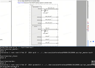

  • Hi Takuma,
    There is a strange phenomenon here. I hope you can help answer it.
    After I excute "spidev_test -v -D /dev/spidev0.0" on the console.From the data on the logic analyzer, I found that the data from SPI TX appears on MISO, which is not an expected phenomenon. I believe that the data from SOC SPI TX should be on MOSI.
    Can you help me check out where the problem is?
    Regrads.
  • Hi Xie,
    Is the spidev0.0 interface configured for slave mode in device tree? Data from MISO on SoC is expected when SoC is slave... although it would be an unexpected phenomenon if SoC is master.
    Takuma
  • Hi  Takuma,
    I think the spidev0.0 is in master mode.
    Can you check if my modifications are correct?

  • Hi Xie,
    I looked through the patch, and it looks to be fine.
    Could you try an experiment where you try to enable two SPI interfaces and do communications between the two? Loopback to itself is theoretically possible, but not something that is a practical usecase, so it is not something that is considered in design. The MOSI/MISO without an actual slave device could be what is causing the issue.
    Takuma

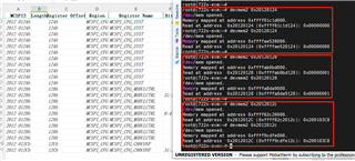

  • Hi Takuma,
    Thanks for support! customer have resolved this issue:
    spi*-omap2.c driver code have some register to setting the d0 and d1, customer try to set the d0 as input, and set the d1 as output can fix their issue.
    BR,
    Biao
