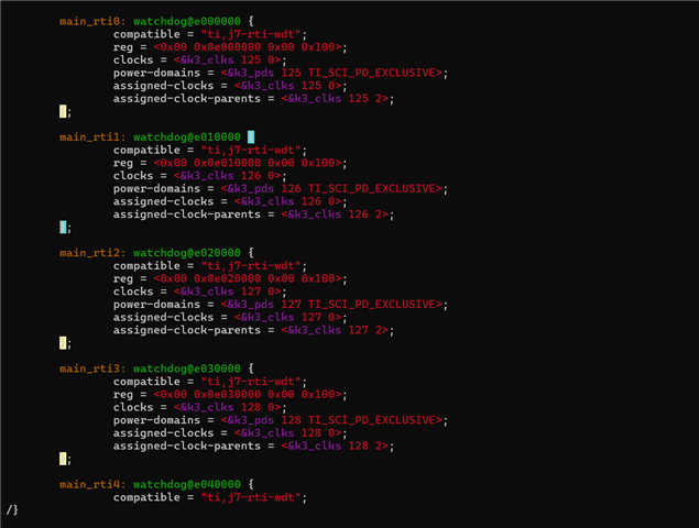

  • Hello Nick,
    We have verified the ESM node address in dtb and on target board. devicetree settings are successfully applied at boot time. Please check below details.

  • Hello Parikshit,
    Apologies for the delayed responses here.
    To confirm, is your screenshot on the left from inspecting the .dtb file? I would like you to actually go to
    /sys/firmware/devicetree/bus.../etc/etc/
    and manually verify the settings there.
    I have seen issues where a different .dtb file is loaded than people expect, so I want to verify the actual applied settings.
    Nick
  • Hello Nick,
    Thanks for the reply,
    We have checked at the path "/sys/firmware/devicetree/base/bus@f0000/" and confirmed that all watchdog nodes are present.
    Additionally, we have checked all parameters under each watchdog node, and their respective values:
    Moreover, we have converted .dtb present in our board to .dts using command:"dtc -I dtb -O dts <your DTB> -o <dts filename>".
    Attaching same for your reference
    0246.k3-am62a7-sk.zip
    Kindly check above details and let us know if any issue in shared details or something missing in dtb node.
    Please let us know if we need to check more details on board apart from this for the watchdog node. Please provide exact details in which path we need to validate settings for watchdog (for manual validation)
    We are waiting for your response on this.
    Parikshit

  • Hello Nick,
    We have verified that the changes have been successfully applied, as previously shared with you. here.
    Please refer to the attached image, which displays the node details from the updated .dtb file reflecting the ESM settings. These updates, based on the documentation available at https://software-dl.ti.com/processor-sdk-linux/esd/AM62AX/10_00_00/exports/docs/linux/Foundational_Components/Kernel/Kernel_Drivers/Watchdog.html#fixes-for-10-0-sdk
    If there are additional methods to verify whether the changes have been applied, we kindly request you to share them with us.
    Parikshit
