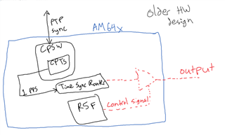

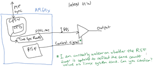

    The "newer" system
    This is my current understanding of the "newer" hardware system. Is it correct? Is there anything I got wrong, or any other information you want to give us?
    The "older" system
    Based on that understanding of the "newer" hardware, this is what I think you are trying to do with the "older" hardware. Is it correct? Is there any other information you want to give us?

  • Currently we have a Uart TX line which is switched between (E14)
    • UART1_TXD (for typical UART communication)
    • GPIO1_57 (for sending a falling edge to the device as synchronization)
    On the newer hardware, we route the PPS signal to that signal (as you also showed in your picture), but we are looking for a solution on existing boards. On the other PCBs we have in play, we need to achieve the same thing, but have different pins (different UART peripherals).
    We need to trigger ANY sort of falling edge, as long as it's time has low jitter and is source from a timer time sync router signal. As we (almost) do not care, when exactly that edge is, as long as we know the time. We do care strongly about a constistent, low jitter time here. So target is +/-10ns to +/-20ns. Right now the bus arbitration can take 200-300ns and shift the actual GPIO falling edge by that period.
    So our proposed method to possibly have reduced jitter by using the DMA:
    • We have some timer interrupt (does NOT have to be periodic, one-shot is enough. We can synchronize that timer internally to another one with a known absolute time)
    • The timer interrupt triggers a DMA transaction
    • The DMA writes to one of those:
      • GPIO_SET_DATAxx register to trigger the falling edge (32-bit register)
      • UART_THR register to send a value of 0x00 (32-bit register, only 8-bit relevant)
    Right now we would like to evaluate, if that would improve our time accuracy. But we can't just trigger the DMA by the R5 core directly, as we also would have a memory access from R5 core, which has the same bus arbitration problem.

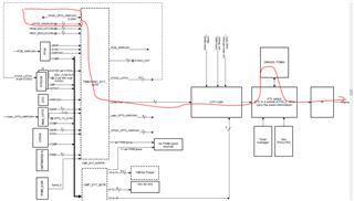

    Hello Wolfgang Pretl,
    As I mentioned in the call, the DMA is triggered through the Timer PWM and this can be writable on the GPIO Data register .
    But, in your case, you need to trigger DMA for one shot mode and this is not possible with the timer PWM .Since, the Timer PWM is needed Auto reload .
    And, I explained about the GPIO method, and we need to control GPIO from low to high or high to low to trigger DMA but again GPIO controlling is adding delay to trigger DMA.
    And, another method is that I highlighted some inputs from CPST and CPSW Hw push and we can also trigger DMA from these inputs.
    Other than these methods, we can't trigger DMA and one more thing is you need to trigger DMA for 32bit and again here DMA is needed for  minimum of 32 bytes is required to transfer data.
