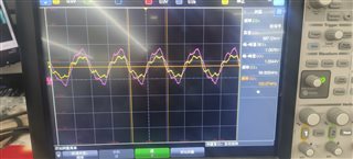

Dear expert:
My configuration is:
  •     Serdes0 lane0 & lane 1 :  PCIe 1 x2  for EP Xilinx FPGA, 8GT/s
  •     Serdes0 lane2 & lane 3 :  PCIe 3 x1: connects to Intel i226 which is fixed mounted on my TDA4VH board., 5GT/s
Problem:
  •   Boot up with i226 only, then hot plug in FPGA board, system crash most time, some times not crash, but can't detect FPGA EP, only i226 detected.  Observed register value varies when not crash
    • Keep FPGA connected: Register 0x02937014 is 0x0200 0009   Register 0x02917014 is 0x1000 0127
    • Remove FPGA::             Register 0x02937014 is 0x1000 0113   Register 0x02917014 is 0x0000 0024
  • Insert FPGA in advance with I226 together, can boot up successfully, but can only detect FPGA  8GT/s.
   its wired, can you help me  find what's the problem?
2024-11-06

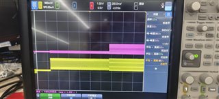

We made some progress  that seems  PCIE1 & PCIE 3  have to work as the same speed .  when set FPGA FP to 5GT/s(origin : 8GT/s )   TDA4VH can find two device. my case is 5GT/s
Can you help me with this?
2024-1227
I test more exanples.  When we set  FGPA to 2.5GT coonnecting to PCIE1 ,   i226 5GT/s  connecting to PCie3  , TDA4VH can also find two devices
