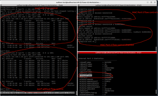

    Please find the below data where I have confirmed pause frame transmission from CPSW MAC Port to avoid packet drops.
    Below captures iperf when flow control enabled, and disabled case.
    Flow control is enabled/disabled by register write of PN_MAC_CTRL register.
    Note:
    In case of ETHFW to check flow control we need to disable "ETHFW_MONITOR_SUPPORT" as no from ETHFW build flags.
    Also, refer to CPSW statistics, when flow control is disabled observe top-of-fifo drop at MAC port and equivalent packet drop in other external port where data has to be forwarded.

    Above Iteration-5 is log with flow control enabled, 6 was with flow control disabled.
    As per above observation, flow control at CPSW external port is working as expected.
    Sudheer

    Do you confirm that the Jacinto core receiving the data (with IP address 192.168.1.100) is a R5F using LWIP as Ethernet stack under FreeRTOS?
    No, Please refer to below Diagram for my test environment.
    In no flow control case: there are rxBottomOfFifoDrop and rxTopOfFifoDrop. We suppose that statistic of iteration 6 contain statistics of iteration 5, as rxBottomOfFifoDrop value should come from the case with flow control
    Yes, Flow control will send pause frame when bottomOfFIFO case observed at MAC Port.
    Here, there are no tx drop at port-5.
    In no flow control case: you say” observe top-of-fifo drop at MAC port and equivalent packet drop in other external port where data has to be forwarded.” . Which counter do you refer to ?
    Port-3 side rxTopOfDrop.
    " rxTopOfFifoDrop         = 1596 "
    Port-5 side Tx Drop.
      txPriDrop[0]            = 1596
      txPriDropBcnt[0]        = 2422728
    In control flow enable case: In the iperf logs we see there are no retries, and in parallel, we see rxBottomOfFifoDrops, which means frames have been lost at port input .How is this possible (the TRM says: “This statistic should be zero if proper flow control is being followed”) ?
    No drops here, the scenario was created that bottomOfFIFO drop and MAC Port-3 is sending pause frames to TDA4VH in my above setup.
    You can observe the Tx pause frames "txPauseFrames           = 1544793  "
    So, after seeing Pause frames TDA4VH will control Tx traffic so ,there by no Drops.
    You said “Flow control is enabled/disabled by register write of PN_MAC_CTRL register”. We activated this register in our code (see https://e2e.ti.com/support/processors-group/processors/f/processors-forum/1382087/tda4vh-q1-adding-flow-control-inside-the-cpsw9g-switch-of-the-soc-jacinto/5374783#537478) and it didn’t work. Can you provide us the test code you used ?
    You can enable through register as well from ETHFW, If you have a doubt read register value and check whether flow control enabled or not?
    PN_MAC_CTRL register will holds the fields for Tx & Rx flow control enable. Please enable both.
    I have used TI SDK as is, just enabled CPSW statistics capture as communicated you earlier Also, I have disabled Monitor Task in ETHFW as it will perform CPSW recovery when bottomOfFIFO drop observed.

    . I think there was a misunderstanding because on our side we did the test like that :
    The objective is to be able to generate pause frames when blocking the R5F core using the host port. On our side we observed that the host port was still transmitting data even if we blocked R5F core. I think that, by using 2 external ports the port 0 was not used.
    If R5F is blocked, there won't be any traffic from R5F, if clients are enabled then client can send traffic to CPSW.
    I am not observed the pause frames w. r. to Host port let me check the same once.
    As we understood from the test you have performed, the pause frames don't come out of the destination port but from the external port that is forwarding data. In your test, port 3 is forwarding data and port 5 is receiving data. When flow control is activated, we can see Tx pause frames from port 3.
    This is totally fine for us that pause frames are sent back from external port and not from host port, and we see that port 3 sends back pause frames when trying to forward data to port 5 (external port). In our case, we want the same mechanism to work, but with port 3 connected to the host port. As we understood, if we replace port 5 with the host port, port 3 no longer sends pause frame.
    Additionally, we observed in the past that host port doesn't have drops, which means drops are not seen from the host port itself, and also from the external port trying to forward data.
