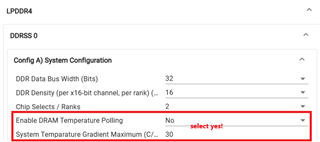

(2) Base on latest version DDR configure tools, we already support period DDR DQ bus training by different temperature, isn't?
(TDA4 period read MR4 command & adjust ZQ?)

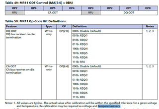

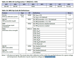

(3) I try to find some "clue" which related to LPDDR4 temperature vary. As far as I know, it related to MR3 & MR11. Do you have any suggestion to help us debug this issues (include HW/SW) ?

    DRAM temperature polling is not related to training - it is related to polling of MR4 (i.e, the refresh rate). Refresh rate is not a suspicion for systems only failing at cold temperature.
    Training is enabled automatically by the register configuration tool and is not configurable through the register tool. The latest sysconfig version of the tool supports the same training as was supported in version 0.10.0. Please see the snippet below which indicates which trainings are performed once during the LPDDR4 initialization, and which trainings occur periodically during runtime.

  • (1) Let's me double check one thing, both "LPDDR4 boot initialization training" and  "period training" already automatic support by "DDR sysconfig tools V0.10.0", Is it correct? Ask customer to use this version to generate LPDDR4 configure file.
    Yes, both the last XLS version (0.10.0) and the current latest SYSCONFIG version (0.11.0) support the same with respect to training. All trainings are enabled during boot time initialization, and write DQ training is enabled to occur periodically.
