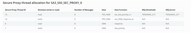

Hi TI,
I have a 2 questions related to the Secure Proxy configuration and HSM on the AM62A platform:
  1. In the Secure Proxy thread allocation table for SA3_SS0_SEC_PROXY_0, the thread IDs for TIFS_HSM and HSM are listed, but I could not find thread IDs for DM core, MCU core, or A core when communicating with the HSM core.
    At the same time, the hsm_ipc demo defines RX_THREAD_ID as 9 and TX_THREAD_ID as 8.
    Accessing sproxy registers with these macro definition results in hard abort. Are these IDs part of another mapping table that is not documented here? If so, could you clarify where I can find this allocation?
  2. In the table, TIFS_HSM is listed as a Host for both sec_low_priority_rx and sec_HSM_response_tx threads. Why are two TIFS_HSM cores acting as Hosts together?
Yang
    1. Those allocations are defined by the TIFS for the commnunication between the TIFS & other cores. For HSM to other cores communication, the HSM code itself defines the thread ids mapping.
    For AM62A, the mappings are defined in the file: hsm/src/drivers/sec_proxy/config/am62ax/sec_proxy_config_data.c
    For communication with WKUP R5F core, you would find the following mapping:
    • HSM -> WKUP R5F : TX ID 2 -> RX ID 9
    • WKUP R5F -> HSM : TX ID 8 -> RX ID 0
    That's how the {RX|TX}_THREAD_ID are defined in the HSM IPC example.
    2. The TIFS_HSM is just a virtual host id for a single TIFS core.
    Prashant
