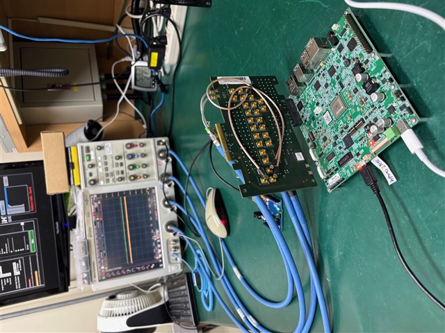

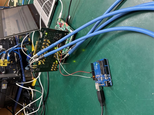

  • Takuma,
    I was in customer lab for PCIe compliance test which I sent the setup picture to you.
    There is a PCIe card (call test fixture) connect all the signals back to Oscilloscope.
    Oscilloscope will keep measure signal from test fixture. They took another system and power on the DUT and I saw waveform and test pattern on Oscilloscope.
    Connecting our device will show any output at beginning then we power up and run Linux and not get any output on Oscilloscope at all.
    I tried the CCS Binary from team via JTAG and it does run the test program run on R5 to place AM67x PCIe into PMA Isolation but still not seeing output on Oscilloscope.

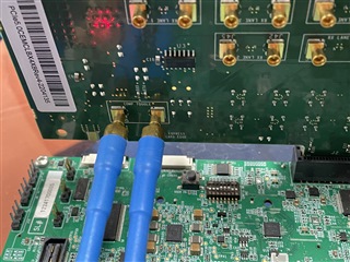

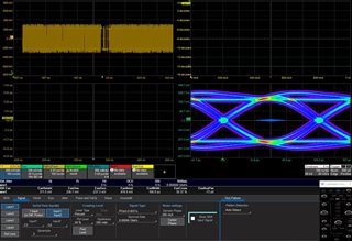

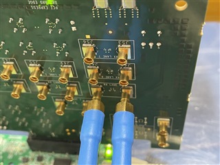

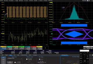

  • Hi Rich,
    Good news, but we are able to verify that we can enter compliance mode on TI EVM without BERT.
    Software used:
    Hardware used:
    • CLB (Compliance Load Board)
    • Teledyne LeCroy LabMaster 10 Zi-A Oscilloscope (high frequency oscilloscope)
    Procedure:
    1. Connect TX Lane 0 of CLB to oscilloscope like below
    2. Flash default Linux image onto SD card and boot. No extra patches or commands are needed. Just boot the default Linux. Logging in is optional.
    3. Done. There should be a signal observed on the oscilloscope

  • And as a sidenote, we have also tried switching between the different compliance modes. We were successfully able to switch between Gen1 speeds, Gen2 speeds, and Gen3 speeds.
    However, this requires an extra hardware configuration step which is to connect  COMP TOGGLE signal on the CLB to RX0 like below:
    And there is a switch on the CLB that can be pressed to toggle between different speeds.
    This is not required if just testing PCIe Gen1 speeds, and even without these connections there should be Gen1 speed signals coming out of the TX lines.
    Takuma
  • Thanks Takuma.
    The scope captures for PCIe compliance using the Linux SDK, J7AEN EVM, and the PCIe compliance load board are attached for Gen1, Gen2 and Gen3 .
    Gen1
    Gen2
    Gen3
