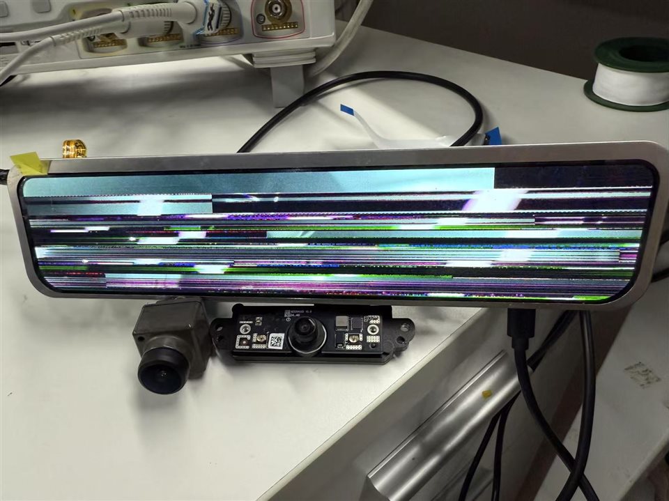

In the MIPI DPHY of the AM62A7, I am using a data receive rate of 1.5G, I observed an error in the received data, I suspect that the RX side is not entering the de-skewed state.
On the MIPI-RX side of the AM62A7 chip, how should I check if it is currently in the deskewed state?

    Sometimes my camera displays a scrambled screen, and ECC error detection fails.
    What suggestions do you have for solving this problem?

    It is possible deskew mode has not been entered correctly. Can you advise what the registers suggested by Sreenivasa read also? Is your camera sensor sending the initial deskew calibration sequence? Do the deskew calibration requirements of the TX side meet the minimum requirements of the RX side? Is it possible that the scrambled screen on the camera means a periodic deskew pattern also needs to be sent?

  • Hi,Kallikuppa
    After troubleshooting the problem, we found that it might be an issue with the MIPI bandwidth. The problem was resolved after we reduced the camera’s frame rate.
    Yuwei
