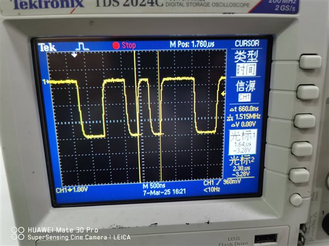

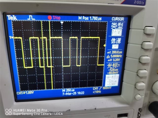

    As I explained above, we already know 4Mbps cannot be reached. What is "abnormal" with 2Mbps and 1.5Mbps, slow transfer or something else?
  • Hi Bin,
    Abnormal means slow transfer.
    But captured 4Mbps waveform from upper picture 2, and data is correct.

    Please see the baud rate table 12-113 in the TRM, the max baud is 3.6884Mbps with DLH/DLL are configured to 1 and using 13x baud multiple. There is impossible to configure to 4Mbps. You can see the failure in stty command when trying for 4Mbps:
    root@am62xx-evm:~# stty -F /dev/ttyS5 3000000
    [  836.673468] omap8250 2850000.serial: mdr1 mode 3, div 0x0181
    [  836.679525] omap8250 2850000.serial: mdr1 mode 0, div 0x0001
    root@am62xx-evm:~#
    root@am62xx-evm:~# stty -F /dev/ttyS5 4000000
    [  842.230615] omap8250 2850000.serial: mdr1 mode 0, div 0x0001
    [  842.236556] omap8250 2850000.serial: mdr1 mode 0, div 0x0001
    stty: /dev/ttyS5: unable to perform all requested operations
    and likely the UART module is in a wrong state after this point, then your 2Mbps and 1.5Mbps speed test failed? Please try 2M and 1.5M right after rebooted the board.
