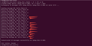

Now I am using rpmsg_char_simple to test the ipc communication between linux and mcu1_0, but in the actual test, I found that the communication between linux and mcu1_0 is abnormal:
Linxu side:
mcu1_0:

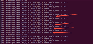

mcu1_0 always recv "hello there 0"
It seems that the data receiving buffer has a cache, but I don’t know why.

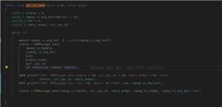

This is my ipc task:
How to solve this problem? Please help to check this.

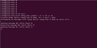

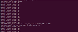

  • Add something:
    For the most part, linux sent the message, but mcu1_0 didn't seem to receive it.
    Linux:
    MCU1_0:
  • Now I am using rpmsg_char_simple to test the ipc communication between linux and mcu1_0, but in the actual test, I found that the communication between linux and mcu1_0 is abnormal:
    I saw your log here and it seems possible stack corruption .Please check increasing stack size or no need to use 512 bytes to store 'hello world" message use lesser space.
    It received one time but not able to further proceed,please connect CCS and see where it is going to .If you have more priority tasks then did the context switch happened ?
