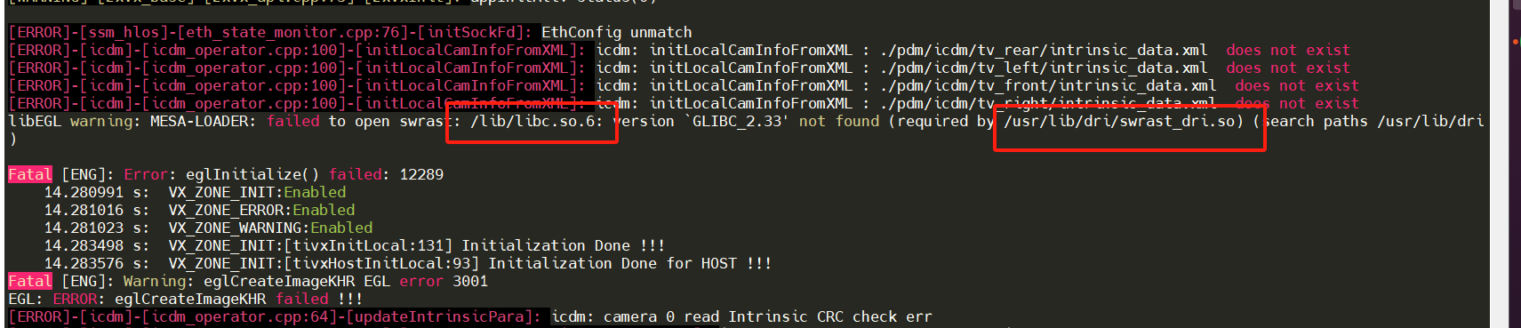

Our customer is using TDA4VE with SDK0806. But they run into GPU rendering issue occasionally as the below video show.
Below is the dmesg log.
https://e2e.ti.com/cfs-file/__key/communityserver-discussions-components-files/791/dmesg-log
Below is the GPU error log.
pvrlogdump_2305030052.txt
Could you please help to check the possible reason? Thank you

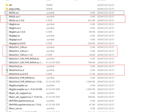

  • Hi Sarabesh,
    Our customer also try to update GPU driver referring to below link.
    https://e2e.ti.com/support/processors-group/processors/f/processors-forum/1316731/faq-tda4vl-q1-what-are-the-gpu-driver-bug-fixes-for-sdk-8-6-or-earlier
    However this issue still can be reproduced. Below is the updated log.
    pvrlogdump_2305030041.txt.gz

  • Hi, Jared
    thanks for your reply.
    we try to update KM and UM libs as your reply, but we have problems as belows:
    LoadLib: Couldn't load libpvr_dri_support.so: /lib/libc.so.6: version 'GLIBC 2.33' not found (required by /usr/lib/libpvr_dri_support.so)
    ibEGL warning:DRI2: failed to create dri screen
    seems it is GLIBC version issues
    currently we use SDK0806, can you build UM libs with SDK0806 compiler instead of SDK1001
    thanks
    henry

    I am attaching the built UM-libraries below:
    bxs-um-libs-8xSDK-port.zip
    Extract and copy binaries to SD-card file-system by:
    sudo cp -ar </sgx-um-libs/*> </SD card path>
    Sarabesh S.
  • Hi Sarabesh,
    thanks for your reply, I will try your libraries
    but in your attached patches seems missing libs as belows, is that ok?
  • Hi Mark,
    Keep in mind you need to also update the KM as well. The UM and KM need to be the same version. I will check internally about those libs.
    Sarabesh S.
  • Hi h:
                      SDK 0806, after updating KM and UM 1001 versions, it was found that the GPU failed to initialize correctly. After checking the log, it was found that the upper GPU library depended on the library /usr/lib/dri/swrast_dri.so, and this library depended on /lib/libc.so.6. We used the rootfs of the SDK 0806 version. After updating this library to the 1001 version, it was found that the system hung
                  The system hangs up and the picture is as follows
    It appears the 24.1 DDK doesn't necessarily need those "missing" libraries. We are able to verify GPU functionality with rgx_triangle_test, rgx_compute_test, and gmark2-es2-drm. However, when running applications that use weston (i.e glmark2-es2-wayland) I see it default to software rasterization and produce a similar error. To confirm the suspicion that weston compatibility is breaking, is your application using weston?
    Sarabesh S.
  • Hi,Sarabesh
    we did not use weston, we use surface less EglContext rendering,but in your delivered patch seems missing bunch of libraries,in other e2e gpu update tutorials,you attached all libs as belows:
    dri will be updated,right now, we just update the libs in your UM patch,dri was not updated.
    I think update all the related libs will fix this issue,  can you give UM libs patch as previous tutorials?
    henry

  • Hi Sarabesh :
                        I would like to ask, is this error caused by different compilers? If I use the 0806 compiler and compile libc.so.6, then it will be ok.
    libc.so is not a library that is provided by the UM build, libc.so is a binary that is provided as part of Yocto and should be present in your default SDK. Not sure how this could actually be missing. But yes, you will see errors if you are using different compilers to build your libraries. Also keep in mind, that software rasterization is a fallback solution to running your graphics usecase. This swrast_dri.so component is also built with Mesa, but I am prioritizing getting the EGL component built for hardware accelerated graphics.
    One thing I noticed is that when keeping the same libEGL.so* files from the default 8.06 SDK's UM libs I was able to run some hw accelerated test apps using EGL but it did fail when running applications using Weston.
    Thank you,
    Sarabesh S.
