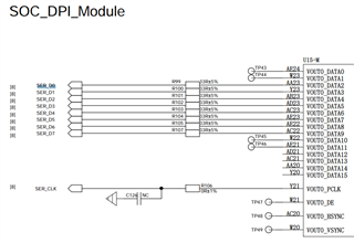

  • hardware design SOC is AM62P52 and used DPI pin is VOUT0_D2~D9 (AA23/Y23/AB23/AD23/AC23/AE23/AE22/AC22).
    I have 2 questions that need your confirmation:
    1.     Should I use DSS0 or DSS1 in the DTS file?

    You can use either DSS0 or DSS1 to get DPI output. Our recommendation would be to use DSS0 since we already have a DTS entry for DPI using DSS0.

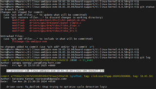

    I have another question that requires your assistance in solving. How can I input YUV data into DSS? Can you provide me with an example?
    our EVM do not support BT656 and we don't have any SW drivers or documents that show how to enable BT656.
    As mentioned earlier, we currently do not have software support for YUV data format.

  • Hi
       I used the SDK version is : 10.01.10.04;  linux kerner version: ti-linux-kernel-6.6.58+git-ti.
       1. I only change the source code for ddr parameters for our hw.
       2. I have merge the bt656 patch and see file:     bt656_patch-20250428.tar.gz
      but the kmsprint is not have panel parameters:
  • Hi Yong Zhang :
      I merge bt656 to the ti-processor-sdk-linux-am62xx-evm-10.01.10.04-Linux-x86-Install.bin for the evm board(SK-AM62P-LP).
      I only modify the kernel(ti-linux-kernel-6.6.58+git-ti) source code:
       and the modify source code see : bt656_patch-20250429.tar.gz
       but the EVM board powerup, i  see kmsprint error :(As shown in the following )
         and Please refer to the attachment for the complete startup log in bt656_patch-20250429.tar.gz.
         Please confirm again whether the patch is complete and correct !!!
    I see that you posted 2 results, in the first kmsprint didn't throw an error, while in second it does.
    What were your changes between the 2 versions? Please provide a git diff.
    I see that you have not applied the patches exactly!!
    For example, for the patches given in 0003-HACK-drm-tidss-Add-bt656-progressive-mode-support.patch,
    Your tidss_disp.c file shows the following in dispc_vp_enable() function:
    vfp = mode->vsync_start - mode->vdisplay;
    	vsw = mode->vsync_end - mode->vsync_start;
    	vbp = mode->vtotal - mode->vsync_end;
    	dispc_vp_write(dispc, hw_videoport, DISPC_VP_TIMING_H,
    		       FLD_VAL(hsw - 1, 7, 0) |
    		       FLD_VAL(hfp - 1, 19, 8) |
    		       FLD_VAL(hbp - 1, 31, 20));

    while, the patch mentions:
    @@ -1350,15 +1351,29 @@ void dispc_vp_enable(struct dispc_device *dispc, u32 hw_videoport,
    -	dispc_vp_write(dispc, hw_videoport, DISPC_VP_TIMING_H,
    -		       FLD_VAL(hsw - 1, 7, 0) |
    -		       FLD_VAL(hfp - 1, 19, 8) |
    -		       FLD_VAL(hbp - 1, 31, 20));
    +	if (dispc->tidss->bt656_enabled) {
    +		dispc_vp_write(dispc, hw_videoport, DISPC_VP_TIMING_H,
    +				FLD_VAL(((hsw & 0xFF) - 1), 7, 0) |
    +				FLD_VAL(hfp - 1, 19, 8) |
    +				FLD_VAL(hbp - 1, 31, 20));
    +	} else {
    +				FLD_VAL(hsw - 1, 7, 0) |
    -	dispc_vp_write(dispc, hw_videoport, DISPC_VP_TIMING_V,
    -		       FLD_VAL(vsw - 1, 7, 0) |
    -		       FLD_VAL(vfp, 19, 8) |
    -		       FLD_VAL(vbp, 31, 20));
    +		dispc_vp_write(dispc, hw_videoport, DISPC_VP_TIMING_V,
    +				FLD_VAL(((hsw) >> 8), 3, 0) |
    +				FLD_VAL(vfp, 19, 8) |
    +				FLD_VAL(vbp, 31, 20));
    +	} else {
    +				FLD_VAL(vsw - 1, 7, 0) |
     	ivs = !!(mode->flags & DRM_MODE_FLAG_NVSYNC);
    Seems, line additions were taken care of, but line subtractions weren't. This was found in some other places too.
    Please apply the patches exactly. The patch has been tested to yield kmprint output correctly on our end.
    For further replies, please use git diff {file} > {name}.patch and then share these patch files.
  • Hi
       I'm sorry, i check the source code, and do git format-patch (0001-merge-ti-bt656-patch.patch) .
       but the kmsprint error info is the same(0001-merge-ti-bt656-patch.log).
       0001-merge-ti-bt656-patch.tar.gz
  • Hi
      I use git am merge patch, 0001 and 0002 is success, but 0003 is error.
      do you have this error?
  • Hi :
       The kmsprint info is ok. thanks.
