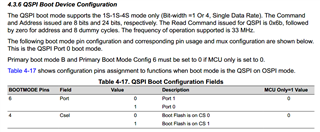

We are searching for informations about the QSPI bootmode configuration in The TDA4VH Technical Reference Manual (TRM).
In the Section 4.3.6, before Table 4-17,  There is a sentence that says :
"Primary boot mode B and Primary Boot Mode Config 6 must be set to 0 if MCU only is set to 0."
--> In our case, we need boot in QSPI on port 0, in MCU_Only =0. this seems to be forbidden by this sentence, is there any error ? because, booting in MCU_Only=0 seems the only solution to boot on QSPI0.
--> Also, there is no indication about the value of the Botmode_7 pin ? is it Don't Care ? or it must be tied to a specific level in our configuration ?
