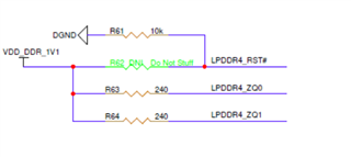

we use Micron: MT53E2G32D4DE-046 AAT:C, as you can see Rank1 ODT_CA connected to VSS, which means no address lines termination?

See our schematic:

  • Max,
    No, Rank 1 ODT_CA connected to VSS does NOT imply no address line termination. Please refer to section "ODT Mode Register and ODT State Table" on page 272 of the corresponding datasheet (rev G  sept. 2024), which states:
    "The CA ODT of the device is designed to enable one rank to terminate the entire command bus in a multirank system, so only one termination load will be present even if multiple devices are sharing the command signals."
    Q1:   why we have to set CA ODT not same as SOC ODT ?
    SOC ODT is controlling the ODT on TDA4 for the DQ/DQS IO during READs (inputs to TDA4)
    CA ODT is controlling the ODT on the LPDDR4 for the CA/CS/CLK IO.
    Note that we provide customers the option to modify IO parameters through our register configuration tool and we do not force you to set them any particular way.
    You may benefit from reading the following E2E thread which discusses CA ODT: https://e2e.ti.com/support/processors-group/processors/f/processors-forum/1466721/tda4vm-q1-tda4vm-lpddr4-sysconfig-and-impedance-matching-issues/
