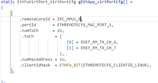

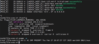

Dear TI's experts,
SDK Version:10.01
We are currently working on upgrading from sdk8.4 to sdk10.1, but we have found that the modifications made to cpsw9g on sdk8.4 are not working properly on sdk10.1. Can you help me confirm if there are any omissions or inaccuracies in my modifications?
Regards.

  • Hi Sudheer,
    You need to have MCU2_0 configuration under "gEthApp_virtPortCfg" for self core resource allocation.
    As you said, I did find the following key configurations in "gEthApp_virtPortCfg", such as "numTxCh", "numRxCh", or others. but I don't know yet how to configure these parameters on MCU20.
    Can you please provide detailed information on the modifications that need to be made to main. c? This matter is quite urgent, and we hope to resolve it as soon as possible.
    Regards.
    Can you please check with above, it should resolve ETHFW server Rx Flows allocation and Tx channels allocation.
    If you are not using gPTP, please disable the ETHFW_GPTP_SUPPORT, if not you need to have MAC Ports list in gEthAppSwitchPorts as in gEthAppPorts only not other ports.
    Sudheer
  • Hi Sudheer,
    Currently, we do not need to use GPTP, we only need to implement data send and receive normally within the local area network.
    Regards.
  • Hi.
    Okay, if then you can disable ETHFW_GPTP_SUPPORT
    Above change should help you to move forward.
    Sudheer
  • Hi Sudheer,
    I'm not sure what other modifications I can make besides disable ETHFW_GPTP_SUPPORT?
    Regards.

    diff --git a/psdkra/vision_apps/utils/ethfw/src/app_ethfw_freertos.c b/psdkra/vision_apps/utils/ethfw/src/app_ethfw_freertos.c
    index 063774c59..210e25868 100644
    --- a/psdkra/vision_apps/utils/ethfw/src/app_ethfw_freertos.c
    +++ b/psdkra/vision_apps/utils/ethfw/src/app_ethfw_freertos.c
    @@ -166,9 +166,6 @@ static Enet_MacPort gEthAppPorts[] =
         /* On J721E EVM to use all 8 ports simultaneously, we use below configuration
            RGMII Ports - 1,3,4,8. QSGMII ports - 2,5,6,7 */
         ENET_MAC_PORT_1, /* RGMII */
    -    ENET_MAC_PORT_3, /* RGMII */
    -    ENET_MAC_PORT_4, /* RGMII */
    -    ENET_MAC_PORT_8, /* RGMII */
     #if defined(ENABLE_QSGMII_PORTS)
         ENET_MAC_PORT_2, /* QSGMII main */
         ENET_MAC_PORT_5, /* QSGMII sub */
    @@ -210,104 +207,8 @@ static CpswAle_SetPolicerEntryInPartitionInArgs gEthApp_customPolicers[ETHFW_UTI
     static EthFwVirtPort_VirtPortCfg gEthApp_virtPortCfg[] =
    -        .remoteCoreId  = IPC_MPU1_0,
    -        .portId        = ETHREMOTECFG_SWITCH_PORT_0,
    -#if defined(ETHFW_EST_DEMO_SUPPORT) || defined(ETHFW_DEMO_SUPPORT)
    -        .numTxCh       = 1U,
    -        .txCh          = {
    -                            [0] = ENET_RM_TX_CH_4
    -#else
    -         .numTxCh      = 2U,
    -         .txCh         = {
    -                            [0] = ENET_RM_TX_CH_4,
    -                            [1] = ENET_RM_TX_CH_7
    -#endif
    -        /* Number of rx flow for this virtual port */
    -        .numRxFlow     = 1U,
    -        /* To create custom policers on rx flows clients need to give flow information (i.e. numCustomPolicers and customPolicersInArgs)
    -         * for each allocated flow.
    -         * Map the customPolicersInArgs with global custom policer's (i.e. gEthApp_customPolicers) array.
    -         * For example if numRxFlow is 1 and we want to create 1 custom policer to match with 2'nd custom policer in global array do this:
    -         * .rxFlowsInfo = {
    -         *                  [0] = {
    -         *                           .numCustomPolicers    = 1U,
    -         *                           .customPolicersInArgs = {
    -         *                                                       [0] = &gEthApp_customPolicers[2U],
    -         * It is important to note that number of custom policers per rx flow is <= ETHREMOTECFG_POLICER_PERFLOW */
    -        .numMacAddress = 1U,
    -        .clientIdMask  = ETHFW_BIT(ETHREMOTECFG_CLIENTID_LINUX) | ETHFW_BIT(ETHREMOTECFG_CLIENTID_QNX),
    -        .remoteCoreId  = IPC_MCU1_0,
    -        .portId        = ETHREMOTECFG_SWITCH_PORT_2,
    -        .numTxCh       = 1U,
    -        .txCh          = {
    -                            [0] = ENET_RM_TX_CH_5,
    -        .numRxFlow     = 1U,
    -        .clientIdMask  = ETHFW_BIT(ETHREMOTECFG_CLIENTID_AUTOSAR),
    -        /* Virtual switch port for Ethfw, using ETHREMOTECFG_SWITCH_PORT_LAST */
    -        .remoteCoreId  = IPC_MCU2_0,
    -        .portId        = ETHREMOTECFG_SWITCH_PORT_LAST,
    -        .numTxCh       = 3U,
    -        .txCh          = {
    -                            [0] = ENET_RM_TX_CH_0,
    -                            [1] = ENET_RM_TX_CH_7,
    -                            [2] = ENET_RM_TX_CH_6
    -#else
    -        .numTxCh       = 2U,
    -        .txCh          = {
    -                            [1] = ENET_RM_TX_CH_6
    -#endif
    -        .numRxFlow     = 5U,
    -        .clientIdMask  = ETHFW_BIT(ETHREMOTECFG_CLIENTID_NONE),
    -        /* SWITCH_PORT_1 is used for both RTOS and Autosar client */
    -        .remoteCoreId  = IPC_MCU2_1,
    -        .portId        = ETHREMOTECFG_SWITCH_PORT_1,
    -        .numTxCh       = 1U,
    -        .txCh          = {
    -                            [0] = ENET_RM_TX_CH_1
    -        .numRxFlow     = 1U,
    -        .clientIdMask  = ETHFW_BIT(ETHREMOTECFG_CLIENTID_AUTOSAR) | ETHFW_BIT(ETHREMOTECFG_CLIENTID_RTOS),
    -        .portId        = ETHREMOTECFG_MAC_PORT_1,
    -        .numTxCh       = 1U,
    -        .txCh          = {
    -                            [0] = ENET_RM_TX_CH_3
    -        .numRxFlow     = 1U,
    -        .portId        = ETHREMOTECFG_MAC_PORT_4,
    -        .numTxCh       = 1U,
    -        .txCh          = {
    -                            [0] = ENET_RM_TX_CH_2
    -        .numRxFlow     = 1U,
    -        .clientIdMask  = ETHFW_BIT(ETHREMOTECFG_CLIENTID_RTOS),
    +        .remoteCoreId = IPC_MPU1_0,
    +		.portId       = ETHREMOTECFG_MAC_PORT_1,

  • HI,
    Is above resolved your issue?
    Sudheer
  • Hi Sudheer,
    After making the following modifications under "gEthApp_virtPortCfg"  on MCU20, there is currently no problem with TXRX channel allocation.
    But there are still some other issues, can you help me see what modifications can be made?

  • Hi Sudheer,
    If you are using Fixed Link, please update link speed in board_j721e_evm.c file under MAC Port configuration instead of AUTO Speed and Duplex
    Thank you for your suggestion. I set the Speed and Duplex values to fixed values instead of auto.There are currently no abnormal log prints.
    But why didn't I see any network cards like 'eth1' when I executed ifconfig?
    If you want ETHFW client on Linux side, need to enable remote cores under "gEthApp_virtPortCfg".
    Enable remote core ID: IPC_MPU1_0 for ETHFW clients on Linux.
    Sudheer
  • Hi Sudheer,
    Can you help provide me with a configuration about IPC_MPU1_0? Because there is an error in TX Rx channel allocation in the configuration of IPC_MPU1-0 that I am currently using, I don't know where the problem is.
    Regards.
    You can enable, default MCU2_0, MPU1_0 configuration under "gEthApp_virtPortCfg".
    Also, make sure Linux SDK also 10.1.
    Sudheer
  • Hi Sudheer,
    Use the default configuration for IPC_MPU1-0 and IPC_MCU2-0 as follows,  I still don't have a network card on Linux.
    Of course,the Linux SDK is 10.1.
