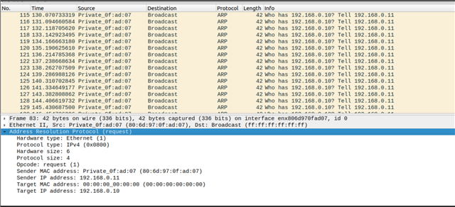

Hi ,
The thread we used to dicuss on the broadcom phy was locked, that's why I have created a new thread here to continue the discussion.
Previous thread: https://e2e.ti.com/support/processors-group/processors/f/processors-forum/1446512/processor-sdk-j784s4-not-able-to-get-dynamic-ip-when-dhcp-is-enabled/5628789#5628789
Actually, we parked the work on establishing communication in BCM54810 phy  with Broadreach enabled in 10Mbps. Now we are having the same BCM54810 phy with IEEE mode and with RJ45 port itself.
Now we are able to communicate in 100Mbps speed.

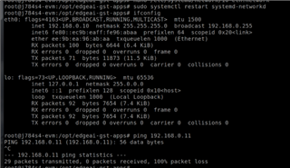

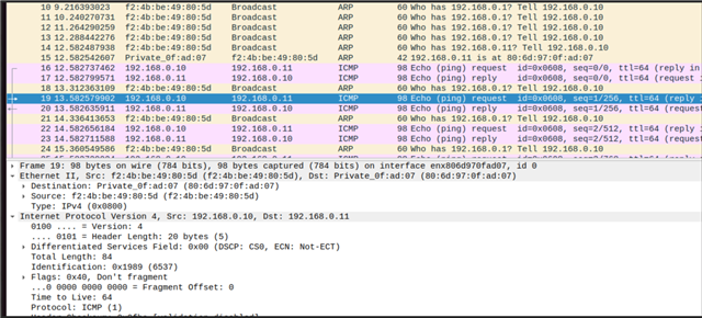

Setup: Connected this RJ45 cable to our PC and did ping test.
Now we set the phy mode to rgmii-id.

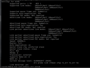

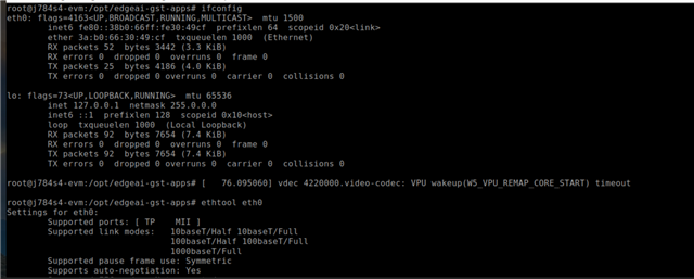

But we need to establish communication in 1000Mbps speed. I have tried with the same setup with autonegotiation enabled. But the ping test is not working in 1000Mbps speed.
There is no tx_carrier_sense error at all. Is there any specific configuration is need to communicate in 1000Mbps speed.
phytool read eth0/0x00/0x00
0x1140

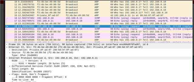

    From statistics I could see data transfer is success, is these are for 100Mbps? of 1000Mbps?
    If above are 100Mbps, please share the same for 1000Mbps?
    Also, take care of RGMII delay configuration for 100Mbps it will not matter but for 1000Mbps communication it need to be proper as clock is running at higher speed.

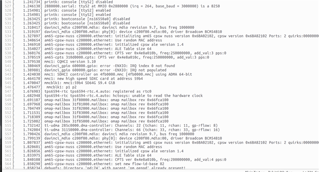

    Can you also share the Linux terminal log.

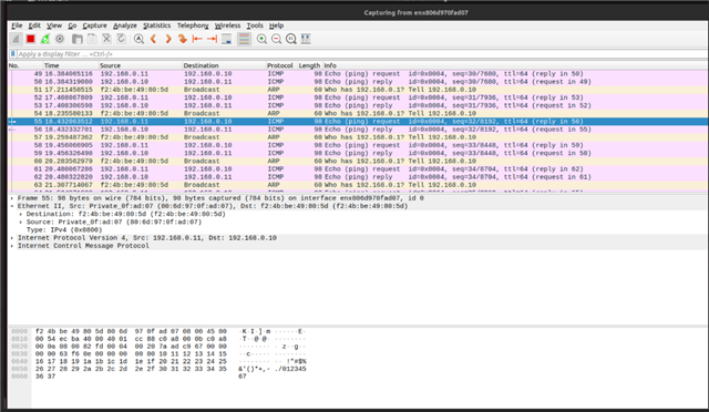

  • If above are 100Mbps, please share the same for 1000Mbps?
    Hi ,
    Thanks for the prompt response.
    Before ping:

    root@j784s4-evm:/opt/edgeai-gst-apps#
    After Ping:
    root@j784s4-evm:/opt/edgeai-gst-apps# ping 192.168.0.11
    PING 192.168.0.11 (192.168.0.11): 56 data bytes
    ^C
    --- 192.168.0.11 ping statistics ---
    7 packets transmitted, 0 packets received, 100% packet loss
    root@j784s4-evm:/opt/edgeai-gst-apps# ethtool -S eth0
    root@j784s4-evm:/opt/edgeai-gst-apps# ifconfig
    eth0: flags=4163<UP,BROADCAST,RUNNING,MULTICAST>  mtu 1500
            inet 192.168.0.10  netmask 255.255.255.0  broadcast 192.168.0.255
            inet6 fe80::e0ed:98ff:fe06:64ed  prefixlen 64  scopeid 0x20<link>
            ether e2:ed:98:06:64:ed  txqueuelen 1000  (Ethernet)
            RX packets 87  bytes 5408 (5.2 KiB)
            RX errors 0  dropped 0  overruns 0  frame 0
            TX packets 43  bytes 6803 (6.6 KiB)
            TX errors 0  dropped 0 overruns 0  carrier 0  collisions 0
    lo: flags=73<UP,LOOPBACK,RUNNING>  mtu 65536
            inet 127.0.0.1  netmask 255.0.0.0
            inet6 ::1  prefixlen 128  scopeid 0x10<host>
            loop  txqueuelen 1000  (Local Loopback)
            RX packets 92  bytes 7654 (7.4 KiB)
            TX packets 92  bytes 7654 (7.4 KiB)
    root@j784s4-evm:/opt/edgeai-gst-apps# ethtool eth0
    Settings for eth0:
      Supported ports: [ TP   MII ]
      Supported link modes:   10baseT/Half 10baseT/Full
                              100baseT/Half 100baseT/Full
                              1000baseT/Full
      Supported pause frame use: Symmetric
      Supports auto-negotiation: Yes
      Supported FEC modes: Not reported
      Advertised link modes:  10baseT/Half 10baseT/Full
                              1000baseT/Full
      Advertised pause frame use: Symmetric
      Advertised auto-negotiation: Yes
      Advertised FEC modes: Not reported
      Speed: 1000Mb/s
      Duplex: Full
      Auto-negotiation: off
      master-slave cfg: preferred slave
      master-slave status: slave
      Port: Twisted Pair
      PHYAD: 0
      Transceiver: external
      MDI-X: off (forced)
      Supports Wake-on: d
      Wake-on: d
            Current message level: 0x000020f7 (8439)
                                   drv probe link ifdown ifup rx_err tx_err hw
      Link detected: yes

    From the statistics before and ping, I could see CPSW MAC Port is receiving the packets but, all are broadcast messages.
       rx_good_frames: 110
       rx_broadcast_frames: 98
       rx_multicast_frames: 12
    The same received packets sent to eth0 as well.
    Also, I could observe the messages submitted to CPSW Driver all are Broadcast & Multicast not unicast packets for ping.
    Please run tcpdump on Linux terminal and capture the data some .pcap file and also capture wireshark data on peer side and check what is sent and what is received.
    Sudheer
  • Hi ,
    Thanks for the response.
       rx_good_frames: 110
    But in working 100Mbps broadcom phy also there is no unicast packets details and all.
    I will brief here the testing I have done with 100Mbps and 1000Mbps speed.
    BCM54810 - 100Mbps Testing:(Working)
    ethtool eth0
    Settings for eth0:
                                1000baseT/Full
                                1000baseT/Full
        Speed: 100Mb/s
        Duplex: Full
        Port: Twisted Pair
        PHYAD: 0
        MDI-X: off (forced)
        Supports Wake-on: d
        Wake-on: d
        Link detected: yes

    Ping from PC to board
     tcpdump -i eth0
    [  675.131599] device eth0 entered promiscuous mode
    [  675.136274] kauditd_printk_skb: 16 callbacks suppressed
    [  675.136281] audit: type=1700 audit(1651168417.760:35): dev=eth0 prom=256 old_prom=0 auid=4294967295 uid=0 gid=0 ses=4294967295
    [  675.152891] audit: type=1300 audit(1651168417.760:35): arch=c00000b7 syscall=208 success=yes exit=0 a0=4 a1=107 a2=1 a3=ffffeec2a1c0 items=0 ppid=940 pid=1550 auid=4294967295 uid=0 gid=0 euid=0 suid=0 fsuid=0 egid=0 sgid=0 fsgid=0 tty=ttyS2 ses=4294967295 comm="tcpdump" exe="/usr/bin/tcpdump" key=(null)
    [  675.179694] audit: type=1327 audit(1651168417.760:35): proctitle=74637064756D70002D690065746830
    tcpdump: verbose output suppressed, use -v[v]... for full protocol decode
    listening on eth0, link-type EN10MB (Ethernet), snapshot length 262144 bytes
    17:53:38.052613 ARP, Request who-has _gateway tell j784s4-evm, length 28
    17:53:38.250250 IP 192.168.0.11 > j784s4-evm: ICMP echo request, id 4, seq 10, length 64
    17:53:38.250300 IP j784s4-evm > 192.168.0.11: ICMP echo reply, id 4, seq 10, length 64
    17:53:39.076719 ARP, Request who-has _gateway tell j784s4-evm, length 28
    17:53:39.274209 IP 192.168.0.11 > j784s4-evm: ICMP echo request, id 4, seq 11, length 64
    17:53:39.274225 IP j784s4-evm > 192.168.0.11: ICMP echo reply, id 4, seq 11, length 64
    17:53:40.100596 ARP, Request who-has _gateway tell j784s4-evm, length 28
    17:53:40.298160 IP 192.168.0.11 > j784s4-evm: ICMP echo request, id 4, seq 12, length 64
    17:53:40.298172 IP j784s4-evm > 192.168.0.11: ICMP echo reply, id 4, seq 12, length 64
    17:53:41.124595 ARP, Request who-has _gateway tell j784s4-evm, length 28
    17:53:41.322118 IP 192.168.0.11 > j784s4-evm: ICMP echo request, id 4, seq 13, length 64
    17:53:41.322133 IP j784s4-evm > 192.168.0.11: ICMP echo reply, id 4, seq 13, length 64
    17:53:42.148702 ARP, Request who-has _gateway tell j784s4-evm, length 28
    17:53:48.489900 IP 192.168.0.11 > j784s4-evm: ICMP echo request, id 4, seq 20, length 64
    17:53:48.489917 IP j784s4-evm > 192.168.0.11: ICMP echo reply, id 4, seq 20, length 64
    17:53:49.316595 ARP, Request who-has _gateway tell j784s4-evm, length 28
    17:53:49.513875 IP 192.168.0.11 > j784s4-evm: ICMP echo request, id 4, seq 21, length 64
    17:53:49.513886 IP j784s4-evm > 192.168.0.11: ICMP echo reply, id 4, seq 21, length 64
    17:53:50.340595 ARP, Request who-has _gateway tell j784s4-evm, length 28
    17:53:50.537803 IP 192.168.0.11 > j784s4-evm: ICMP echo request, id 4, seq 22, length 64
    17:53:50.537814 IP j784s4-evm > 192.168.0.11: ICMP echo reply, id 4, seq 22, length 64
    17:53:51.364722 ARP, Request who-has _gateway tell j784s4-evm, length 28
    17:53:51.561769 IP 192.168.0.11 > j784s4-evm: ICMP echo request, id 4, seq 23, length 64
    17:53:51.561779 IP j784s4-evm > 192.168.0.11: ICMP echo reply, id 4, seq 23, length 64
    17:53:52.388594 ARP, Request who-has _gateway tell j784s4-evm, length 28
    17:53:52.585727 IP 192.168.0.11 > j784s4-evm: ICMP echo request, id 4, seq 24, length 64
    17:53:52.585737 IP j784s4-evm > 192.168.0.11: ICMP echo reply, id 4, seq 24, length 64
    17:53:53.412596 ARP, Request who-has _gateway tell j784s4-evm, length 28
    17:53:53.609703 IP 192.168.0.11 > j784s4-evm: ICMP echo request, id 4, seq 25, length 64
    17:53:53.609723 IP j784s4-evm > 192.168.0.11: ICMP echo reply, id 4, seq 25, length 64
    17:53:54.436692 ARP, Request who-has _gateway tell j784s4-evm, length 28
    17:53:54.633682 IP 192.168.0.11 > j784s4-evm: ICMP echo request, id 4, seq 26, length 64
    17:53:54.633691 IP j784s4-evm > 192.168.0.11: ICMP echo reply, id 4, seq 26, length 64
    17:53:55.460592 ARP, Request who-has _gateway tell j784s4-evm, length 28
    17:53:55.657630 IP 192.168.0.11 > j784s4-evm: ICMP echo request, id 4, seq 27, length 64
    17:53:55.657640 IP j784s4-evm > 192.168.0.11: ICMP echo reply, id 4, seq 27, length 64
    17:53:56.484592 ARP, Request who-has _gateway tell j784s4-evm, length 28
    17:53:56.681589 IP 192.168.0.11 > j784s4-evm: ICMP echo request, id 4, seq 28, length 64
    17:53:56.681599 IP j784s4-evm > 192.168.0.11: ICMP echo reply, id 4, seq 28, length 64
    17:53:57.508683 ARP, Request who-has _gateway tell j784s4-evm, length 28
    17:53:57.705558 IP 192.168.0.11 > j784s4-evm: ICMP echo request, id 4, seq 29, length 64
    17:53:57.705570 IP j784s4-evm > 192.168.0.11: ICMP echo reply, id 4, seq 29, length 64
    17:53:58.532594 ARP, Request who-has _gateway tell j784s4-evm, length 28
    17:53:58.729520 IP 192.168.0.11 > j784s4-evm: ICMP echo request, id 4, seq 30, length 64
    17:53:58.729530 IP j784s4-evm > 192.168.0.11: ICMP echo reply, id 4, seq 30, length 64
    17:53:59.556595 ARP, Request who-has _gateway tell j784s4-evm, length 28
    17:53:59.753488 IP 192.168.0.11 > j784s4-evm: ICMP echo request, id 4, seq 31, length 64
    17:53:59.753499 IP j784s4-evm > 192.168.0.11: ICMP echo reply, id 4, seq 31, length 64
    17:54:00.580687 ARP, Request who-has _gateway tell j784s4-evm, length 28
    17:54:00.777449 IP 192.168.0.11 > j784s4-evm: ICMP echo request, id 4, seq 32, length 64
    17:54:00.777465 IP j784s4-evm > 192.168.0.11: ICMP echo reply, id 4, seq 32, length 64
    17:54:01.604596 ARP, Request who-has _gateway tell j784s4-evm, length 28
    17:54:01.801423 IP 192.168.0.11 > j784s4-evm: ICMP echo request, id 4, seq 33, length 64
    17:54:01.801444 IP j784s4-evm > 192.168.0.11: ICMP echo reply, id 4, seq 33, length 64
    17:54:02.628593 ARP, Request who-has _gateway tell j784s4-evm, length 28
    17:54:02.825385 IP 192.168.0.11 > j784s4-evm: ICMP echo request, id 4, seq 34, length 64
    17:54:02.825398 IP j784s4-evm > 192.168.0.11: ICMP echo reply, id 4, seq 34, length 64
    17:54:03.652730 ARP, Request who-has _gateway tell j784s4-evm, length 28
    17:54:03.849354 IP 192.168.0.11 > j784s4-evm: ICMP echo request, id 4, seq 35, length 64
    17:54:03.849369 IP j784s4-evm > 192.168.0.11: ICMP echo reply, id 4, seq 35, length 64
    17:54:04.676594 ARP, Request who-has _gateway tell j784s4-evm, length 28
    17:54:04.873312 IP 192.168.0.11 > j784s4-evm: ICMP echo request, id 4, seq 36, length 64
    17:54:04.873323 IP j784s4-evm > 192.168.0.11: ICMP echo reply, id 4, seq 36, length 64
    ^C
    63 packets captured
    81 packets received by filter
    18 packets[  702.342338] device eth0 left promiscuous mode
     dropped by kernel
    [  702.352098] audit: type=1700 audit(1651168444.980:36): dev=eth0 prom=0 old_prom=256 auid=4294967295 uid=0 gid=0 ses=4294967295

    BCM54810 - 1000Mbps Testing:
    Before ping - from board to PC (Not working)
            inet6 fe80::48c5:29ff:fe75:fa35  prefixlen 64  scopeid 0x20<link>
            ether 4a:c5:29:75:fa:35  txqueuelen 1000  (Ethernet)
            RX packets 51  bytes 3107 (3.0 KiB)

    root@j784s4-evm:/opt/edgeai-gst-apps# [   97.227865] vdec 4220000.video-codec: VPU wakeup(W5_VPU_REMAP_CORE_START) timeout
    Settings for eth0:
                                1000baseT/Full
                                1000baseT/Full
        Link partner advertised link modes:  10baseT/Half 10baseT/Full
                                             1000baseT/Full
        Link partner advertised pause frame use: Symmetric
        Link partner advertised auto-negotiation: Yes
        Link partner advertised FEC modes: Not reported
        Speed: 1000Mb/s
        Duplex: Full
        Auto-negotiation: on
        Port: Twisted Pair
        PHYAD: 0
        MDI-X: Unknown
        Supports Wake-on: d
        Wake-on: d
        Link detected: yes

    After ping - while pinging from board to PC
    ^C
    131 packets transmitted, 0 packets received, 100% packet loss

    While pinging from PC to board
    root@j784s4-evm:/opt/edgeai-gst-apps# tcpdump -i eth0
    [  537.891268] device eth0 entered promiscuous mode
    [  537.895942] kauditd_printk_skb: 6 callbacks suppressed
    [  537.895946] audit: type=1700 audit(1651168280.540:35): dev=eth0 prom=256 old_prom=0 auid=4294967295 uid=0 gid=0 ses=4294967295
    [  537.912470] audit: type=1300 audit(1651168280.540:35): arch=c00000b7 syscall=208 success=yes exit=0 a0=4 a1=107 a2=1 a3=fffff2d3ebf0 items=0 ppid=1345 pid=1565 auid=4294967295 uid=0 gid=0 euid=0 suid=0 fsuid=0 egid=0 sgid=0 fsgid=0 tty=ttyS2 ses=4294967295 comm="tcpdump" exe="/usr/bin/tcpdump" key=(null)
    [  537.939360] audit: type=1327 audit(1651168280.540:35): proctitle=74637064756D70002D690065746830
    17:51:20.637799 ARP, Request who-has _gateway tell j784s4-evm, length 28
    17:51:20.837753 ARP, Request who-has j784s4-evm tell 192.168.0.11, length 46
    17:51:20.837782 ARP, Reply j784s4-evm is-at 4a:c5:29:75:fa:35 (oui Unknown), length 28
    17:51:21.661784 ARP, Request who-has _gateway tell j784s4-evm, length 28
    17:51:21.861697 ARP, Request who-has j784s4-evm tell 192.168.0.11, length 46
    17:51:21.861707 ARP, Reply j784s4-evm is-at 4a:c5:29:75:fa:35 (oui Unknown), length 28
    17:51:22.685921 ARP, Request who-has _gateway tell j784s4-evm, length 28
    17:51:22.885965 ARP, Request who-has j784s4-evm tell 192.168.0.11, length 46
    17:51:22.885972 ARP, Reply j784s4-evm is-at 4a:c5:29:75:fa:35 (oui Unknown), length 28
    17:51:23.709778 ARP, Request who-has _gateway tell j784s4-evm, length 28
    17:51:23.909654 ARP, Request who-has j784s4-evm tell 192.168.0.11, length 46
    17:51:23.909669 ARP, Reply j784s4-evm is-at 4a:c5:29:75:fa:35 (oui Unknown), length 28
    17:51:24.733778 ARP, Request who-has _gateway tell j784s4-evm, length 28
    17:51:32.101750 ARP, Request who-has j784s4-evm tell 192.168.0.11, length 46
    17:51:32.101757 ARP, Reply j784s4-evm is-at 4a:c5:29:75:fa:35 (oui Unknown), length 28
    17:51:32.925784 ARP, Request who-has _gateway tell j784s4-evm, length 28
    17:51:33.125433 ARP, Request who-has j784s4-evm tell 192.168.0.11, length 46
    17:51:33.125439 ARP, Reply j784s4-evm is-at 4a:c5:29:75:fa:35 (oui Unknown), length 28
    17:51:33.949781 ARP, Request who-has _gateway tell j784s4-evm, length 28
    17:51:34.149409 ARP, Request who-has j784s4-evm tell 192.168.0.11, length 46
    17:51:34.149419 ARP, Reply j784s4-evm is-at 4a:c5:29:75:fa:35 (oui Unknown), length 28
    17:51:34.974252 ARP, Request who-has _gateway tell j784s4-evm, length 28
    17:51:35.173675 ARP, Request who-has j784s4-evm tell 192.168.0.11, length 46
    17:51:35.173682 ARP, Reply j784s4-evm is-at 4a:c5:29:75:fa:35 (oui Unknown), length 28
    17:51:35.997782 ARP, Request who-has _gateway tell j784s4-evm, length 28
    17:51:36.197353 ARP, Request who-has j784s4-evm tell 192.168.0.11, length 46
    17:51:36.197359 ARP, Reply j784s4-evm is-at 4a:c5:29:75:fa:35 (oui Unknown), length 28

    For 1000Mbps - Wireshark output
    While pinging from board to PC I was not able to see any packets in wireshark
    But while pinging from PC to board, the wireshark output is
    For 100Mbps - Wireshark output
    While pinging from board to PC,
    While pinging from PC to board,
    Could you please tell what could be the issue in 1000Mbps speed? Or any specific configuration I need to do ?
    Thanks in advance,
    Swedha R

    First test,
    2nd test,
    You have see in the wireshark output of 100Mbps above, it will be different only.
    Setup: Connected this RJ45 cable from RJ45 port of the board to our PC and did ping test.
    In the ifconfig/wireshark itself you can see the IP address. I am setting the IP address statically.
    But how the same procedure, same setup is working for 100Mbps and not for 1000Mbps ?
    Is the above information is enough? Could you please tell any other information is needed?
    0x1140 - autoneg , duplex and speed configured to 1000.

    root@j784s4-evm:/opt/edgeai-gst-apps# devmem2 0x00104034
    /dev/mem opened.
    Memory mapped at address 0xffff8d043000.
    Read at address  0x00104034 (0xffff8d043034): 0x00000002
    [   97.020066] vdec 4220000.video-codec: VPU wakeup(W5_VPU_REMAP_CORE_START) timeout
    ^C
    4 packets transmitted, 0 packets received, 100% packet loss
    root@j784s4-evm:/opt/edgeai-gst-apps# devmem2 0x00104034 w 0x12
    /dev/mem opened.
    Memory mapped at address 0xffff8efce000.
    Read at address  0x00104034 (0xffff8efce034): 0x00000002
    Write at address 0x00104034 (0xffff8efce034): 0x00000012, readback 0x00000012
    Settings for eth0:
                                1000baseT/Full
                                1000baseT/Full
                                             1000baseT/Full
        Speed: 1000Mb/s
        Duplex: Full
        Port: Twisted Pair
        PHYAD: 0
        MDI-X: Unknown
        Supports Wake-on: d
        Wake-on: d
        Link detected: yes
            inet6 fe80::641c:17ff:fef9:9c06  prefixlen 64  scopeid 0x20<link>
            ether 66:1c:17:f9:9c:06  txqueuelen 1000  (Ethernet)
            RX packets 159  bytes 10218 (9.9 KiB)
            TX packets 238  bytes 14214 (13.8 KiB)
            RX packets 188  bytes 16102 (15.7 KiB)
            TX packets 188  bytes 16102 (15.7 KiB)
    64 bytes from 192.168.0.11: seq=0 ttl=64 time=0.361 ms
    64 bytes from 192.168.0.11: seq=1 ttl=64 time=0.276 ms
    64 bytes from 192.168.0.11: seq=2 ttl=64 time=0.337 ms
    64 bytes from 192.168.0.11: seq=3 ttl=64 time=0.350 ms
    64 bytes from 192.168.0.11: seq=4 ttl=64 time=0.398 ms
    ^C
    5 packets transmitted, 5 packets received, 0% packet loss
    round-trip min/avg/max = 0.276/0.344/0.398 ms
