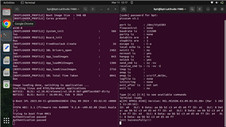

  • Hi Prashant,
    I have followed same steps but my MCU R5 Core is stuck. How to solve this error
    I included my edited files

    Below one Linux booting log
    sudo picocom -b 115200 -r -l /dev/ttyUSB0
    picocom v3.1
    port is        : /dev/ttyUSB0
    flowcontrol    : none
    baudrate is    : 115200
    parity is      : none
    databits are   : 8
    stopbits are   : 1
    escape is      : C-a
    local echo is  : no
    noinit is      : no
    noreset is     : yes
    hangup is      : no
    nolock is      : yes
    send_cmd is    : sz -vv
    receive_cmd is : rz -vv -E
    imap is        :
    omap is        :
    emap is        : crcrlf,delbs,
    logfile is     : none
    initstring     : none
    exit_after is  : not set
    exit is        : no
    Type [C-a] [C-h] to see available commands
    Terminal ready
    [BOOTLOADER_PROFILE] Boot Media       : eMMC
    [BOOTLOADER_PROFILE] Boot Media Clock : 200.000 MHz
    [BOOTLOADER_PROFILE] Boot Image Size  : 981 KB
    [BOOTLOADER_PROFILE] Cores present    :
    wkup-r5f0-0
    [BOOTLOADER PROFILE] System_init                      :      38674us
    [BOOTLOADER PROFILE] Board_init                       :          0us
    [BOOTLOADER PROFILE] Drivers_open                     :          0us
    [BOOTLOADER PROFILE] SBL Drivers_open                 :      20423us
    [BOOTLOADER PROFILE] Board_driversOpen                :          0us
    [BOOTLOADER PROFILE] App_loadSelfcoreImage            :      22111us
    [BOOTLOADER_PROFILE] SBL Total Time Taken             :      81210us
    Image loading done, switching to application ...

    I attached the screenshot also first 1.2 sec worked fine after not coming data

    The issue with the MCU R5 core is resolved. However, my LVDS display is not showing the TI App Launcher. I have shared the current logs. Could you help me fix this issue?
    [BOOTLOADER_PROFILE] Boot Image Size  : 1516 KB
    wkup-r5f0-0
    [BOOTLOADER PROFILE] System_init                      :      38654us

    [   10.484007] sh (1088): drop_caches: 1
     _____                    _____           _         _
    |  _  |___ ___ ___ ___   |  _  |___ ___  |_|___ ___| |_
    |     |  _| .'| . | . |  |   __|  _| . | | | -_|  _|  _|
    |__|__|_| |__,|_  |___|  |__|  |_| |___|_| |___|___|_|
                  |___|                    |___|
    Arago Project am62pxx-evm -
    Arago 2023.10 am62pxx-evm -
    am62pxx-evm login: [   31.891638] vdd_mmc1: disabling
    Veerapandiyan V.
  • However, my LVDS display is not showing the TI App Launcher. I have shared the current logs. Could you help me fix this issue?
    I cannot help with this issue due to the lack of expertise.
    Please create a new thread for this issue for it to be assigned to the subject matter expert.
    Thanks!
  • Hi Prashant,
    Thanks for your response. I will close this thread and open a new one for the issue.
    Veerapandiyan V.
