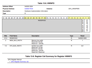

    My assumption is that the AM574x has dedicated bus bandwidth given to the GPU in the case of the AM5748x since the device has a doble core vs the single core GPU in AM5718.
    Can you check what the settings are for this register in both devices?
    Am571x:
    Am574x:
    Is there a difference in SYS_BUS_WIDTH?
    -Josue
  • Hello Josue,
    Checked, both AM5718 and AM5748 have a value of 0x00000005 in register 0x5600FE04, which means that Reset value is kept. 128 bits MEM_BUS_WIDTH and 64 bits SYS_BUS_width.
