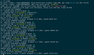

We are using SDK 10 and want to implement SPL + OSPI + UFS boot. Here's what we've done and the issues we're facing:
1 We've written boot files to norflash
2 We've modified the bootcmd

Current results:
  1. All cores can boot
  2. Linux can boot
  3. But when executing source ./vision_apps_init.sh, we encounter errors
  4. root@j721e-evm:/opt/vision_apps# source ./vision_apps_init.sh
    root@j721e-evm:/opt/vision_apps#      0.000000 s: APP_LOG: ERROR: Unable to map memory @ 0xac000000 of size 262144 bytes !!!
    APP_LOG: ERROR: Unable to map memory @ 0xb0000000 of size 3288576 bytes !!!
The boot log is
