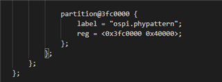

    The partition table is as follows:
  2. partitions {
    compatible = "fixed-partitions";
    #address-cells = <1>;
    #size-cells = <1>;
    partition@0 {
    label = "ospi.tiboot3";
    reg = <0x0 0x80000>;
    partition@80000 {
    label = "ospi.tispl";
    reg = <0x80000 0x200000>;
    partition@280000 {
    label = "ospi.u-boot";
    reg = <0x280000 0x400000>;
    partition@680000 {
    label = "ospi.env";
    reg = <0x680000 0x40000>;
    partition@6c0000 {
    label = "ospi.sysfw";
    reg = <0x6c0000 0x100000>;
    partition@7c0000 {
    label = "ospi.env.backup";
    reg = <0x7c0000 0x40000>;
    partition@800000 {
    label = "ospi.rootfs";
    reg = <0x800000 0x37c0000>;
    partition@3fc0000 {
    label = "ospi.phypattern";
    reg = <0x3fc0000 0x40000>;

    Regarding the PHY file for S28HS512TGABHM010:
    According to the post heresoftware-dl.ti.com/.../UG-QSPI.html) the PHY file (ospi_phy_pattern) for MT35XU512ABA is available for download. However, can the PHY file for S28HS512TGABHM010 be provided?
    The same pattern can be used for this flash as well. This is a generic pattern for all nor flashes.

    Couldn't find partition mmc 1:2
    Can't set block device

    [    2.874608] spi-nor spi6.0: s28hs512t (65536 Kbytes)
    [    2.881932] sd 0:0:0:1: [sdb] Preferred minimum I/O size 524288 bytes
    [    2.881935] sd 0:0:0:1: [sdb] Optimal transfer size 524288 bytes
    [    2.899439] 8 fixed-partitions partitions found on MTD device 47040000.spi.0
    [    2.906494] Creating 8 MTD partitions on "47040000.spi.0":
    [    2.911982] 0x000000000000-0x000000080000 : "ospi.tiboot3"
    [    2.917575] sd 0:0:0:1: [sdb] Attached SCSI disk
    [    2.922820]  sda: sda1
    [    2.922935] 0x000000080000-0x000000280000 : "ospi.tispl"
    [    2.925393] sd 0:0:0:0: [sda] Attached SCSI disk
    [    2.930563] sd 0:0:0:2: [sdc] 8192 4096-byte logical blocks: (33.6 MB/32.0 MiB)
    [    2.935581] 0x000000280000-0x000000680000 : "ospi.u-boot"
    [    2.942436] sd 0:0:0:2: [sdc] Write Protect is off
    [    2.948222] 0x000000680000-0x0000006c0000 : "ospi.env"
    [    2.957789] sd 0:0:0:2: [sdc] Write cache: enabled, read cache: enabled, supports DPO and FUA
    [    2.958169] 0x0000006c0000-0x0000007c0000 : "ospi.sysfw"
    [    2.966305] sd 0:0:0:2: [sdc] Preferred minimum I/O size 524288 bytes
    [    2.972081] 0x0000007c0000-0x000000800000 : "ospi.env.backup"
    [    2.978019] sd 0:0:0:2: [sdc] Optimal transfer size 524288 bytes
    [    2.978878] sd 0:0:0:2: [sdc] Attached SCSI disk
    [    2.984356] 0x000000800000-0x000003fc0000 : "ospi.rootfs"
    [    3.000223] 0x000003fc0000-0x000004000000 : "ospi.phypattern"
