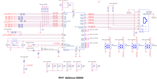

Dear TI,
We made a new board with J7200(DRA821U), and use sdk "ti-processor-sdk-linux-j7200-evm-09_02_00_05".
The board have three ethernet ports, one mcu_cpsw, and two ports on Main CPSW.
For now, mcu_cpsw already work normal, but main cpsw ports not work, we used mofiled the dtso file "k3-j7200-evm-quad-port-eth-exp.dtso" as below, which already disabled unused port3 and port4

however, after set ip for eth1 or eth2, it ping failed, and print lots of logs as below.
[ 1977.825539] am65-cpsw-nuss c000000.ethernet eth1: txq:0 DRV_XOFF:0 tmo:1404352 dql_avail:-39 free_desc:505
[ 1982.945537] am65-cpsw-nuss c000000.ethernet eth1: txq:0 DRV_XOFF:0 tmo:1409472 dql_avail:-39 free_desc:505
[ 1988.065539] am65-cpsw-nuss c000000.ethernet eth1: txq:0 DRV_XOFF:0 tmo:1414592 dql_avail:-39 free_desc:505
[ 1994.209536] am65-cpsw-nuss c000000.ethernet eth1: txq:0 DRV_XOFF:0 tmo:1420736 dql_avail:-39 free_desc:505
I have tried to change "phy-mode" to "rgmii", "rgmii-rxid", "rgmii-id", but not work.
attach the dmesg log on boot as below.

we can see the error message "[    4.680095] am65-cpsw-nuss c000000.ethernet: PSI-L request err -22" , but don't know why.
For this issue, how can I check next?
BR
guangtao
    Can you please provide the changes made?
    If you need RGMII connection, you need to set the phy-mode as "rgmii" relevant as per delay requirements.
    Sudheer
  • Yes, we need RGMII connection, and I tried set the phy-mode to "rgmii", but still not work, about the "delay requirements", how can I set it?
  • BTW, about the changes, you can see below dts "k3-j7200-common-proc-board.dts" and above "k3-j7200-evm-quad-port-eth-exp.dtso" mentioned it the questions.

    I just disabled some unused devices, such as mcan*, serdes, pcie*.
    You need to configure the CPSW Ports in RGMII Mode.
    Also, need to enable Pins for RGMII functionality, refer to "mcu_cpsw_pins_default" from "k3-j7200-common-proc-board.dts" file where CPSW2G pins configured in RGMII Mode.
    Please refer to FAQ for RGMII delay related configuration information.
    https://e2e.ti.com/support/processors-group/processors/f/processors-forum/1319345/faq-tda4vm-how-to-configure-rgmii-clock-delay-on-j7-devices
    Sudheer
  • I have tried to enable Pins for RGMII functionality as below which named "k3-j7200-evm-gesi-proc-board.dtso", and removed unused "serdes", but still not work, it still showing the error message "[    4.766169] am65-cpsw-nuss c000000.ethernet: [XIVI-RX]PSI-L request err -22".
    /dts-v1/;
    /plugin/;
    #include <dt-bindings/gpio/gpio.h>
    #include <dt-bindings/net/ti-dp83867.h>
    #include "k3-pinctrl.h"
    	aliases {
    		ethernet1 = "/bus@100000/ethernet@c000000/ethernet-ports/port@1";
    		ethernet2 = "/bus@100000/ethernet@c000000/ethernet-ports/port@2";
    		//ethernet3 = "/bus@100000/ethernet@c000000/ethernet-ports/port@3";
    		//ethernet4 = "/bus@100000/ethernet@c000000/ethernet-ports/port@4";
    &cpsw0 {
    	status = "okay";
    	pinctrl-names = "default";
    	pinctrl-0 = <&rgmii1_pins_default
    			  &rgmii2_pins_default>;
    &cpsw0_port1 {
    	status = "okay";
    	phy-handle = <&cpsw5g_phy0>;
    	phy-mode = "rgmii-rxid";
    	mac-address = [00 00 00 00 00 00];
    	phys = <&cpsw0_phy_gmii_sel 1>;
    &cpsw0_port2 {
    	status = "okay";
    	phy-handle = <&cpsw5g_phy1>;
    	phys = <&cpsw0_phy_gmii_sel 2>;
    &cpsw5g_mdio {
    	status = "okay";
    	pinctrl-0 = <&mdio0_pins_default>;
    	bus_freq = <1000000>;
    	#address-cells = <1>;
    	#size-cells = <0>;
    	cpsw5g_phy0: ethernet-phy@0 {
    		reg = <0>;
    		ti,rx-internal-delay = <DP83867_RGMIIDCTL_2_00_NS>;
    		ti,fifo-depth = <DP83867_PHYCR_FIFO_DEPTH_4_B_NIB>;
    		ti,min-output-impedance;
    	cpsw5g_phy1: ethernet-phy@1 {
    		reg = <1>;
    &main_pmx0 {
    	mdio0_pins_default: mdio0-pins-default {
    		pinctrl-single,pins = <
    			J721E_IOPAD(0x00a8, PIN_OUTPUT, 5) /* (W19) UART8_TXD.MDIO0_MDC */
    			J721E_IOPAD(0x00a4, PIN_INPUT, 5) /* (W14) UART8_RXD.MDIO0_MDIO */
    	rgmii1_pins_default: rgmii1-pins-default {
    			J721E_IOPAD(0x4, PIN_INPUT, 4) /* (AC23) PRG1_PRU0_GPO0.RGMII1_RD0 */
    			J721E_IOPAD(0x8, PIN_INPUT, 4) /* (AG22) PRG1_PRU0_GPO1.RGMII1_RD1 */
    			J721E_IOPAD(0xc, PIN_INPUT, 4) /* (AF22) PRG1_PRU0_GPO2.RGMII1_RD2 */
    			J721E_IOPAD(0x10, PIN_INPUT, 4) /* (AJ23) PRG1_PRU0_GPO3.RGMII1_RD3 */
    			J721E_IOPAD(0x1c, PIN_INPUT, 4) /* (AD22) PRG1_PRU0_GPO6.RGMII1_RXC */
    			J721E_IOPAD(0x14, PIN_INPUT, 4) /* (AH23) PRG1_PRU0_GPO4.RGMII1_RX_CTL */
    			J721E_IOPAD(0x30, PIN_OUTPUT, 4) /* (AF24) PRG1_PRU0_GPO11.RGMII1_TD0 */
    			J721E_IOPAD(0x34, PIN_OUTPUT, 4) /* (AJ24) PRG1_PRU0_GPO12.RGMII1_TD1 */
    			J721E_IOPAD(0x38, PIN_OUTPUT, 4) /* (AG24) PRG1_PRU0_GPO13.RGMII1_TD2 */
    			J721E_IOPAD(0x3c, PIN_OUTPUT, 4) /* (AD24) PRG1_PRU0_GPO14.RGMII1_TD3 */
    			J721E_IOPAD(0x44, PIN_OUTPUT, 4) /* (AE24) PRG1_PRU0_GPO16.RGMII1_TXC */
    			J721E_IOPAD(0x40, PIN_OUTPUT, 4) /* (AC24) PRG1_PRU0_GPO15.RGMII1_TX_CTL */
    	rgmii2_pins_default: rgmii2-pins-default {
    			J721E_IOPAD(0x7c, PIN_INPUT, 4) /* (Y13) PRG1_PRU1_GPO0.RGMII2_RD0 */
    			J721E_IOPAD(0x80, PIN_INPUT, 4) /* (AA15) PRG1_PRU1_GPO1.RGMII2_RD1 */
    			J721E_IOPAD(0x84, PIN_INPUT, 4) /* (AA14) PRG1_PRU1_GPO2.RGMII2_RD2 */
    			J721E_IOPAD(0x88, PIN_INPUT, 4) /* (AA18) PRG1_PRU1_GPO3.RGMII2_RD3 */
    			J721E_IOPAD(0x78, PIN_INPUT, 4) /* (Y14) PRG1_PRU1_GPO6.RGMII2_RXC */
    			J721E_IOPAD(0x8c, PIN_INPUT, 4) /* (AA16) PRG1_PRU1_GPO4.RGMII2_RX_CTL */
    			J721E_IOPAD(0x90, PIN_OUTPUT, 4) /* (W17) PRG1_PRU1_GPO11.RGMII2_TD0 */
    			J721E_IOPAD(0x94, PIN_OUTPUT, 4) /* (W20) PRG1_PRU1_GPO12.RGMII2_TD1 */
    			J721E_IOPAD(0x98, PIN_OUTPUT, 4) /* (V14) PRG1_PRU1_GPO13.RGMII2_TD2 */
    			J721E_IOPAD(0x9c, PIN_OUTPUT, 4) /* (V13) PRG1_PRU1_GPO14.RGMII2_TD3 */
    			J721E_IOPAD(0x28, PIN_OUTPUT, 4) /* (W21) PRG1_PRU1_GPO16.RGMII2_TXC */
    			J721E_IOPAD(0xa0, PIN_OUTPUT, 4) /* (U12) PRG1_PRU1_GPO15.RGMII2_TX_CTL */
    please help check this dtso, is everything ok?
    device tree configuration looks file.
    Can you confirm, ETHFW is not loaded on MCU2_0 core? It can happen only when CPSW5G is controlled/configured by other core.
