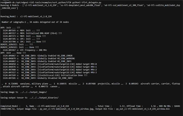

  • Hi Chris,
    I am using TIDL version 10_01_04_00.
    I have tested running models using the command python3 tflrt_delegate.py, as shown in the image below, and it executed successfully.
    Upon checking, I found that when compiling, the layer model_102/tf.compat.v1.transpose_49/transpose is not supported. Therefore, I added it to deny_list:layer_type to prevent this layer from running on C7x-MMA. However, the error still persists.
    Could you take a look at the graphvizInfo.txt file below?

  • Hi Hieu,
    The screenshot you are displaying is the run of the out-of-the-box models, not your model.  Can you please send me your model, configuration files, and the command line for how you run it? I will check it out.
    Chris
