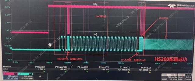

#1. Register HOST_CONTROL2 [V1P8_SIGNAL_ENA] bit description only mentioned control signal voltage. did not mention signal polarity. customer wants to know more details about how polarity related the voltage change? From which point change polarity from below #2 waveform

#2.  Did not observe voltage change across eMMC initialization, cmd is always 3.3V, data is always 1.8V.
    The data line polarity change happens when eMMC switch to HS200 mode, it has nothing to do with the V1P8_SIGNAL_ENA bit.
    The data line voltage change (3.3v vs 1.8v) is only applicable to SD card. eMMC bus is always 1.8v.

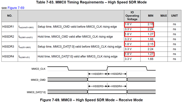

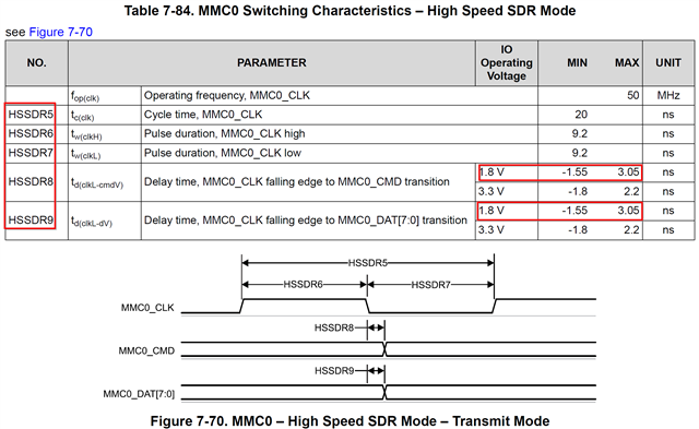

  • Update from offline by Paul:
    Half-cycle timing – this is where data is launched on the negative edge of clock and latched on the following positive edge of clock.
    Full-cycle timing – this is where data launched on the positive edge of clock and latched on the following positive edge of clock.
    DDR – this is where data is launched on each edge of clock and latched on the following edge of clock.
    The appropriate timing mode for each device is shown in the respective datasheet Switching Characteristics table and associated timing diagram.  For example, the AM62x device expects the host controller to operate in Half-cycle timing when you reference the Switching Characteristics of Legacy SDR and High Speed SDR modes.  You can see an example of Full-cycle timing when referencing the Switching Characteristics of HS200 mode.

    Customer needs to evaluate the risk of boards working in wrong timing mode in field, Question as below:
    As wrong configured to Half cycle timing for HS200 which should be full cycle timing.
    #1. What is the setup/hold time requirements of wrong configured HS200 receive mode, customer need the data similar as below table SDR timing at 200MHz.
    #2. Also need the transmit timing data of HS200 wrong configured at half timing mode.
