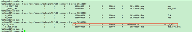

mipi-dsi is connected to the mipi screen, but the screen is not currently displayed.
Noticed that dsi_p_clk is not rate, why is this and how can I troubleshoot the problem? Please guide.

  • We are working on correcting the bug wherein dsi_p_clk does not enumerated, but that should not affect the display functionality.

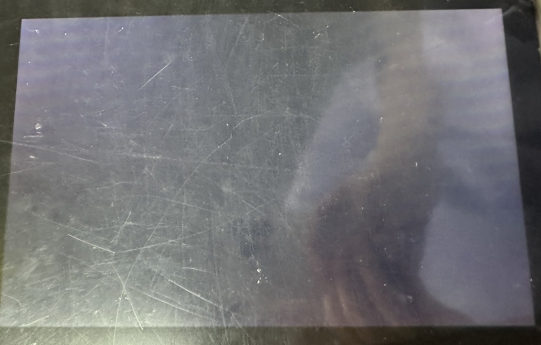

    The display backlight is on, but no image is shown.

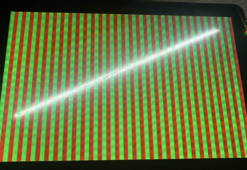

    And when I change the timing a little bit, for example like this, it loads normally, but there is no display and no TX signal is measured.
        .clock = 150000,
        .hdisplay = 1200,
        .hsync_start = 1200 + 80,
        .hsync_end = 1200 + 80 + 24,
        .htotal = 1200 + 80 + 24 + 60,
        .vdisplay = 1920,
        .vsync_start = 1920 + 20,
        .vsync_end = 1920 + 20 + 4,
        .vtotal = 1920 + 20 + 4 + 10,
    [   13.469235] [drm] Initialized tidss 1.0.0 for 30200000.dss on minor 0
    [   13.739774] Console: switching to colour frame buffer device 240x67
    [   13.772004] tidss 30200000.dss: [drm] fb0: tidssdrmfb frame buffer device

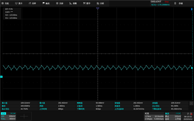

    Can you please describe your testbench. How are you checking the MIPI-DSI-TX signal? Are the respective panel connected (RPi panel for RPi overlay and your custom panel for custom overlay) with an application running in the background while you probe for the signals?

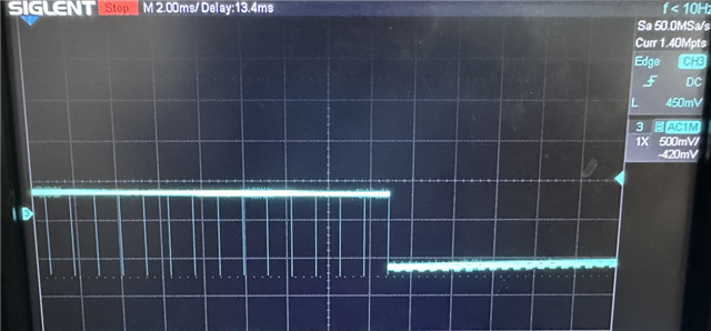

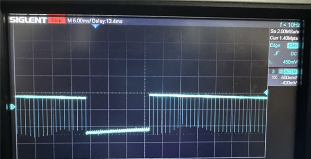

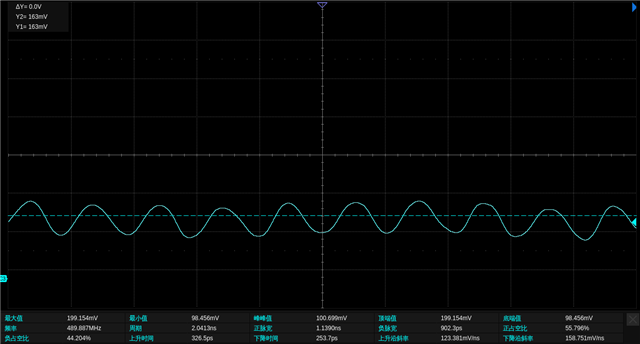

  • Since my screen would not light up, I measured the signal using an oscilloscope and I found that there was no signal from the TX, so I did the following two scenarios, neither of which had the screen connected, but instead measured the signal from the TX directly and using the same tc358762.c driver. My question now is why would just changing the resolution affect the signal output from the TX.
    1、The resolution is 800x480 and the measurement DSI_TX3_N has a data signal:
        .clock = 28569600 / 1000,
        .hdisplay = 800,
        .hsync_start = 800 + 48,
        .hsync_end = 800 + 48 + 32,
        .htotal = 800 + 48 + 32 + 80,
        .vdisplay = 480,
        .vsync_start = 480 + 3,
        .vsync_end = 480 + 3 + 7,
        .vtotal = 480 + 3 + 7 + 6,

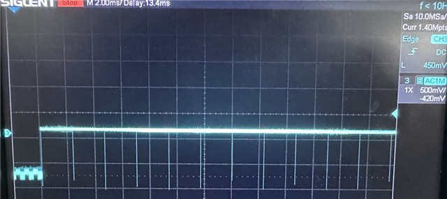

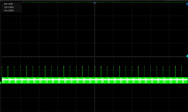

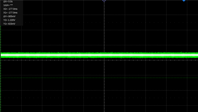

    2、Simply change the resolution to 1280x720 and measure DSI_TX3_N again No data signal:
        .clock = 74250,
        .hdisplay = 1280,
        .hsync_start = 1280 + 110,
        .hsync_end = 1280 + 110 + 40,
        .htotal = 1280 + 110 + 40 + 220,
        .vdisplay = 720,
        .vsync_start = 720 + 5,
        .vsync_end = 720 + 5 + 5,
        .vtotal = 720 + 5 + 5 + 20,

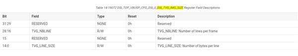

    I'd like to know first why changing only the resolution affects the TX signal, in my past debugging, changing only the resolution, the signal should always remain with an output, is there a limit to the resolution somewhere?
  • Also, I changed the lanes in tc358762.c is to 4, so in the first case, DSI_TX3_N has a data signal.
    In the second case, the lanes are also 4.
    That is, the tc358762.c is unchanged during the test signal. The only thing that changes is the resolution from 800x480 > 1280x720; there is no TX data signal for other resolutions. For example 1200x1920.

    I have already measured the signals in previous responses. ​​
    When the screen resolution is 800x480​​, the display works normally, and both data and clock signals can be measured.
    When the screen resolution is 1280x720, the clock signal is present, but there is no ​​DSI_TX data signal​​. I have confirmed that the screen works properly on other development boards. How do I check the ​​LP11 state​​?

    2. update TVG_IMG_SIZE ----> register value: [vdisplay <<16 |  3*hdisplay],
    3. Configure Color1,2.
    4. kick off TVG RUN.
    Please dump the registers again and share what you see on screen/probe
    1、4-lane configuration with 60 fps​​ is used.
    2、After following your instructions, the ​​DSI_TX signal​​ can be measured. The waveforms of ​​DSI0_TXN​​ and ​​DSI0_TXP​​ appear identical, as shown in the figure below. However, the ​​polarity seems inverted​​? Not displayed
    3、How is the value of ​​DSI_TVG_IMG_SIZE​​ calculated? I could not find the relevant calculation method in the manual. If I want to test with a ​​1200x1920 screen​​, how should I calculate the value of ​​DSI_TVG_IMG_SIZE​​?
  • After following your instructions, the ​​DSI_TX signal​​ can be measured.
    If you didn't modify DSI_TVG_IMG_SIZE, what other changes did you do?
    I have already shared how to calculate DSI_TVG_IMG_SIZE.
    For 1280x720, vdisplay=720 and hdisplay=1280,
    Iterating again; DSI_TVG_IMG_SIZE value = {leftshift(vdisplay, 16 times) |binary OR| (3 times the value of hdisplay)}
    attaching register bit settings for your reference.
    For 1200x1920 screen, vdisplay=1920 and hdisplay=1200.
    Please also specify which screen you are targeting, 1280x720(horizontal) or 1200x1920 (vertical).
    If using the latter, please share the timing parameters too.
  • Thanks.

    DSI_TX Waveform:
  • Do you see anything on display?
  • There is no display, and the waveform is inverted compared to normal operation. Could this be an issue? Additionally, there are intermittent instances where the waveform is completely absent.
    I updated the device tree driver, and after executing the scripts, the display now works.

    Can you please change the clock in qunxin_1200x1920_mode to 160000 from 150000.
    Retry the script and then reboot+kmstest.
    Probe clock lane in both cases please.

    Here are the clock signals tested under both conditions. There appears to be no noticeable difference.
    reboot+kmstest :
  • Just to confirm, you still see the test pattern on screen but no kmstest ouput?
  • Yes, after reboot and running kmstest, there is no output on the screen.

  • I have successfully powered up an 800x1280 screen that displays normally. Additionally, I have another 1200x1920 screen. The only difference between them is the resolution—they share the same driver IC. This means I shouldn’t need to modify the driver; adjusting the resolution alone should suffice for normal display. However, I discovered that the screen timing parameters cannot be customized, making it difficult to configure them correctly. Even when using timing parameters from the screen’s manual, the screen fails to display.
    For example, the screen timing specified in the datasheet for the 800x1280 display is:
    .clock = 60000,
    .hdisplay = 800,
    .hsync_start = 800 + 5,
    .hsync_end = 800 + 5 + 6,
    .htotal = 800 + 5 + 6 + 5,
    .vdisplay = 1280,
    .vsync_start = 1280 + 4,
    .vsync_end = 1280 + 4 + 2,
    .vtotal = 1280 + 4 + 2 + 2,
    This configuration does not work.
    When I modified the timing to the following, the screen displayed successfully:
    .clock = 82550,
    .hdisplay = 800,
    .hsync_start = 800 + 100,
    .hsync_end = 800 + 100 + 32,
    .htotal = 800 + 100 + 32 + 80,
    .vdisplay = 1280,
    .vsync_start = 1280 + 20,
    .vsync_end = 1280 + 20 + 3,
    .vtotal = 1280 + 20 + 3 + 30,
    This results in the possibility that even using the timing parameters from the screen datasheet, the display may not function. I believe this is why my 1200x1920 screen is currently not working, as I have yet to identify suitable timing parameters. ​​What specific rules must be followed for screen timing configuration on the AM62L platform? Is there documentation addressing this?​​

  • Hi Mazel,
    Can You please show or attach an image how does your display gui looks like .Is Weston GUI Visible?
