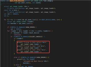

I found the functions board_init_r and spl_Lad_Simple_fit. The function boot_from_devices is called in the function board.init_r, where the log is printed:Trying to boot from.....
Firstly, I added a log in the boot_from_devices function:
After the make all and make install commands are compiled and started at the board end, I can't find the logs I added. They are the same as the logs when I started earlier. What is the question?
