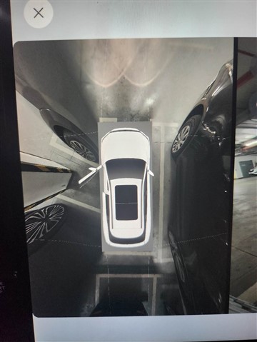

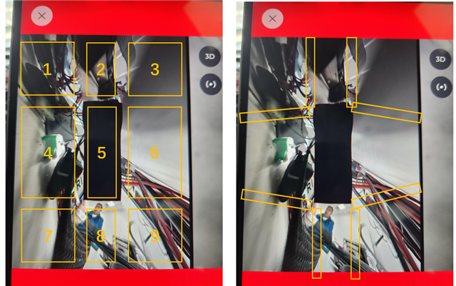

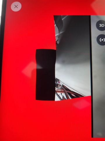

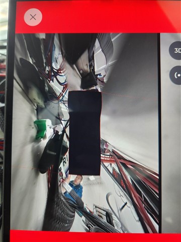

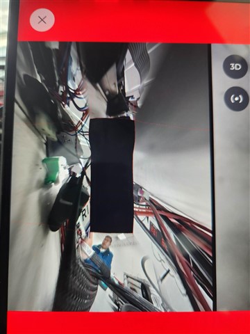

  • Hi Sarabesh,
    Our customer successfully enabled antialiasing by following the referenced post, but encountered visible seams after enabling anti-aliasing. Key observations:
    1. The viewport consists of 9 irregularly shaped tiles;
    Each tile comprises multiple triangular faces with shared vertices (no physical gaps);
    No visible seams appear when antialiasing is disabled;
    2. 8 intermittent dotted-line seams (~1 pixel wide) appear when enabled anti-aliasing;
    Seams remain static and show blended colors between tile edges and base color (clear color);
    3. Default order (2 4 6 8 1 3 7 9 5) produces 8 seams
    Modified order (2 3 6 9 8 7 4 1 5) reduces seams to 4
    Even if only rendering 3 6 5 still shows seams.
    4. Tiles use camera-captured images as shading;
    Seams will disappear if changing fragment shader with fixed color like black vec(0.0, 0.0, 0.0, 1.0)
    This issue only occurs on TDA4VE - other SoCs from different vendors using identical logic and data cannot reproduce the behavior. Please assist in analyzing potential root causes for this antialiasing issue.

  • Hi Sarabesh,
    Anti-aliasing is a must required feature from CAR OEM.
    The texture bleeding that is occurring is expected of anti-aliasing. When anti-aliasing, the edges are blurred to remove the jagged edges, and this can cause texture bleeding. Examples of the problem:
    There are multiple of ways to fix it, but they are within the graphics application itself, not the GPU or DMA subsystems. A couple solutions:

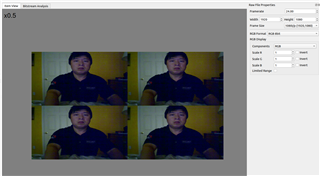

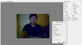

  • Hello Gaston,
        i tried the example in ti-processor-sdk-rtos-j721s2-evm-08_06_01_03/vision_apps/apps/basic_demos/app_linux_arm_opengl_mosaic/
        it will convert 4 pictures in opt/vision_apps/test_data/psdkra/app_opengl_mosaic/input1_file.bin (nv21 yuv format)
    https://e2e.ti.com/cfs-file/__key/communityserver-discussions-components-files/791/input1_5F00_file.bin
        to one picture output in output/mosaic_output_file.bin
    https://e2e.ti.com/cfs-file/__key/communityserver-discussions-components-files/791/mosaic_5F00_output_5F00_file.bin
        is this the same operation in your case?
       Semon

    I am going to address your issue here:
    After taking a look at both files, the unexpected output appears to be due to the settings you have in the YUVView tool. I will share the settings to view the images below:
    1. input1_file.bin- It doesn't look like you set the resolution (640x480) on the right side panel of YUVView. Refer to my image below on what those settings are:
    2. mosaic_output_file.bin- Please refer to the below settings for the RGB output mosaic image:

  • customer already fix this issue by a workaround solution: merging the pictures first with a application running on A72 core, then feed the merged picture to GPU for post processing, thus avoid blending the picture in Opengl/GPU with anti-aliasing issue, but will cause CPU load high, used as a temporary solution,
    if CPU load becomes an issue, this issue needs further work,
    now this issue can be closed
