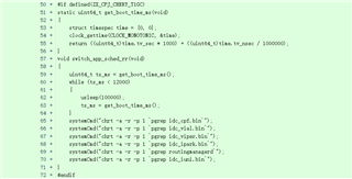

        We use the TDA4VE SDK0806 version. After changing the upper process priority, we found that the gpu driver will report an error. Our gpu driver was upgraded to version 1002 and we found that there was also an error.
        Issue Reproduction Steps:
  1. Power Cycle the System: Perform a power cycle to reboot the board's subsystem.
  2. Automatic Launch of Business Processes: The system will automatically initiate the business processes upon startup. Immediately after the processes are launched, use the chrt command to set the scheduling policy and priority for the iuni and other business processes:
            "chrt -a -r -p 1 $pid"
            Note: The iuni process has a dedicated thread responsible for launching the PVR (egl api) module.
  1. Monitor System Behavior: Use the top command and check the dmesg logs. Within a few seconds, there is a probability that an exception related to pvr_k will be printed.

  • Hi Sarabesh:
                       Our application layer changes the priority function as shown below
                       Our kernel uses the TDA4VE sdk linux 0806 version, but has been modified to some extent. See the attached file for defconfig.
