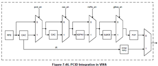

So for the ISP tuning for some blocks we need raw image(.aw image) as a input in DCC tool. As per the TRM
"The PCID produces both Bayer and IR data concurrently from input RGBIR image. Bayer channel data is fed
to rest of the VISS pipe line and IR channel output is directly written to memory using one of LSE channels"
Q1) Is it possible to save the Converted Bayer raw image(.raw) from the PCID block?
Q2) For the ISP tuning for some blocks(AWB,CCM,NF,EE) we need raw image(.raw image) as a input in DCC tool.
      So which .raw image should i use for these blocks tuning? Is it RGBIR raw image or Converted Bayer raw image?
