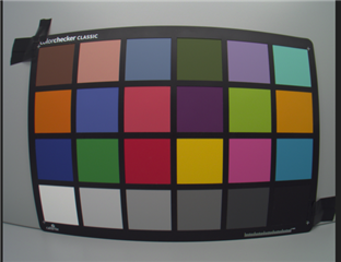

original checkerboard image

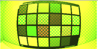

captured using the AR0823 RGB-IR sensor with 12- bit linear mode

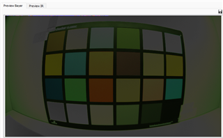

After applying PCID tuning bayer output as shown below
the colors from the color checkerboard are not accurate.

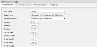

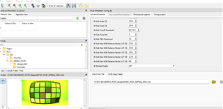

I used the following parameters to tune the PCID.

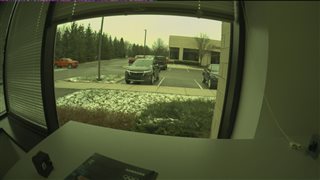

Ran default single cam app for capturing images using AR0823 sensor
