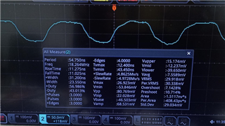

    Here is the OLDI CLK0 P ,
    1: 800x480 35 MHz clock expected : half is detected 18Mhz

    Thanks for the probe results.
    As an experiment to solve this issue, can you please try disabling splash in u-boot.

    Not really needed. What do you see in the output of `k3conf dump clock | grep DSS0_DPI_0` for either cases? Is it the expected frequency, or the actual frequency?
  • Hi Divyansh,
    Ti logo we never got on display.
    For 35Mhz 800x480 | Halfscreen
    |   186     |     0    | DEV_DSS0_DPI_0_IN_CLK                                                                                | CLK_STATE_READY     | 244800000
    No difference for uboot splash disable and enable.

    it will be very helpful if give us probed lvds +/- frequency of your setup and programmed pixel clock freq for which you got vertical lines.

    Currently I do not have the probing setup ready, but will share an update with you as soon as I can.
