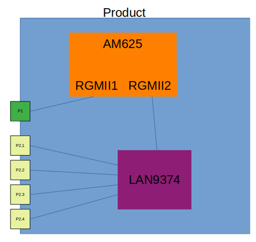

I am trying to to connect an Ethernet switch to the RGMII2 interface on the AM625. The switch in question is a Microchip LAN8374.
The issue I'm having is with being able to connect the switch RGMII port to the AM625's RGMII2 interface- specifically, I cannot link the `ethernet` property of the port node to the cpsw_port2 node as it causes the switch initialisation to fail (ultimately because it cannot find the master node). I can successfully initialise the switch if I connect it to the cpsw3g node, but this seems to connect it to the RGMII1 interface rather than RGMII2.

Can you advise how DSA switches are supposed to be connected to RGMII2 please?

  • Hello Daolin,
    The issue I'm having is not with the Microchip Ethernet switch (which appears to be working fine) specifically, but with how to connect any internal Ethernet switch to the RGMII 2 port given that TI decided to implement the two Ethernet interfaces as a switch, rather than two dedicated interfaces. This seems to be made a lot more difficult by the CPSW not supporting a proper DSA tag protocol, but relying on 802.1q VLAN identifiers (which, per the documentation - kernel.org/doc/Documentation/networking/dsa/dsa.txt - is identified as having limitations) to determine the source and destination port (this, in my opinion, is a poor design choice). I would suggest that connecting an internal switch to the AM625 RGMII 2 port is a perfectly valid use case, so I would appreciate some support in how to go about this.
    Do TI have a reference for how this should be implemented? My requirement is that each port of the switch can operate in a distinct VLAN, but I'm not sure how that aligns when connecting to CPSW which will add/remove VLAN tags on ingress/egress. Can DSA switch trees be used to support this? If so, can you provide any details on how the CPSW is set up in terms of switch trees? Or if this isn't the correct way to go about this, can I alter the behavior of how CPSW adds/removes VLAN tags? I understand that the CPSW can be operated in switch mode (which I believe disables the VLANing?) but I'm not clear on how to enable that in the device tree. And if I did enable it, is it still possible to ensure that RGMII 1 and RGMII 2 remain separate with no cross-contamination of traffic?

    Yes, the "internal switch" is the Microchip LAN9374. Our setup is as follows:
    Because cpsw_port1 and cpsw_port2 aren't MACs, all I can do is bind the LAN9374 CPU port to the root cpsw3g node. In dsa.c, a call is made to of_find_net_device_by_node() to find the upstream MAC for the switch CPU port; this ultimately uses class_find_device(), which finds the first node of the correct class and stops. This means that my LAN9374 switch ends up "logically" connected to RGMII1 rather than RGMII2, which isn't correct. I've tried getting around this with a quick hack to make it use the second matching node rather than the first; in this case, the switch ends up logically descending from RGMII2 as expected, but doesn't work (i.e. doesn't pass traffic).
    The only difference I can see in the device tree you linked to is the use of the dsa,member property. This makes sense given that my LAN9374 is effectively the second switch in the tree, with the AM625 being the root switch, but I don't understand why its value is set to 0 0. Would you expect this?
    Would you be able to advise on how to correctly set this up please? Per the diagram, product port P1 is a single TX phy (TI DP83826) connected to RGMII1 (as RMII). P2.1-P2.4 are T1 ports connected to a LAN9374 switch, in turn connected to RGMII2. P1 will not use 802.1q VLANs, but I need P2.1-P2.4 to be able to sit in different VLANs.

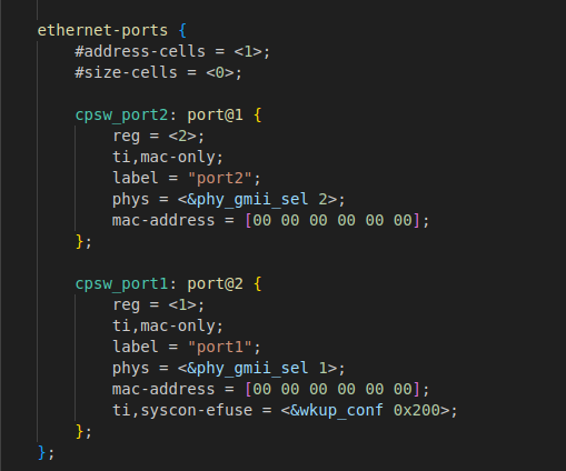

    This dsa,member property appears to be more of a switch configuration property rather than CPSW property. In the referenced device tree, the customer added the dsa,member property to the switch node that they were using so I cannot comment on why they chose to set 0 0. Since the switch you are using is not a TI part, I cannot offer any official comments on this dsa,member property. That being said, would the description in https://www.kernel.org/doc/Documentation/devicetree/bindings/net/dsa/dsa.yaml help explain the dsa,member property?
    Let us focus first on why the switch is not logically connected to RGMII2 first, it appears to be a similar behavior to Naveenkumar's thread. I need some time to discuss internally about this issue. I plan to respond with an update Wednesday, please kindly ping this thread if you don't hear a response by then.

    				port@1 {
    					reg = <0x01>;
    					ti,mac-only;
    					label = "port1";
    					phys = <0x36 0x01>;
    					mac-address = [00 00 00 00 00 00];
    					ti,syscon-efuse = <0x37 0x200>;
    					bootph-all;
    					phy-mode = "rmii";
    					phy-handle = <0x38>;
    					ti,dual-emac-pvid = <0x01>;
    					status = "okay";
    					phandle = <0xac>;
    				port@2 {
    					reg = <0x02>;
    					ti,mac-only;
    					label = "port2";
    					phys = <0x36 0x02>;
    					phy-mode = "rgmii";
    					#address-cells = <0x01>;
    					#size-cells = <0x00>;
    					ti,dual-emac-pvid = <0x02>;
    					status = "okay";
    					phandle = <0xad>;
    					fixed-link {
    						speed = <0x3e8>;
    						full-duplex;

  • Hi Ben,
    No problem, thanks for sharing your decompiled DTS. I'm currently out of office on business and am back in office next week so I wanted to let you know that I will be able to take a closer look next week.
    As something to try, can you try changing swapping the cpsw_port1 and cpsw_port2 in the aliases property of your DTS? The idea is to try and see if we can "trick" the Kernel to view cpsw_port2 as eth0 instead. This might not work but I think it's something quick to test out.
    We are not experts on the DSA driver so regarding DSA configuration details we need some time to look into further. For full transparency, I also want to let you know that because MAC-to-MAC is unfortunately something we cannot validate physically (no hardware available on our EVMs to test this), our ability to support is also limited. I will try my best to give you suggestions as I think of them.
    If you don't hear a response from me by next Tuesday, please kindly ping this thread.
    -Daolin

  • Hello Daolin,
    Thanks for your suggestion; I gave this a try but it didn't seem to make any difference unfortunately. I made the change temporarily in k3-am62-main.dtsi (hopefully this aligns with what you suggested):
    Our TX ethernet (physically connected to RGMII 1) still works with this change.
    Aside from the problems we're having with getting this set up correctly in Linux, would you expect our design to work? My concern is our planned use of 802.1q VLANs to put each port of the LAN9374 switch in a separate VLAN, and how that will work given that TI are using VLAN tags to route frames between the ports on the internal switch on the AM625.
    Did your internal discussions yield any suggestions on what we can try next?
    Kind regards,
    Ben
  • Hi Ben,
    I actually meant a different property that you can add to the device tree. Take for example the below k3-am642-evm.dts (for the TI AM64x EVM).

    Thanks for your explanation. It's good to know that tagged frames should, in theory, pass through with their original VID as that should work fine for our use case.
    The topology is as follows:
    With regards to my testing, I have a PC connected to P2.1 and another PC connected to P2.2. They both have IP addresses assigned in the same subnet, and they can ping each other. P2.1 and P2.2 have been added to a bridge interface in VLAN 10. The AM625 has an IP address assigned to that bridge interface, also in that subnet, but it cannot ping either of those devices. I'm using the following to set that up:
    VLAN=10
    ip link set address aa:bb:cc:dd:ee:ff dev eth1
    ip link add name br0 type bridge vlan_filtering 1
    ip addr add dev br0 10.1.1.101/24
    ip link set br0 up
    ip link set t1port2b master br0
    ip link set t1port2a master br0
    bridge vlan add dev t1port2b vid ${VLAN} pvid untagged
    bridge vlan add dev t1port2a vid ${VLAN} pvid untagged
    ip link set t1port2b up
    ip link set t1port2a up
    ethtool -s t1port2b master-slave forced-master
    ethtool -s t1port2a master-slave forced-master
    (note that t1port2a = P2.1 in the diagram, and t1port2b = P2.2)

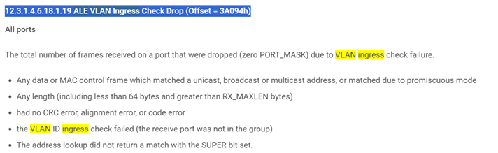

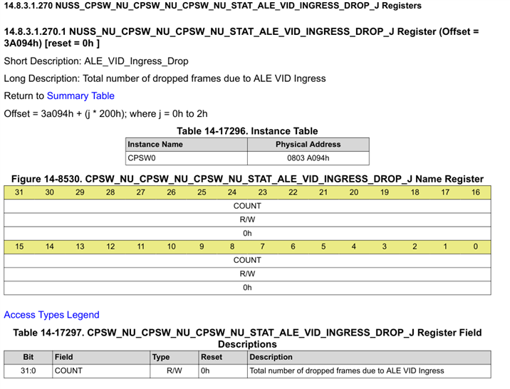

  • Hi Ben,
    Thanks for clarifying your test structure.
    Please see section 14.8.3.1.270 in the AM62x TRM to find the register you can read to verify if it matches what you see with p0_ale_vid_ingress_drop.
    You can also go to ALE VLAN Ingress Check Drop (Offset = 3A094h) in the TRM to find a description of what that statistic represents.
    One thing that I have doubts about with the register is if it shows you the ale_vid_ingress_drop or p0_ale_vid_ingress_drop. There is a difference because p0 represents the internal host port that is shared between eth0 and eth1 (external ports) of CPSW. Typically, from the perspective of p0, the "rx" means traffic received from the CPU side not the external port side. Same goes for "tx" where it represents traffic transmitted to the CPU and not traffic transmitted out the external ports. I'm guessing "ingress" in p0_ale_vid_ingress_drop, means packets from the CPU side that are entering the internal host port (I'll double check on this).

    As for why p0_ale_vid_ingress_drop does not increment when CPSW is in dual EMAC mode, I have a few questions
    1. Did you have eth0 (the port not connected to your switch) on the CPSW connected to another device while testing?
    2. Was there any other ethtool statistic incrementing? Perhaps ale_vid_ingress_drop? (Different from p0_ale_vid_ingress_drop)
