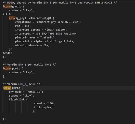

AM625: EThernet switch with am625
Part Number: AM625
We are using Ethernet Port2 with a LAN9374 Switch connected. We are enable DSA drivers in the menuconfig.
While bootup we are able to detect the LAN9374, switch but we are getting deferred probing and no additional LAN ports from the switch are detected.
Below is the device tree,
/* Verdin ETH_2_RGMII */
&cpsw_port2 {
    phy-handle = <&cpsw3g_phy1>;
    phy-mode = "rgmii-rxid";
    status = "okay";
    fixed-link {
        speed = <1000>;
        full-duplex;
lan9374: switch@1 {
                    compatible = "microchip,lan9374";
                    spi-cpha;
                    spi-cpol;
                    reg = <1>;
                    spi-max-frequency = <2000000>;
                    ethernet-ports {
                            #address-cells = <1>;
                            #size-cells = <0>;
                            port@0 {
                                    reg = <0>;
                                    label = "lan1";
                                    phy-mode = "internal";
                                    phy-handle = <&t1phy0>;
                            port@1 {
                                    reg = <1>;
                                    label = "lan2";
                                    phy-handle = <&t1phy1>;
                            port@2 {
                                    reg = <2>;
                                    label = "lan4";
                                    phy-handle = <&t1phy2>;
                            port@3 {
                                    reg = <3>;
                                    label = "lan6";
                                    phy-handle = <&t1phy3>;
                            port@4 {
                                    reg = <4>;
                                    phy-mode = "rgmii";
                                    tx-internal-delay-ps = <2000>;
                                    rx-internal-delay-ps = <2000>;
                                    ethernet = <&cpsw_port2>;
                                    fixed-link {
                                            speed = <1000>;
                                            full-duplex;
                            port@5 {
                                    reg = <5>;
                                    label = "lan7";
                                    phy-mode = "rgmii";
                                    fixed-link {
                                            speed = <1000>;
                                            full-duplex;
                            port@6 {
                                    reg = <6>;
                                    label = "lan5";
                                    phy-handle = <&t1phy6>;
                            port@7 {
                                    reg = <7>;
                                    label = "lan3";
                                    phy-handle = <&t1phy7>;
                    mdio {
                            #size-cells = <0>;
                            t1phy0: ethernet-phy@0{
                                    reg = <0x0>;
                            t1phy1: ethernet-phy@1{
                                    reg = <0x1>;
                            t1phy2: ethernet-phy@2{
                                    reg = <0x2>;
                            t1phy3: ethernet-phy@3{
                                    reg = <0x3>;
                            t1phy6: ethernet-phy@6{
                                    reg = <0x6>;
                            t1phy7: ethernet-phy@7{
                                    reg = <0x7>;
below is the error we are getting,
[    1.303053] davinci_mdio 8000f00.mdio: Configuring MDIO in manual mode
[    1.348558] davinci_mdio 8000f00.mdio: davinci mdio revision 9.7, bus freq 1000000
[    1.758624] davinci_mdio 8000f00.mdio: Configuring MDIO in manual mode
[    1.804547] davinci_mdio 8000f00.mdio: davinci mdio revision 9.7, bus freq 1000000
[    1.818383] mdio_bus 8000f00.mdio: MDIO device at address 7 is missing.
[    1.825049] davinci_mdio 8000f00.mdio: phy[0]: device 8000f00.mdio:00, driver TI DP83867
[   12.314148] am65-cpsw-nuss 8000000.ethernet eth0: PHY [8000f00.mdio:00] driver [TI DP83867] (irq=359)

  • Hi ,
    Thanks for your inputs,
    we have somehow fixed the issue of deferred probind and it was not because of the SPI driver for LAN9374. This LAN9374 is connected to the RGMII2 of the AM62x and when we use cpsw_port2 as  a reference node for the LAN9374, the driver does not load  and we drfeered probing.
    but when i use cpsw3g as a reference port all works fine except the ping.
    below is the device tree.
    /* Verdin ETHs */
    &cpsw3g {
    	pinctrl-names = "default";
    	pinctrl-0 = <&pinctrl_rgmii1>, <&pinctrl_rgmii2>;
    	status = "okay";
    		fixed-link {
    		speed = <1000>;
    		full-duplex;
    /* MDIO, shared by Verdin ETH_1 (On-module PHY) and Verdin ETH_2_RGMII */
    &cpsw3g_mdio {
    	status = "okay";
    	/* cpsw3g_phy1: ethernet-phy@7 {
    		compatible = "ethernet-phy-ieee802.3-c22";
    		reg = <7>;
    		interrupt-parent = <&main_gpio0>;
    		interrupts = <38 IRQ_TYPE_EDGE_FALLING>;
    		pinctrl-0 = <&pinctrl_eth2_rgmii_int>;
    		micrel,led-mode = <0>;
    /* Verdin ETH_1 (On-module PHY) */
    &cpsw_port1 {
    	status = "okay";
    &cpsw_port2 {
    	phy-mode = "rgmii-id";
    	status = "disabled";
    	fixed-link {
    		speed = <1000>;
    		full-duplex;
    lan9374: switch@1 {
                        reg = <1>;
                        spi-max-frequency = <44000000>;
                        ethernet-ports {
                                #size-cells = <0>;
                                port@0 {
                                        reg = <0>;
                                        label = "lan1";
                                port@1 {
                                        reg = <1>;
                                        label = "lan2";
                                port@2 {
                                        reg = <2>;
                                        label = "lan4";
                                port@3 {
                                        reg = <3>;
                                        label = "lan6";
                                port@4 {
                                        reg = <4>;
                                        ethernet = <&cpsw3g>;
                                        fixed-link {
                                                speed = <1000>;
                                                full-duplex;
                                port@5 {
                                        reg = <5>;
                                        label = "lan7";
                                        fixed-link {
                                                speed = <1000>;
                                                full-duplex;

    Why are you disabling cpsw_port2 in your DTS?
    &cpsw_port2 {
    	fixed-link {
    		speed = <1000>;
    		full-duplex;
    Are you able to share a snippet of your schematic of what and how you attached both CPSW ports? Please note, this is a public forum so anything attached here will be publicly viewable. If this is a problem for you, you can send a direct message on E2E to me with the schematic.
    How are you controlling your switch, through MDIO or through SPI?
    Are you able to share your entire DTS?
    Can you also give an updated version of your current full boot log? We want to see how your switch driver is identifying itself in the boot log.
    Can you point me to specifically what DSA driver you are talking about?
    Can you additionally point me to specifically what DSA driver you are talking about? Perhaps a file path from the top-level Linux directory.
    -Daolin
  • Hi ,
    we were trying to debug the issue on LAN9374, so we kept cpsw_port2 as disabled but it made no difference.
    in our latest device tree which we tested cpsw_port2 is enabled but still lan9374 ports are connected to eth0 only.
    dsa drivers are found in directory:
    /net/dsa/
    the files are dsa.c and dsa2.c

    But still ping does not work,
    below is the device tree,
    /* Verdin ETHs */
    &cpsw3g {
    	status = "okay";
    &cpsw3g_mdio {
    	status = "okay";
    #if 0
    		reg = <7>;
    #endif
    &cpsw_port1 {
    	status = "okay";
    &cpsw_port2 {
    	//phy-handle = <&cpsw3g_phy1>;
    	status = "okay";
    	fixed-link {
    		speed = <100>;
    		full-duplex;
    let me know if any chnages are needed

    For the &cpsw_port2 node, instead of phy-mode = "rgmii-rxid", could you try phy-mode = "rgmii-id"?
    &cpsw_port2 {
    	status = "okay";
    	fixed-link {
    		speed = <100>;
    		full-duplex;
    -Daolin
  • Hi ,
    i have tried the Rgmii-id as well, but it does not seem to work and the Port 4 and port5 decide where the rgmii port is connected to LAN9374.
    LAN9374 has two ethernet ports RGMII1 and RGMII2 and depends on this , we have to use the ethernet property.
    in my systesm RGMII from am62 is connected to the RGMII1, so i have to use ethernet property in  port5.

    For traceability, can you please attach the latest DTS you are using for the switch integration?
    Since this thread is several months old, can you please inform us on the latest status this issue?
    After a quick glance at your latest DTS it looks like you changed the fixed-link configuration from the &cpsw3g node back to &cpsw_port2 node? From what I understood, this causes problems with switch initialization. However if fixed-link is used in &cpsw3g node at least switch initialization works.

  • Update:
    I dove deeper into the DTS files shared in  https://e2e.ti.com/support/processors-group/processors/f/processors-forum/1557237/am625-ethernet-switch-lan9374-bring-up-with-the-am625
    Below are my comments/suggestions
    1) Pinmux configuration for RGMII1 and RGMII2 match that of AM6254 Quad Core A53, Features G. Base features from the Sysconfig tool
    2) &cpsw_port2
    • past customers have used "phy-handle" to point to the label of the switch node, for your case it would be "&lan9374", I would try adding a "phy-handle" pointing to "&lan9374"
    • phy-mode is "rgmii-id" and not "rgmii-rxid", is this intentional?
    • fixed-link had speed of "100" and not "1000", is this intentional?
    • please fix the indentation for the fixed-link configuration, there are extra indents for the "speed" and "full-duplex configuration"
    3) &main_spi0
    • I'm not an expert on SPI DTS configuration nor can I comment on the LAN9374 DTS settings; however past customers have mentioned that when referencing the specific cpsw port, "&cpsw3g" must be used and not (in your case) "&cpsw_port2" otherwise the DSA driver is not initiated at all. I would suggest referencing "&cpsw3g" here but make sure the equivalent "fixed-link" configuration still stays with "&cpsw_port2".
    • Please fix the formatting of the indents for better readability.
    Please let me know if you have questions about my suggestions.
