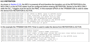

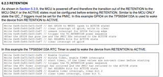

  • Hello Tanishq,
    I'll be referring to this User's Guide for the PMIC here, with software instructions necessary to wake from the GPIO_4 pin: https://www.ti.com/lit/ug/slvuci2/slvuci2.pdf?ts=1745475706576
    The above comes from the User's Guide.
    As for the software needed for the CAN controller running on the J7 side, Keerthy can make comments on that.
    BR,
    Nicholas
  • Hello Hello Nicholas McNamara,  Keerthy J,
    I have also referred the same user guide for S2R/Retention mode. I have followed the below listed same sequence of command to successfully transitioning into Suspend-to-RAM (S2R) mode.
    I would appreciate your assistance in wakeup from retention using GPIO_4 triggered by CAN WUP frame.
    Tanishq Kanungo

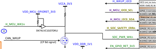

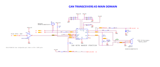

  • Hello Keerthy, Nicholas McNamara,
    We are currently trying to wakeup from the S2R mode via CAN. As a part of this, we have identified that the PMIC wake up signal is routed to GPIO_4 (LP_WKUP1). our understanding is that a signal edge toggle on GPIO_4 is required to trigger exit from DDR_RET and resume to Full Active mode. We have also confirmed that INH pin (CAN_WKUP) of the TCAN1043-Q1 transceivers is connected to GPIO_4. This setup allows us to use the CAN transceiver to generate the necessary edge signal. To wakeup from S2R we plan to send the Wakeup frame to the TCAN1043-Q1 transceiver.
    However, we observed that the MAIN_CAN3 interface, which is required to send the wakeup frame, is currently not enabled in the device driver. We would appreciate support in configuring the software stack to enable CAN-based wake-up.
    We would also like to request a call with TI team to discuss and for further analysis.
    Tanishq Kanungo.

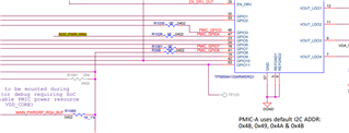

  • Hi Geoff,
    Also, would like to understand whether wakeup from S2R is possible on evalkit without any changes in PCB
    There are some hardware changes required, but no changes in PCB required. The changes required are :
     On PROC141E3 / J784S4XG01EVM and PROC141E4 / J784S4XG01EVM with these hardware changes:
    1. Mandatory: R658 moved to R659 (0 Ohm)
      1. Without this change, the board won't stay in suspend
    2. May not be necessary: Change R534 from pull-down to pull-up to VCCA_3V3 side of C320
    These changes are not the same for PROC141E2 / J784S4XG01EVM and PROC141E2A / J784S4XG01EVM.
    1. There will be additional changes required for the above boards which have not been worked out.
    2. There are two circuits driving the "SOC_PWR_WKn" signal in E3 and E4. This signal goes to PMIC and is required for waking up the SoC. Change 1 disables one of the circuit.
    One more thing to note would be that we have only verified wake from GPIO sources and not from TCAN signals. But in theory, if GPIO pins and TCAN's effect on SOC_PWR_WKn is same, there is no reason CAN shouldn't work.
    Tanmay

  • Hello @Tanmay,
    Sequence followed : Transceiver enters sleep state -> S2R activated.
    Observation: VCC_12V0 is turned off. Fan stops.
    • When S2R is performed after transceiver enters Sleep, Vcc_12V_0 is turned off(current consumption is reduced to zero with status LED active). Unable to do wakeup in this condition. (Wake pin is low). When SW15 is pressed current fan starts and current consumption rises to 0.3A.
    • When S2R is performed without transceiver entering sleep, current consumption is 0.3A VCC_12V_0 is active.
    Our intention is to wakeup the system from DDR retention to Active using CAN frame on MCAN3..  If R658 is removed, I guess it will not help in CAN based wakeup.
    Also, are you referring to Change 1 + usage of PB_CAN_WAKEn  Switch as GPIO wakeup which was verified.
    Geoff
  • Hi Geoff,
    What was verified was Change 1 + Change 1 +usage of SW15 to toggle PB_CAN_WAKEn which is inverted into SOC_PWR_WKn for wakeup signal
    Does PROC141E5/J784S4XG01EVM also require hardware changes?
    I will check this. But mostly yes, it also requires changes.
    Yes, removing R658 will not help in CAN based wake-up. You will have to attach R658 but remove U278/R1302. Then have the same behavior at SOC_PWR_WKn with CAN_WKUP.
    Tanmay
