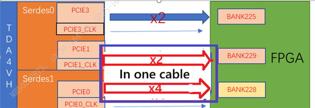

HW: TDA4VH , PCIEx4  connect FPGA,  FPGA read from TDA4VH 's DDR.  we test de best bandwith is 1.8GB/S .
1 . please, is there any problem ON  TDA4VH ?
2 . what is the MAX speed ON TDA4VH pciex4 ?

  • Hi ,
        Our test environment  is FPGA read data from J784S4  EVM's DDR driectlly, there are no software run on J784S4  EVM board, we only config pcie.
         Like  FPGA <==> 4VH PCIe controller <==> 4VH DDR , No software .  we want to know which is the bottleneck  ?  and the hardware design performance  upper limit?

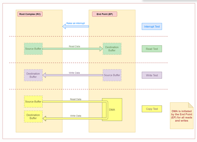

  • Hi Chen,
    Based on previous logs, my understanding is that J784S4 is configured as RC and FPGA is configured as EP. A read from FPGA EP will be a write from J784S4 RC perspective.
    For example, "Read Test" in below diagram that reads data from RC:
    Above example for Read Test from EP perspective will need a call to pci_endpoint_test_write from RC perspective.
    Takuma

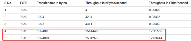

  • Hi Takuma,
    The numbers that we have are what was posted in April 17 on this thread.
    4 READ 1024000 1514445 12.11556
    5 READ 1024001 1504268 12.03414
    The max throughput in the table is 12Gbps at 4x lane, is it the best result already? can it be improved? customer think it should reach at least 2GByte/s which is 50% theoretical throughput. How do you think what is the max throughput can achieve and how to achieve with customer's use case.
    Your test result is even lower then my result , our test throughput is  1.34GB/s ~ 1.81GB/s. and we expect more than 2GB/s. can it be achieved and how? would you help to achieve it on your side with my use case?

  • Hi Tony,
    To add on to previous post, I have tested out the EP/RC test as well. I consistently get similar numbers (although, low, mainly because I think EP side has some other bottleneck and some dependency on DMA transfer speeds of J784S4).
    Test condition:
    • setenv optargs pci=pcie_bus_perf
    • pcitest -d -w -s 1024001 -D /dev/pci-endpoint-test.0
    • Single 4x lane, Gen 3 speeds
    • EP: J784S4 EVM, RC: AM69-SK - connected via PCIe cable
    Results:
    1. 1066000KB/s
    2. 1054000KB/s
    3. 1052000KB/s
    4. 1008000KB/s
    I think the SSD usecase in my previous response will be closer to customer usecase, since it is a TI SoC acting as RC connected to a non-TI off-the-shelf device acting as EP.
    Since there are errors reported in the error reporting registers, and a cable is in-use that will affect signal integrity, I will suggest doing a test with other devices like an off-the-shelf SSD card and see if they can also observe fluctuation in performance on other devices.
    Takuma

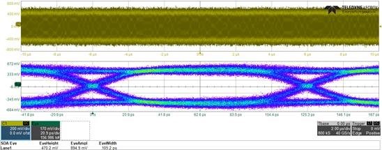

  • #1. There are eye diagram and connection information in this thread when debugging 8GT/s connection.
    https://e2e.ti.com/support/processors-group/processors/f/processors-forum/1536263/tda4vh-q1-serdes0-s-pcie1-pcie3-can-t-work-at-8gt-s#pifragment-323307=2
    eye diagram captured with oscilloscope:
    #2. The connection is over cable. The x2 and x4 shared one cable, but the x2 throughput is consistent.
  • Hi Tony,

    Using Samsung 970 EVO Plus, I see something similar as customer.
    Single x4 PCIe w/ Samsung 970 EVO Plus: around 2.5~2.6GB/s
    Single x2 PCIe w/ Samsung 970 PRO: around 1.5GB/s
    Both x2 PCIe and x4 PCIe with 970 PRO and 970 EVO Plus respectively: 1.5GB/s and 2.0GB/s respectively using fio.
    I remember you said UDMA channel priority. Is it related? and how to check?
    cat /sys/kernel/debug/dmaengine/summary - the first MEM-to-MEM DMA channel should use the UHC (Ultra High Capacity) DMA channel, while second is HC, and all other channels will use normal capacity channel.
    However, this is an optimization on the EP-side, not the RC-side. Meaning it is an optimization that must be done on the Xilinx FPGA-side, if the bottleneck is due to same reason as the Linux EP/RC example.
    Takuma
