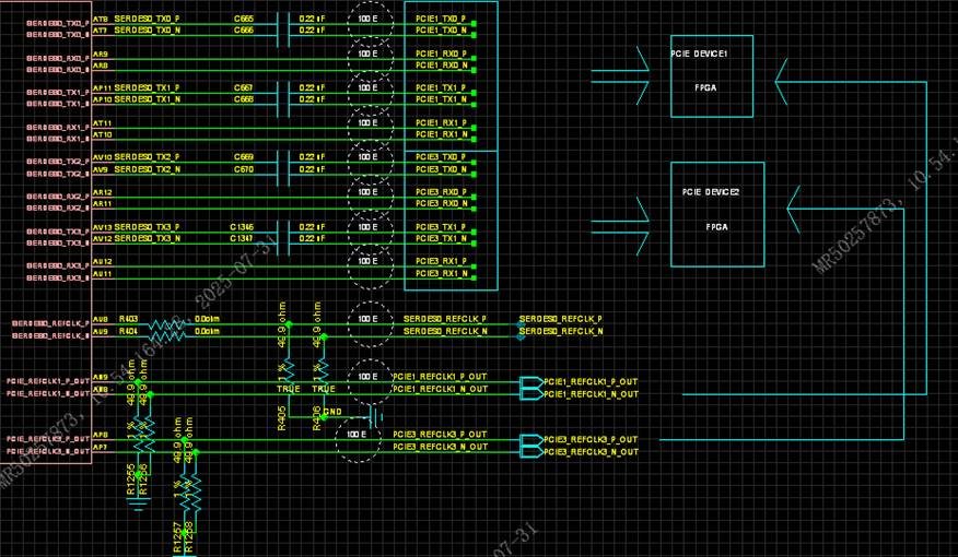

Our custom board PCIe Root configuration as below:
PCIE0  (SERDES1 LANE0 LANE1 LANE2 LANE3),
PCIE1 (SERDES0 LANE0/LANE1)
PCIE3 (SERDES0 LANE2/LANE3)
FPGA side 3 port are PCIe EP.

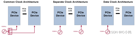

    Yes, SoC supports operating at 8GT/s at the same time on one Serdes0. However, there is errata i2242 that can potentially be hit by your FPGA: https://www.ti.com/lit/er/sprz536b/sprz536b.pdf?ts=1751914214523&ref_url=https%253A%252F%252Fwww.google.com%252F
    Takuma
  • hi ,
       what is the  " Received Refclk mode" ,how can we modify it? where can we find r errata advisory (i2241)?

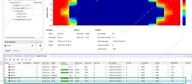

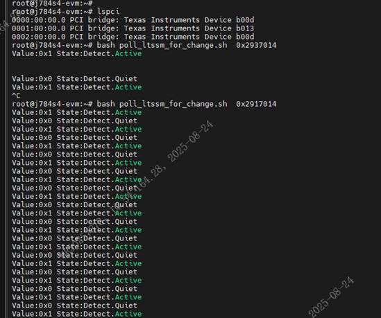

  • Dear expert:
      As i was asked before, the question that https://e2e.ti.com/support/processors-group/processors/f/processors-forum/1455878/tda4vh-q1-tda4vh-q1-serdes0-s-pcie1-pcie3-cannot-work-at-8gt-s-5gt-s
       Now the result seems my FPGA cannot accept early clock change,  I will keep tracking about this.
      also i have check Sk-AM69 design, can pcie1 (x2) & pcie3(x1) with two SSD , both work at 8GT?
      However,   the clock changed you memtioned,  Can i use scope to capture the pcie-ref-clock change on this change moment?  I have posted a test result on that link above.
    I have not seen myself, but based off of the errata description, there should be some change in clock that is observable.

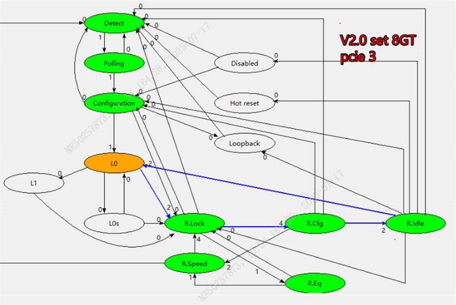

     If only connect PCIe and configure EP at 8GT/s, PCIe3 can be recognized but only run at 2.5GT/s.
    Can you clarify this statement? Is this experiment when only PCIe3 is connected, this PCIe3 device can only run at 2.5GT/s? This would be unexpected.
    Takuma
  • Can you clarify this statement? Is this experiment when only PCIe3 is connected, this PCIe3 device can only run at 2.5GT/s? This would be unexpected.
    yes, we comfirm that。
  • Hi Chen,
    If only PCIe3 is connected, it should not be affected by errata i2242. If it is only able to run at 2.5GT/s, this points to different issues.
    Can you send the full logs from "lspci -vvv" when only PCIe3 is connected?

  • Can i use scope to capture the pcie-ref-clock change on this change moment?
    Could you do this test and post the change of the PCIE_Refclk_OUT?

    We have use FPGA tool to debug about LTSSM :
    (1) V2.0 design: only connect to PCIE3 、SET FPGA 8GT ,  result: 2.5GT
    (2) V2.0 design only connect  PCIE3 、SET FPGA 5GT ,  result: 5GT
    (3) V1.0 hardware design connect to PCIE1 , set FPGA 8GT , result: PCIe 1 8GT    (because V1.0 ‘s hardware design pcie3 connect to i226)
    PS: all of the experiment is using the same FPGA device with the same hardware design , only with different speed.

     Does TDA4VH have any digital eye diagram tool? Beside, I have done the eye diagram test on FPGA, below are the result: seem two lane pcie3 on 2.5GTand 5GT are working fine.
    2.5GT: lane0 lane1
    5GT: lane0 lane 1

  • Hi expert Takuma
     As u can see from this state machine, there four times from r.speed to r.lock, it seems the traning process is not okay? Do u have any comment on this?
    The behavior will be described in PCI Express Base 4.0 Rev 0.3 documentation that you could get from PCI-SIG online. For specifics, I would recommend downloading and reading through the "4.2.6.4. Recovery" section.
    But to quote the relevant sections for LTSSM behavior, from Recovery.RcvrLock the
    "next state is Recovery.RcvrCfg if eight consecutive TS1 or TS2 Ordered Sets are received on all configured Lanes with the same Link and Lane numbers that match what is being transmitted on those same Lanes and the speed_change bit is equal to the directed_speed_change variable and the EC field is 00b in all the consecutive TS1 Ordered Sets if the current data rate is 8.0 GT/s or
    higher."
    And if it cannot enter RcvrCfg state, then to quote the specification documnetation again:
    "the next state is Recovery.Speed if the speed of operation has not changed to a
    mutually negotiated data rate since entering Recovery from L0 or L1 (i.e.,
    changed_speed_recovery = 0b) and the current speed of operation is greater than 2.5
    GT/s. The new data rate to operate after leaving Recovery.Speed will be at 2.5 GT/s.
    Note: This indicates that the Link was unable to operate at the current data rate (greater
    than 2.5 GT/s) and the Link will operate at the 2.5 GT/s data rate."
    So something is preventing link training to successfully change rate to 8.0 GT/s.
    I have a suspicion it still might be clock related (maybe there is some jitter from the internally generated clock). But, is it possible to see if you can do some board modifications to hook up an external clock generator for the PCIe reference clock as an experiment?
    Takuma

    3、  another question about pcie clock choosing:
      On tda4vh's TRM, at page1521,table 12-202 serdes acspcie reference clock selection , as i know 0x1 is using 4VH's internal pll to get 100M, about 0x0 0x2 and 0x3 what's that for?
     4、can i use outside serdes-reclk-p/n for 4vh's pcie core's pcie_refclk_p/n_out to form a Common clock architechture?
  • Hi Sai,
    If you can do some board modifications to hook up an external clock generator, then 1 and 4 can be done.
    For 2, I would advise creating a separate E2E thread which can be assigned to our hardware team.
    For 3,  0x0 is ref_der_out_clk signal from serdes wiz wrapper, 0x1 is from the PLL, 0x2 is ref_out_clk signal from serdes wiz wrapper and 0x3 is tied to 0 (no signal).
    Takuma

    Could we get a snapshot of your schematics showing how the PCIe reference clock was connected when the internal reference clock was used, and also the new configuration with the external clock generator?
    Takuma

  • Hello Takuma:
       I want to correct my expression.
       PCIE1 and PCIe3 still can't be detected at the same time .
        I have to  try  the  external generator separately to PCIe1 and PCIe3 because it cannot be detected at the same time.
    (1)  My original PCIE schematics:
    (2) The external CLK generator schematics and test diagram:
    (3) Here is the dts file for our board, we used it for both external and internal reference clock, don't know how to configure it to use external reference clock.

    3. When using the external clk generator to PCIe1 and PCIe3, I think the PCIE3's configuration should be checked.
  • Hi Sai,
    When using internal clock, CTRLMMR_PCIE_REFCLK3_CLKSEL should have 0x101, similar to REFCLK1 and REFCLK3. Otherwise, the PCIe3 related CTRLMMR registers look good.

        When using internal clock,here is the output of bashing the script:
    root@j784s4-evm:~# bash dump_pcie_ctrlmmr_register_j784s4.sh
    //// Starting register dump ////
    CTRLMMR_PCIE0_CTRL at addr 0x00104070 is 0x00000382
    CTRLMMR_PCIE1_CTRL at addr 0x00104074 is 0x00000182
    CTRLMMR_PCIE2_CTRL at addr 0x00104078 is 0x00000002
    CTRLMMR_PCIE3_CTRL at addr 0x0010407C is 0x00000182
    CTRLMMR_PCIE_REFCLK0_CLKSEL at addr 0x00108070 is 0x00000101
    CTRLMMR_PCIE_REFCLK1_CLKSEL at addr 0x00108074 is 0x00000101
    CTRLMMR_PCIE_REFCLK2_CLKSEL at addr 0x00108078 is 0x00000100
    CTRLMMR_PCIE_REFCLK3_CLKSEL at addr 0x0010807C is 0x00000101
    CTRLMMR_ACSPCIE0_CTRL at addr 0x00118090 is 0x01000000
    CTRLMMR_ACSPCIE1_CTRL at addr 0x00118094 is 0x01000000
    CTRL_MMR_CFG0_SERDES0_LN0_CTRL at addr 0x00104080 is 0x00000001
    CTRL_MMR_CFG0_SERDES0_LN1_CTRL at addr 0x00104084 is 0x00000001
    CTRL_MMR_CFG0_SERDES0_LN2_CTRL at addr 0x00104088 is 0x00000000
    CTRL_MMR_CFG0_SERDES0_LN3_CTRL at addr 0x0010408C is 0x00000000
    CTRL_MMR_CFG0_SERDES1_LN0_CTRL at addr 0x00104090 is 0x00000001
    CTRL_MMR_CFG0_SERDES1_LN1_CTRL at addr 0x00104094 is 0x00000001
    CTRL_MMR_CFG0_SERDES1_LN2_CTRL at addr 0x00104098 is 0x00000001
    CTRL_MMR_CFG0_SERDES1_LN3_CTRL at addr 0x0010409C is 0x00000001
    CTRL_MMR_CFG0_SERDES2_LN0_CTRL at addr 0x001040A0 is 0x00000000
    CTRL_MMR_CFG0_SERDES2_LN1_CTRL at addr 0x001040A4 is 0x00000000
    CTRL_MMR_CFG0_SERDES2_LN2_CTRL at addr 0x001040A8 is 0x00000002
    CTRL_MMR_CFG0_SERDES2_LN3_CTRL at addr 0x001040AC is 0x00000002
    //// Ending register dump ////
    root@j784s4-evm:~#
  • Hi Sai,
    That register dump looks good.
    So far, the information provided looks to indicate a failure during the Recovery.Equalization phase, and most likely during Phase 1 of Equalization. This would explain why 5GT/s and 2.5GT/s work, while 8GT/s downgrades to 2.5GT/s. This is because 5 and 2.5GT/s do not require link equalization, while 8GT/s will require link equalization and will downgrade to 2.5GT/s if equalization phase fails.
    Below is from the PCI Express Base 4.0 Rev0.3 specification documentation from PCI-SIG:
    From the LTSSM graphs shared in the past, we can see that R.Eq goes to R.Speed state instead of R.Lock
    And output from lspci -vvv indicates EqualizationPhase1 bit did not get set:
    LnkSta2: Current De-emphasis Level: -3.5dB, EqualizationComplete- EqualizationPhase1-
    EqualizationPhase2- EqualizationPhase3- LinkEqualizationRequest-
    Retimer- 2Retimers- CrosslinkRes: unsupported
    So, the receiver did not recognize the two consecutive TS1 Ordered Sets sent by transmitter.
    Is it possible to test your TDA4VH board with a different PCIe 3.0 device to see if the issue is on the FPGA-side or the TDA4VH-side?
    Takuma
  • Hi expert Takuma:
        1)I shared one test to make PCIE1 and PCIE3 to make a PCIE1 x4lane which can be detected at 8GT at current V2.0 board: VH side hardware SI should be good.
       2)I have test with the same FPGA's port with my V1.0 TDA4VH's custom board which is PCIe2(serdes1 lane2 and lane3), which can go to 8GT: FPGA side is good.
       To sum up, I think that the FPGA side should be OK, otherwise my V1.0's board should not be detected at 8GT with V1.0 VH board PCIe port 2. Now only PCIe3 2xLane mode is not specifically verified with TDA4VH.
      My PCIe port is not standard slot, it's a special port ,  I need to fly wire to another PCIe device board for testing, it’s extremely hard to ensure SI.
      if so, could you use AM69-SK board to connect one FPGA demo board to test on my scenario?
  • This question was not answered directly.  update here:
    Is the FPGA on PCIe3 the same as the FPGA on PCIe1?
    The block diagram.  The same FPGA board GEth2 connects with TDA4VH V1.0 board PCIe port 2 works fine. so the FPGA side is okay.

      I have test more to check if pcie_clk is okay or not.
      I exchange PCIE1_REFCLK_OUT and PCIE3_REFCLK_OUT to device on the cable. the result is below. and I think this should confirm that pcie3_refclk_out jitter is satisfied for device . and PCIE3's config is not okay.

    Is there a way to check why link equalization is failing at your end? Like a PCIe protocol analyzer?
    Takuma
     Is there any status register that we can check why this is failed on 4VH?   Beside,I will try to fink PCIe protocol analyzer.

    This goes down a separate path than receiving an external reference clock to drive SerDes module.
    If wanting to select external reference clock for receiving an external reference clock to SerDes, it should correspond to "ext_ref_clk" in devicetree. Although, even without selecting, the clock configuration would be like in "Separate Clock Architecture". And as you have experimented, with external clock PCIe1 was successfully linking up to 8.0GT/s.
     Dose your am69-board use  "Separate Clock Architecture"?  or  you have configure the "ext_ref_clk"?
    I am using default devicetree for SK-AM69. By default, serdes0 uses "core_ref_clk". However, board itself routes external clock generator to refclk of SerDes and PCIe connector, so it is essentially a separate clock architecture.
