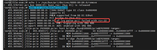

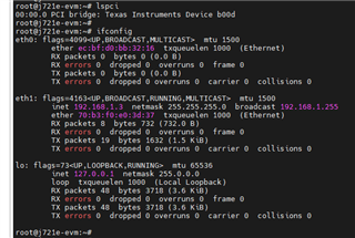

  I added PCIE configuration in Linux and used the lspci command to output the following content after startup:
But when I use the following command, it seems to report a failed issue:
Is there any configuration issue that caused this error? I understand that after the configuration is completed and the driver is loaded, lspci can recognize two nodes
Yang
  • Hi Yang,
    'of_irq_parse_pci: failed with rc=-22' can be ignored. Functionally, this should not cause any issues.
    However, if you would like to remove the error, below is the patch that will be integrated into the next release of the SDK:
    https://patchwork.kernel.org/project/linux-pci/patch/20240726135903.1255825-1-s-vadapalli@ti.com/

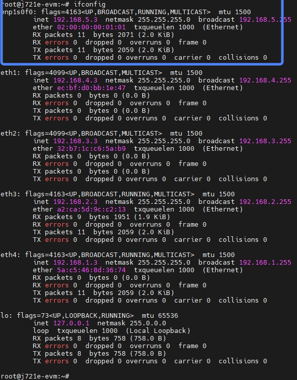

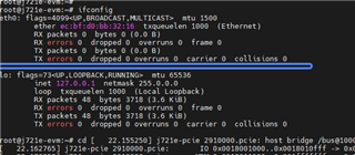

      We are now connecting TDA4 and MVL's Switch through PCIE. After configuring the device tree content, lspci can see a node, then move it into MVL's Driver and generate ". ko" to manually execute insmod. How should I verify its successful connection? Can lspci see an additional node?

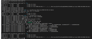

      Besides, I have another question. I am using Seder3, but if I execute the following command and the log is the address of Seder2 pcie2920000, why is that?
    echo 1 > /sys/bus/pci/devices/0000:00:00.0/remove
    echo 1 > /sys/bus/pci/rescan
    Yang

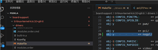

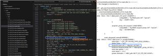

        Today I made some new modifications and tests. I tried to bind the PCIE driver to the newly added MVL driver.
    • Firstly, I added an obj-m in Linux, placed the MVL driver under Driver and generated a. ko file. Then, I copied the file into the board and manually executed the insmo command to load it.
    • Check the current PCIe kernel driver and confirm it as PCIe port:
    • Next, execute the following command to attempt to bind PCIE with MVL driver, but the result is an error:
     echo 0000:00:00.0 >  /sys/bus/pci/drivers/pcieport/unbind
     echo  0000:00:00.0  > /sys/bus/pci/drivers/622X/bind
    • After querying, it was found that the device ID was not recognized, so the ID in the device tree pcie3_rc was modified as shown in the following figure:
    • After recompiling and re executing the above steps, an error was found as shown in the following figure:
    I have the following questions that I would like to know:
    1. Should I modify the current PCIE binding kernel driver when using an external switch?
    2. If the first question is necessary, are the above steps correct?
    3. How should the errors reported above be resolved?
    4. After completing all configurations, should PCIE generate an ETH node similar to the one shown in the following figure?
    5. I understand that I have already completed the generation of PCIE nodes. Can you provide a complete explanation on how to match external switch chips and what needs to be configured?
    Yang

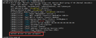

    root@j721e-evm:~# lspci -vvv -s 0000:00:00.0

            Kernel driver in use: pcieport
    root@j721e-evm:~#

  • Hi Yang,
    A lot of questions, so I will divide my response into two posts. First post is directly answering the questions and analysis of behavior being observed. Second post will be what I suspect is happening and where to check.
    This should not happen if what you say is true and PCIe3 is used. It looks like software-wise, PCIe2 is enabled instead of PCIe3.
    Manually binding the kernel module is an option. General method of unbinding/binding is correct, but I think you are binding the driver to the PCIe port instead of the switch device.
    For example, this is what would be expected on TDA4VH (which should be same as TDA4VM) when a NVMe SSD card is connected to the port:

    01:00.0 Non-Volatile memory controller: Samsung Electronics Co Ltd NVMe SSD Controller SM981/PM981/PM983 (prog-if 02 [NVM Express])
            Subsystem: Samsung Electronics Co Ltd NVMe SSD Controller SM981/PM981/PM983 (SSD 970 EVO Plus 1TB)
            Control: I/O- Mem+ BusMaster+ SpecCycle- MemWINV- VGASnoop- ParErr- Stepping- SERR- FastB2B- DisINTx+
            Status: Cap+ 66MHz- UDF- FastB2B- ParErr- DEVSEL=fast >TAbort- <TAbort- <MAbort- >SERR- <PERR- INTx-
            Latency: 0
            Interrupt: pin A routed to IRQ 0
            Region 0: Memory at 10100000 (64-bit, non-prefetchable) [size=16K]
            Capabilities: [40] Power Management version 3
                    Flags: PMEClk- DSI- D1- D2- AuxCurrent=0mA PME(D0-,D1-,D2-,D3hot-,D3cold-)
                    Status: D0 NoSoftRst+ PME-Enable- DSel=0 DScale=0 PME-
            Capabilities: [50] MSI: Enable- Count=1/1 Maskable- 64bit+
                    Address: 0000000000000000  Data: 0000
            Capabilities: [70] Express (v2) Endpoint, MSI 00
                    DevCap: MaxPayload 256 bytes, PhantFunc 0, Latency L0s unlimited, L1 unlimited
                            ExtTag- AttnBtn- AttnInd- PwrInd- RBE+ FLReset+ SlotPowerLimit 0.000W
                    DevCtl: CorrErr+ NonFatalErr+ FatalErr+ UnsupReq+
                            RlxdOrd+ ExtTag- PhantFunc- AuxPwr- NoSnoop+ FLReset-
                            MaxPayload 128 bytes, MaxReadReq 512 bytes
                    DevSta: CorrErr- NonFatalErr- FatalErr- UnsupReq- AuxPwr- TransPend-
                    LnkCap: Port #0, Speed 8GT/s, Width x4, ASPM L1, Exit Latency L1 <64us
                            ClockPM+ Surprise- LLActRep- BwNot- ASPMOptComp+
                    LnkCtl: ASPM Disabled; RCB 64 bytes, Disabled- CommClk-
                            ExtSynch- ClockPM- AutWidDis- BWInt- AutBWInt-
                    LnkSta: Speed 8GT/s (ok), Width x4 (ok)
                            TrErr- Train- SlotClk+ DLActive- BWMgmt- ABWMgmt-
                    DevCap2: Completion Timeout: Range ABCD, TimeoutDis+ NROPrPrP- LTR+
                             10BitTagComp- 10BitTagReq- OBFF Not Supported, ExtFmt- EETLPPrefix-
                             EmergencyPowerReduction Not Supported, EmergencyPowerReductionInit-
                             FRS- TPHComp- ExtTPHComp-
                             AtomicOpsCap: 32bit- 64bit- 128bitCAS-
                    DevCtl2: Completion Timeout: 50us to 50ms, TimeoutDis- LTR+ [   17.128657] platform 2910000.pcie: deferred probe pending
    OBFF Disabled,
                             AtomicOpsCtl: ReqEn-
                    LnkCap2: Supported L[   17.135150] platform 6000000.usb: deferred probe pending
    ink Speeds: 2.5-8GT/s, Crosslink- Retimer- 2Retimers- DRS-
                    LnkCtl2: Target Link Speed: 8GT/s, EnterCompliance- SpeedDis-
                             Transmit Margin: Normal Operating Range, EnterModifiedCompliance- ComplianceSOS-
                             Compliance De-emphasis: -6dB
                    LnkSta2: Current De-emphasis Level: -6dB, EqualizationComplete+ EqualizationPhase1+
                             EqualizationPhase2+ EqualizationPhase3+ LinkEqualizationRequest-
                             Retimer- 2Retimers- CrosslinkRes: unsupported
            Capabilities: [b0] MSI-X: Enable+ Count=33 Masked-
                    Vector table: BAR=0 offset=00003000
                    PBA: BAR=0 offset=00002000
            Capabilities: [100 v2] Advanced Error Reporting
                    UESta:  DLP- SDES- TLP- FCP- CmpltTO- CmpltAbrt- UnxCmplt- RxOF- MalfTLP- ECRC- UnsupReq- ACSViol-
                    UEMsk:  DLP- SDES- TLP- FCP- CmpltTO- CmpltAbrt- UnxCmplt- RxOF- MalfTLP- ECRC- UnsupReq- ACSViol-
                    UESvrt: DLP+ SDES+ TLP- FCP+ CmpltTO- CmpltAbrt- UnxCmplt- RxOF+ MalfTLP+ ECRC- UnsupReq- ACSViol-
                    CESta:  RxErr- BadTLP- BadDLLP- Rollover- Timeout- AdvNonFatalErr-
                    CEMsk:  RxErr- BadTLP- BadDLLP- Rollover- Timeout- AdvNonFatalErr+
                    AERCap: First Error Pointer: 00, ECRCGenCap+ ECRCGenEn- ECRCChkCap+ ECRCChkEn-
                            MultHdrRecCap+ MultHdrRecEn- TLPPfxPres- HdrLogCap-
                    HeaderLog: 00000000 00000000 00000000 00000000
            Capabilities: [148 v1] Device Serial Number 00-00-00-00-00-00-00-00
            Capabilities: [158 v1] Power Budgeting <?>
            Capabilities: [168 v1] Secondary PCI Express
                    LnkCtl3: LnkEquIntrruptEn- PerformEqu-
                    LaneErrStat: 0
            Capabilities: [188 v1] Latency Tolerance Reporting
                    Max snoop latency: 0ns
                    Max no snoop latency: 0ns
            Capabilities: [190 v1] L1 PM Substates
                    L1SubCap: PCI-PM_L1.2+ PCI-PM_L1.1+ ASPM_L1.2+ ASPM_L1.1+ L1_PM_Substates+
                              PortCommonModeRestoreTime=10us PortTPowerOnTime=10us
                    L1SubCtl1: PCI-PM_L1.2- PCI-PM_L1.1- ASPM_L1.2- ASPM_L1.1-
                               T_CommonMode=0us LTR1.2_Threshold=287744ns
                    L1SubCtl2: T_PwrOn=26us
            Kernel driver in use: nvme
            Kernel modules: nvme
    root@j784s4-evm:~#
    In above, there is a "PCI bridge" device and a "Non-Volatile memory controller" device in lspci logs. The bridge should be left untouched, and the kernel module should be bound to the device that shows up under the bridge (which is not showing).
    As a side note, the kernel module should automatically bind to the correct PCIe device using the device and vendor ID, assuming the kernel module is loaded on boot. So the manual binding method is an alternative method that usually should not be needed, unless you are developing a new kernel module from scratch or it is a demo kernel module that doesn't bind automatically.
    Error 22 points to invalid argument. This is most likely due to binding to the wrong device.
    Yes, kernel module driver should enumerate under ifconfig. I have not looked at this particular driver before, but all PCIe ethernet switch drivers I have seen have done so.
    Takuma
  • What I suspect is happening is that the wrong PCIe instance is being configured in devicetree based on below statement.
    1. Can you share the devicetree file for your board?
    2. Can you share the full logs from "dmesg"?
    3. I plan to look through the devicetree to see if anything is wrong, but in case you also would like to check, the following needs to be set up to use pcie3:
      1. serdes_ln_ctrl node should be updated the two SERDES3 lanes to PCIe starting line 509: https://git.ti.com/cgit/ti-linux-kernel/ti-linux-kernel/tree/arch/arm64/boot/dts/ti/k3-j721e-common-proc-board.dts?h=ti-linux-6.6.y#n509
      2. serdes3 node should update phy-type to PCIe. "assigned-clocks" and "assigned-clock-parents" may need updates as well starting line 523: https://git.ti.com/cgit/ti-linux-kernel/ti-linux-kernel/tree/arch/arm64/boot/dts/ti/k3-j721e-common-proc-board.dts?h=ti-linux-6.6.y#n523. Serdes0, 1, and 2 for the default EVM devicetree can be referenced
      3. pcie3_rc needs to be enabled. Reference pcie0/1/2_rc nodes starting line 931: https://git.ti.com/cgit/ti-linux-kernel/ti-linux-kernel/tree/arch/arm64/boot/dts/ti/k3-j721e-common-proc-board.dts?h=ti-linux-6.6.y#n931
        1. Make sure phys property is updated to the node name under serdes3 that you create in step 3.b.
        2. Make sure reset-gpios property is set to the reset pin designed on your custom board.
    In any case, if you can do 1 and 2, I can check the devicetree for the things I listed in step 3 above.
    Takuma
    •     The following. diff file contains the modifications I made in DTS.
    diff --git a/psdkla/board-support/ti-linux-kernel-6.6.32+git-ti/arch/arm64/boot/dts/ti/k3-j721e-common-proc-board.dts b/psdkla/board-support/ti-linux-kernel-6.6.32+git-ti/arch/arm64/boot/dts/ti/k3-j721e-common-proc-board.dts
    index dcab2c6b3..850b526de 100644
    --- a/psdkla/board-support/ti-linux-kernel-6.6.32+git-ti/arch/arm64/boot/dts/ti/k3-j721e-common-proc-board.dts
    +++ b/psdkla/board-support/ti-linux-kernel-6.6.32+git-ti/arch/arm64/boot/dts/ti/k3-j721e-common-proc-board.dts
    @@ -436,7 +436,6 @@ J721E_WKUP_IOPAD(0xc8, PIN_INPUT, 7) /* (F29) WKUP_GPIO0_6 */
     	// add
     	mcu_rgmii1_pins_default: mcu-rgmii1-default-pins {
     		pinctrl-single,pins = <
    @@ -595,27 +594,30 @@ &serdes_ln_ctrl {
     	idle-states = <J721E_SERDES0_LANE0_QSGMII_LANE1>, <J721E_SERDES0_LANE1_QSGMII_LANE2>,
     		      <J721E_SERDES1_LANE0_QSGMII_LANE3>, <J721E_SERDES1_LANE1_QSGMII_LANE4>,
     		      <J721E_SERDES2_LANE0_PCIE2_LANE0>, <J721E_SERDES2_LANE1_PCIE2_LANE1>,
    -		      <J721E_SERDES3_LANE0_USB3_0_SWAP>, <J721E_SERDES3_LANE1_USB3_0>,
    +		      <J721E_SERDES3_LANE0_PCIE3_LANE0>, <J721E_SERDES3_LANE1_PCIE3_LANE1>,
     		      <J721E_SERDES4_LANE0_EDP_LANE0>, <J721E_SERDES4_LANE1_EDP_LANE1>,
     		      <J721E_SERDES4_LANE2_EDP_LANE2>, <J721E_SERDES4_LANE3_EDP_LANE3>;
    -&serdes_wiz3 {
    -	typec-dir-gpios = <&main_gpio1 3 GPIO_ACTIVE_HIGH>;
    -	typec-dir-debounce-ms = <700>;	/* TUSB321, tCCB_DEFAULT 133 ms */
    +/* delete for PCIE */
    +// &serdes_wiz3 {
    +// 	typec-dir-gpios = <&main_gpio1 3 GPIO_ACTIVE_HIGH>;
    +// 	typec-dir-debounce-ms = <700>;	/* TUSB321, tCCB_DEFAULT 133 ms */
     &serdes3 {
    -	serdes3_usb_link: phy@0 {
    +	assigned-clocks = <&serdes3 CDNS_SIERRA_PLL_CMNLC>;
    +	assigned-clock-parents = <&wiz3_pll1_refclk>;
    +	serdes3_pcie_link: phy@0 {
     		reg = <0>;
     		cdns,num-lanes = <2>;
     		#phy-cells = <0>;
    -		cdns,phy-type = <PHY_TYPE_USB3>;
    +		cdns,phy-type = <PHY_TYPE_PCIE>;
     		resets = <&serdes_wiz3 1>, <&serdes_wiz3 2>;
     &ospi0 {
     	status = "okay";
     	flash@0 {
    @@ -898,6 +900,14 @@ &pcie2_rc {
     	num-lanes = <2>;
    +&pcie3_rc {
    +	status = "okay";
    +	//reset-gpios = <&exp2 20 GPIO_ACTIVE_HIGH>;
    +	phys = <&serdes3_pcie_link>;
    +	phy-names = "pcie-phy";
    +	num-lanes = <2>;
     #define K3_TS_OFFSET(pa, val)	(0x4+(pa)*4) (0x10000 | val)
     &timesync_router {
    diff --git a/psdkla/board-support/ti-linux-kernel-6.6.32+git-ti/arch/arm64/boot/dts/ti/k3-j721e-main.dtsi b/psdkla/board-support/ti-linux-kernel-6.6.32+git-ti/arch/arm64/boot/dts/ti/k3-j721e-main.dtsi
    index 0fcabb629..706ca1269 100644
    --- a/psdkla/board-support/ti-linux-kernel-6.6.32+git-ti/arch/arm64/boot/dts/ti/k3-j721e-main.dtsi
    +++ b/psdkla/board-support/ti-linux-kernel-6.6.32+git-ti/arch/arm64/boot/dts/ti/k3-j721e-main.dtsi
    @@ -1054,14 +1054,14 @@ pcie3_rc: pcie@2930000 {
     		#address-cells = <3>;
     		#size-cells = <2>;
     		bus-range = <0x0 0xff>;
    -		vendor-id = <0x104c>;
    -		device-id = <0xb00d>;
    +		vendor-id = <0x11AB>;
    +		device-id = <0xabcd>;
     		msi-map = <0x0 &gic_its 0x30000 0x10000>;
     		dma-coherent;
     		ranges = <0x01000000 0x0 0x00001000 0x44 0x10001000 0x0 0x0010000>,
     			 <0x02000000 0x0 0x00011000 0x44 0x10011000 0x0 0x7fef000>;
     		dma-ranges = <0x02000000 0x0 0x0 0x0 0x0 0x10000 0x0>;
    -		status = "disabled";
    +		status = "okay";
     	serdes_wiz4: wiz@5050000 {
    diff --git a/psdkla/board-support/ti-u-boot-2024.04+git/configs/j721e_evm_a72_defconfig b/psdkla/board-support/ti-u-boot-2024.04+git/configs/j721e_evm_a72_defconfig
    index 5b74aea68..1553c1915 100644
    --- a/psdkla/board-support/ti-u-boot-2024.04+git/configs/j721e_evm_a72_defconfig
    +++ b/psdkla/board-support/ti-u-boot-2024.04+git/configs/j721e_evm_a72_defconfig
    @@ -16,7 +16,7 @@ CONFIG_DM_GPIO=y
     CONFIG_SPL_DM_SPI=y
     CONFIG_DEFAULT_DEVICE_TREE="k3-j721e-common-proc-board"
     CONFIG_SPL_TEXT_BASE=0x80080000
    -CONFIG_OF_LIBFDT_OVERLAY=y
    +#CONFIG_OF_LIBFDT_OVERLAY=y
     CONFIG_DM_RESET=y
     CONFIG_SPL_MMC=y
     CONFIG_SPL_SERIAL=y
    •     In order to ensure that the driver for the corresponding switch is automatically loaded at startup, do I need to make any other modifications to the obj-y file in the Makefile shown below?
    • When I look at the device nodes in the/sys/bus/pci/devices path, I can see that it is linked to PCIE3. When I reload, I can also see that it is PCIE3, but when I reload, the log prints 2920000
    Yang
    I just changed the driver in Makefile to automatically load obj-y, and even after testing again, there is still only one PCIE node.
    Yang

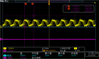

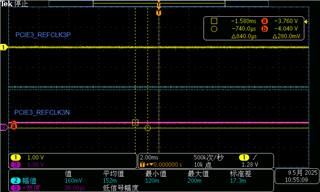

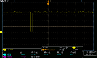

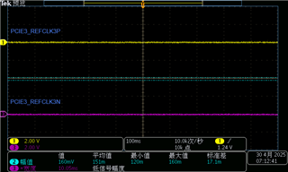

    I detected the PCIE3-REFCLK signal through an oscilloscope and found no waveform.
    Yang

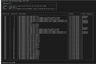

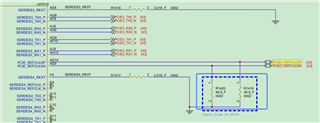

    This is the issue. Could be a couple of reasons why it is not outputting a reference clock. For starters, could you try applying this patch:

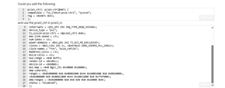

    https://e2e.ti.com/cfs-file/__key/communityserver-discussions-components-files/791/0001_2D00_define_2D00_pcie_5F00_refclk_2D00_in_2D00_devicetree_2D00_for_2D00_PCIe3.patch

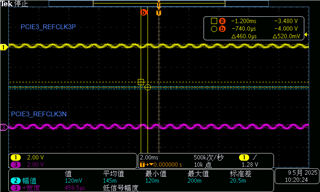

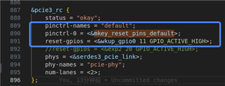

      Sorry for the late reply. I have blocked PCIE0/1/2 nodes in the device tree and added the patch you provided, but there is still no PCIE.CLK generated during testing.
    The following patches are the modifications I made:

    [    2.544822] j721e-pcie 2930000.pcie: PCI host bridge to bus 0000:00
    [    2.551108] pci_bus 0000:00: root bus resource [bus 00-ff]
    [    2.556585] pci_bus 0000:00: root bus resource [io  0x0000-0xffff] (bus address [0x1000-0x10fff])
    [    2.565439] pci_bus 0000:00: root bus resource [mem 0x4410011000-0x4417ffffff] (bus address [0x00011000-0x07ffffff])
    [    2.575960] pci 0000:00:00.0: [104c:b00d] type 01 class 0x060400
    [    2.581954] pci_bus 0000:00: 2-byte config write to 0000:00:00.0 offset 0x4 may corrupt adjacent RW1C bits
    [    2.591657] pci 0000:00:00.0: supports D1
    [    2.595656] pci 0000:00:00.0: PME# supported from D0 D1 D3hot
    [    2.603207] pci 0000:00:00.0: bridge configuration invalid ([bus 00-00]), reconfiguring
    [    2.611305] pci_bus 0000:01: busn_res: [bus 01-ff] end is updated to 01
    [    2.617921] pci 0000:00:00.0: PCI bridge to [bus 01]
    [    2.622959] pcieport 0000:00:00.0: of_irq_parse_pci: failed with rc=-22
    [    2.629785] pcieport 0000:00:00.0: PME: Signaling with IRQ 482
    [    2.635793] pcieport 0000:00:00.0: AER: enabled with IRQ 482

  • Hi Yang,
    Could you try applying this patch:
    https://e2e.ti.com/cfs-file/__key/communityserver-discussions-components-files/791/0001_2D00_Add_2D00_ACSPCIE_2D00_buffer_2D00_control_2D00_for_2D00_enabling_2D00_clock_2D00_buffer.patch
    Takuma
    0001-Add-ACSPCIE-buffer-control-for-enabling-clock-buffer.patch
    I have tried this patch, but there is still no CLK waveform. However, I have noticed that there are some differences between this patch and my current device tree, and I am not sure if it will have any impact. As shown in the following figure:
    In addition, I have noticed that there is a connection in the schematic diagram for CLK as shown in the figure below. I would like to know if this will affect its functionality?
    Yang

    Could you add the following:
    pcie3_ctrl: pcie3-ctrl@407c {
    compatible = "ti,j784s4-pcie-ctrl", "syscon";
    reg = <0x407c 0x4>;
    and use the pcie3_ctrl in pcie3_rc:
    compatible = "ti,j721e-pcie-host";
    reg = <0x00 0x02930000 0x00 0x1000>,
    <0x00 0x02937000 0x00 0x400>,
    <0x00 0x0e800000 0x00 0x00800000>,
    <0x44 0x10000000 0x00 0x00001000>;
    reg-names = "intd_cfg", "user_cfg", "reg", "cfg";
    interrupt-names = "link_state";
    interrupts = <GIC_SPI 354 IRQ_TYPE_EDGE_RISING>;
    device_type = "pci";
    ti,syscon-pcie-ctrl = <&pcie3_ctrl 0x0>;
    max-link-speed = <3>;
    num-lanes = <2>;
    power-domains = <&k3_pds 242 TI_SCI_PD_EXCLUSIVE>;
    clocks = <&k3_clks 242 1>, <&serdes3 CDNS_SIERRA_PLL_CMNLC>;
    clock-names = "fck", "pcie_refclk";
    #size-cells = <2>;
    dma-coherent;
    This looks good.

    I have tested the following modifications here, but there is still no CLK signal generated.
    Yang

      1、I modified serdes3 in the k3-j721e-evm-ethfw.dtso file to PCIE, and opened the OF_LIBFT_SVERLAY macro definition, which can also generate PCIE device nodes and ETH nodes normally.
    This. diff file is my modified content:

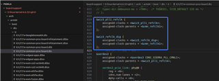

    -&wiz0_pll1_refclk {
    -	assigned-clocks = <&wiz0_pll1_refclk>;
    -	assigned-clock-parents = <&cmn_refclk1>;
    -	status = "disabled";/*disable serdes for cpsw9g*/
    -&wiz0_refclk_dig {
    -	assigned-clocks = <&wiz0_refclk_dig>;
    +// &wiz0_pll1_refclk {
    +// 	assigned-clocks = <&wiz0_pll1_refclk>;
    +// 	assigned-clock-parents = <&cmn_refclk1>;
    +// 	status = "disabled";/*disable serdes for cpsw9g*/

    +&pcie3_rc {
    +	status = "okay";
    +	pinctrl-names = "default";
    +	pinctrl-0 = <&mkey_reset_pins_default>;
    +	reset-gpios = <&wkup_gpio0 11 GPIO_ACTIVE_HIGH>;
    +	num-lanes = <2>;

    diff --git a/psdkla/board-support/ti-linux-kernel-6.6.32+git-ti/drivers/Makefile b/psdkla/board-support/ti-linux-kernel-6.6.32+git-ti/drivers/Makefile
    index 1bec7819a..4470f6fad 100644
    --- a/psdkla/board-support/ti-linux-kernel-6.6.32+git-ti/drivers/Makefile
    +++ b/psdkla/board-support/ti-linux-kernel-6.6.32+git-ti/drivers/Makefile
    @@ -23,6 +23,7 @@ obj-$(CONFIG_GPIOLIB)		+= gpio/
     obj-y				+= pwm/
     obj-y				+= pci/
    +obj-y				+= nogpl/
     obj-$(CONFIG_PARISC)		+= parisc/
     obj-$(CONFIG_RAPIDIO)		+= rapidio/
    And I found that after opening the macro definition OF_LIBFT_SVERLAY, I cannot remove the generated PCIE device node anymore, which will cause the system to
    freeze, as shown in the following figure:
      2、In addition, I found a previous post about PCIE CLK:
    https://e2e.ti.com/support/processors-group/processors/f/processors-forum/1004565/faq-tda4vm-tda4vm-dra829v-routing-pcie-reference-clock-externally
    I tried to read the above two registers and found that the value of 0x00118094 did not match the expected value. So, I modified its value to 0x01000000
    and found that there was a slight change in the level of CLK.
    Then  I merged the 0001-PCIe-internal-refclk-patches-for-8.6-SDK-on-TDA4VM-J.patch  in the post into the current code and measured the waveform as
    Is the above picture a normal CLK waveform? Their voltage values appear to be only 300mV, and they have not yet been able to generate PCIE ETH
    nodes.
    Yang
  • Hi Yang,
    For your point 1, it is strange that you cannot remove the controller any more. However, it is good to see that the eth interfaces are all coming up.
    • With the new changes, do you still see the PCIe controller under lspci?
    • And can you share the output from "dmesg" again?
    For your point 2, it looks like there is now some clock going out. This is good.
    • Can you now check the PERST# (PCIe reset) signal with a multimeter (or scope) to see if this is getting de-asserted?
    Takuma

    I configured and measured the MVL_PACIE-RST pin as follows,this pin generated a 2.4ms pull low and remained high thereafter,but still did not generate
    a new ETH node.
    nodes.
    I want to know if this waveform solves the problem of no CLOCK? What aspect of content should we investigate now?
    Yang
    nodes.
      There is a problem when generating the waveform here, which is that even after inserting the patch, I still manually modified the register 0x00118094 after
    power on to change it.
    Yang
  • Hi Yang,
    I am talking with hardware team for the waveform.
    Feedback from hardware team is that they cannot read much from the scope shot. They would like you to make it 100mV / 200mV scale and with Ch1 - Ch2 instead of a 2V scale and share again.
    Takuma
  • Hi Yang,
    Attached below are the dts, dtsi, and sierra serdes driver that has the changes and generated clock out in the meeting we had today. Please feel free to do a diff and see if there are differences.
    https://e2e.ti.com/cfs-file/__key/communityserver-discussions-components-files/791/7331.k3_2D00_j721e_2D00_common_2D00_proc_2D00_board.dts
    https://e2e.ti.com/cfs-file/__key/communityserver-discussions-components-files/791/k3_2D00_j721e_2D00_main.dtsi
    5773.phy-cadence-sierra.c
    Regards.
    Takuma
      I compared the three files you provided, and there is no difference in the configuration content of PCIE compared to my local one, but currently the frequency
    of PCIE is indeed very low.
    Here is the latest dmesg information and the dts file I generated by decompiling with the command dtc -I fs -O dts -o extracted_device_tree.dts /proc/device-tree :
