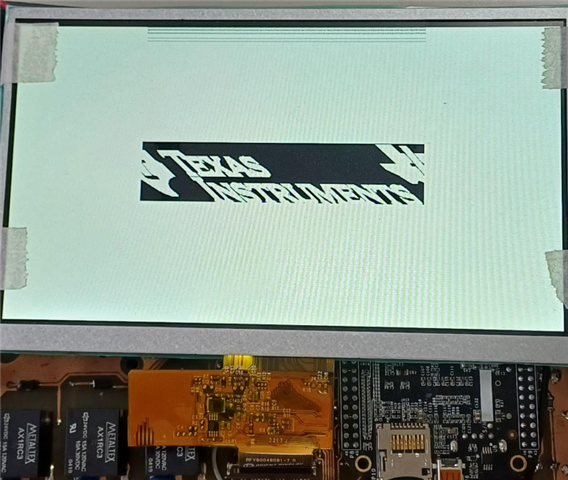

    Then, I replaced the MLO, u-boot.img, and ti_logo files, rebooted the system, and got this result
    Attached boot image default + compiled u-boot: boot image default + u-boot splash.txt
    U-Boot SPL 2023.04-dirty (May 12 2025 - 07:48:02 -0300)
    Trying to boot from MMC1
    U-Boot 2023.04-dirty (May 12 2025 - 07:48:02 -0300)
    CPU  : AM335X-GP rev 2.1
    Model: TI AM335x BeagleBone Black
    DRAM:  512 MiB
    Video device 'lcdc@0' cannot allocate frame buffer memory -ensure the device isn
    Error binding driver 'tilcdc': -28
    Some drivers failed to bind
    Error binding driver 'ti_sysc': -28
    Error binding driver 'simple_bus': -28
    initcall sequence 9ffdae84 failed at call 80818495 (err=-28)
    ### ERROR ### Please RESET the board ###
    As you can see, now the U-Boot I compiled is loaded, but a memory error appears.

  • Hi Andreas,
    Thank you for your previous guidance. Following your suggestions:
    1. DTB Fix: I included am335x-evm-u-boot.dtsi in am335x-boneblack.dts, recompiled the DTB, and loaded the changes. This resolved the memory error, and the bmp command is now available in U-Boot.
    2. BMP Loading: I successfully loaded the image into memory:
      fatload mmc 0 $loadaddr ti_logo_414x97_32bpp.bmp.gz
      (12,285 bytes read, no errors).
    3. Issue: When running:
      bmp display $loadaddr m m
      No output appearsno error messages, no visual output on the display, and no changes to the console.
    In the E2E thread, the user resolved this by adding LCD pinmux configuration:
    lcd_pin_mux and configure_module_pin_mux(lcd_pin_mux)
    What do you recommend I try next?

  • Hi Andreas,
    Thank you for your continued support.
    Following your suggestions, we performed measurements after running the bmp display $loadaddr m m command. We confirmed that the LCD backlight is correctly powered. However, when we probed the LCD data and control lines, we did not detect any activity—no transitions or signal changes were observed.
    Just to provide full context, in our current Debian image setup, the only configuration related to the LCD is the following device tree overlay:
    uboot_overlay_addr0=/lib/firmware/BB-BONE-4D7N-01-00A1.dtbo
    This is the only modification we’ve made to enable the LCD. We haven't applied any additional pinmux settings or custom DT configurations beyond this overlay.
    Please let us know what you recommend as the next step.

  • Hi Andreas,
    Thanks again for your continued support.
    As part of debugging the LCD splash screen, I wanted to share the process I’ve followed and some files with you:
    • First, I’m attaching the overlay I used successfully under Debian (BB-BONE-4D7N-01-00A1.dts). This overlay activates the LCD on boot.

    • Then, I’m also attaching the original am335x-boneblack.dts from the TI SDK (09.03.05.02), unmodified.

    • Since I understand that overlays are not supported the same way in the SDK, I tried to manually merge the overlay into the SDK’s am335x-boneblack.dts. I’m not very experienced with Device Trees, but I did my best to replicate the panel and pinmux configurations.

      When I run the following U-Boot commands:
      => fatload mmc 0 $loadaddr ti_logo_414x97_32bpp.bmp.gz
      => bmp display $loadaddr m m
      I get this error:
      Error: 16 bit/pixel mode, but BMP has 0 bit/pixel
      So far I’ve verified:
      • The image is correctly loaded to RAM (12,285 bytes read).
      • The LCD backlight is on.
      • Using an oscilloscope, I see activity on the LCD data and control lines.
      • I tried converting the BMP to 24bpp, but that didn't help.
      • I suspect I may be missing some configuration in the DTS, maybe something related to color depth or display mode.
      Would you have any suggestions as to what could be missing or misconfigured?
      Thanks again for your guidance!
      Rafael
  • Hi Andreas,
    Following up on my previous message, I wanted to share a few more tests I’ve conducted regarding the splash screen issue.
    I converted the 32bpp compressed BMP image to an uncompressed 16bpp BMP version. Then, using the command:
    U-Boot no longer shows an error message, but the splash still doesn’t appear on the screen.
    Additionally, I recompiled the Device Tree with the following panel-info settings adjusted for 32bpp:
    panel-info { ac-bias = <255>;
    ac-bias-intrpt = <0>;
    dma-burst-sz = <16>;
    bpp = <32>;
    fdd = <0x80>;
    sync-edge = <0>;
    sync-ctrl = <1>;
    raster-order = <0>;
    fifo-th = <0>; };
    I tried again using the 32bpp compressed BMP (ti_logo_414x97_32bpp.bmp.gz), but although no error was reported by U-Boot, the splash still did not show.
    So I suspect there might still be a missing setting in the panel configuration or framebuffer allocation.
    Any advice or insights would be much appreciated.
    Rafael

  • Hi Rafael,
    Are you using 16-bit(LCD_DATA0 - LCD_DATA15) display?
    I have tested the 16-bit display GEN4-4DCAPE-70CT-CLB on the BBB with PFA patches(rename to .patch).
    Looks like you are missing pin muxing changes in mux.c.
    Please ensure that your .config file contains "CONFIG_CLK_TI_GATE=y".
    If you want to display 16bpp BMP on a 16-bit display, then add "CONFIG_BMP_16BPP=y" in your config.
    I have also tested the 24-bit display NHD-7.0CTP-CAPE-N-ND on BBB (this requires additional pin muxing and display/panel info changes).
    Please let us know if this works for you or if you see any issues.

  • Hi Sukrut, I applied the .config changes (CONFIG_BMP_16BPP=y, CONFIG_CLK_TI_GATE=y) and updated both the .dts and mux.c files based on your patch — the splash screen is now showing, thank you! Raised hands
    The image appears slightly tilted or in perspective — I’m attaching a photo so you can see it:
    Below I’ll share the steps I followed so far.

    From here, what we should look into next is:
    1. Correcting the tilt/perspective of the image
    2. Getting the splash screen to run automatically at boot, without interrupting U-Boot
    3. Figuring out how to integrate everything needed into this SDK image so it can launch the Python Qt app like my Debian setup does
    Thanks again for all the help!
    Rafael
  • Hi Sukrut,
    Quick update — I replaced the image with one I generated myself in flat 16-bit BMP format (RGB565), with a resolution of 800x480. When I load it uncompressed (as a .bmp instead of .bmp.gz), it now displays correctly on screen, without any tilt or distortion.
    I'm not entirely sure what caused the tilt with the original image — maybe something related to compression or BMP formatting — but I'd definitely be interested if you have any insights on that.
