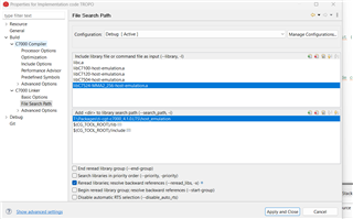

TDA4VM: Infinite loop while debugging on CCS, probably due to the use of read() function on a binary file on the DSP C7x
Part Number: TDA4VM
Hello TI,
My goal is to write C++ code that allows me to load a binary file in CCS and then store those values in an array.
My array contains complex numbers, having floating real and imaginary parts. This type has been implemented within a class that I called "CGestionFichier," which is used to manage the downloading and creation of files within my project. Below, here is the code for the header file as well as the source file of this class:

The problem encountered with this project is as follows: when I start a debug session on the DSP C7x, I find myself in an infinite loop. If I pause this session, I consistently land in the code of trgmsg.c, more precisely
Now, if I debug step by step, I find that the problem arises from the use of the read() function (line 86 of the file CGestionFichier.cpp) in CGestionFichier::chargerFichierEchantillonEnMemoire(). As soon as I reach this line, the code enters an infinite loop.
What could this be due to? Can anyone shed light on the problem encountered?
Thank you in advance,
Mélanie

  • Hi Mélanie,
    Is this thread related to : https://e2e.ti.com/support/processors-group/processors/f/processors-forum/1508115/tda4vm-errors-while-using-c-libraries-string-and-istream-on-ccs
    Thanks for providing the steps and code. I will try it from my side and update you within a day.
    Sivadeep
  • Hi SIvadeep,
    No it is not !
    Okay, thank you for your help,
    Mélanie
  • Hi Mélanie,
    I tried running your code in bare-metal mode but encountered some issues. I have a few follow-up questions:
    1. Are you running the code in noboot or sdboot mode?
    2. Which version of CCS are you using?
    3. Which version of the PSDK are you using?
    Sivadeep
  • Hi again Sivadeep,
    1. I think I'm running the code in noboot mode, but I'm not sure of that.. Where can I check that?
    2. I'm using the 12.6.0.00008 version of CCS
    3. I'm using the psdk_rtos_auto_prebuilt_07_00_00 version of PSDK and also the sdk : ti-processor-sdk-rtos-j721e-evm-10_01_00_04
  • Okay,

    - About running the application in Host Emulation mode, I do not know how to do it. Could you give me some hints ?
    Could you please check the steps below to configure the Host Emulation mode:

  • Okay,
    Well, I didn't add those librairies in the File Search Path of the C7000 Linker inside the properties of my project. Also, I added the corresponding path in the Include options. Here are the changes I've done to the project :
    However, despite adding them, I still got stuck in that same infinite loop.
    Also, I tried adding also the .lib libraries, which I believe is unuseful. When compiling, I got that error : error #99923: Corrupt member header: 'T:/Packages/ti-cgt-c7000_4.1.0.LTS/host_emulation/C7524-MMA2_256-host-emulationd.lib'

    Then, I don't understand how we activate or not the Host Emulation mode inside a project ... Is it activated simply by adding all the host emulation librairies ?

  • I'm sure I don't understand everything in this long thread.  Please be patient with my errors and questions.
    Note that host emulation requires using a compiler that builds for execution on your host system, and not a C7000 CPU.  For an introduction, please view the host emulation video from the C7000 video series.  That being the case, it confuses me to see you trying to build for host emulation inside of CCS.
    With regard to using I/O operations like << and getline, please see the article Tips for using printf.  While it is focused on C functions like printf, much of it applies here.  Note how it relies on a debugger (usually CCS) to work.  Is that what you are doing?

    Regarding the use of host emulation inside CCS, I did that because Sivadeep told me that it was the way to use it. Otherwise, I don’t know much about host emulation, so I followed his instructions. After watching the video you provided, I realize that we didn’t use the host emulation correctly.
    Despite that, I don’t understand how using host emulation to run code for C7x will solve my issue? For me, it just allows me to use intrinsics and TI vector types of C7X on a PC or Linux host system.
    Regarding the use of I/O operations, I consulted your website, and I’m indeed using the low-level Unix-style I/O functions that are considered part of the C I/O functions in the RTS (like read)
    Mélanie
  • I don’t understand how using host emulation to run code for C7x will solve my issue?
    Please ignore host emulation as a possible solution.  I think Sivadeep suggested it as yet another way to see if your program has problems.  But because ...
