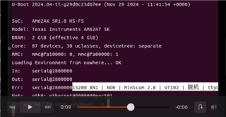

Here is the startup time in the evm board.
1. u-boot    5s (Using Serial NAND Boot Mode) with SOC type hs-fs
2. Linux Kernel   13s
3. usr space :  5s
4. application : 3s
Total : 26s

  • Hi Meng,
    You can achieve fast boot when you use SBL boot flow.
    Please follow the instructions provided in the below link to achieve fast boot.
    https://software-dl.ti.com/processor-sdk-linux/esd/AM62AX/10_01_00/exports/docs/linux/How_to_Guides/Target/How_to_boot_quickly.html
    Also, you can use the below thread as a reference in order to achieve Falcon mode enabled in SPL (Program loader) boot flow. This is for AM62x SoC but you should be able to do similar changes for AM62A.
    https://e2e.ti.com/support/processors-group/processors/f/processors-forum/1506904/am625sip-falcon-boot-on-sdk-10
    Hope this helps.
    Suren

    CTRL-A Z for help | 115200 8N1 | NOR | Minicom 2.8 | VT102 | Offline | ttyUSB0
    However, the boot time is still 10s counting from the first line in log. I am using tiny filesystem and I am using sdk 10.1 and sd boot mode.
    I will try emmc boot mode later.
    Adam
  • Hi Suren,
    Now I am using EMMC booting now, but the booting speed is still slow:

    [2025-05-20 18:56:37.753]
    [2025-05-20 18:56:37.753]  _____                    _____           _         _
    [2025-05-20 18:56:37.769] |  _  |___ ___ ___ ___   |  _  |___ ___  |_|___ ___| |_
    [2025-05-20 18:56:37.769] |     |  _| .'| . | . |  |   __|  _| . | | | -_|  _|  _|
    [2025-05-20 18:56:37.770] |__|__|_| |__,|_  |___|  |__|  |_| |___|_| |___|___|_|
    [2025-05-20 18:56:37.785]               |___|                    |___|
    [2025-05-20 18:56:37.785] Arago Project am62axx-evm ttyS2
    [2025-05-20 18:56:37.785] Arago 2023.10 am62axx-evm ttyS2
    [2025-05-20 18:56:37.785] am62axx-evm login:
    here is my steps
    1. in SDK
    cd filesystem/
    mkdir output
    cd output/
    tar -xf ../tisdk-tiny-image-am62axx-evm.rootfs.tar.xz
    ln -s sbin/init init
    cd dev
    sudo mknod -m 0666 null c 1 3
    2. add the following to arch/arm64/configs/defconfig in linux
    CONFIG_INITRAMFS_SOURCE="/home/ht/ti-processor-sdk-linux-edgeai-am62a-evm-10_01_00_05/filesystem/output"
    3. in SDK top folder
    make linux
    4.
    sudo cp board-support/ti-linux-kernel-6.6.58+git-ti/arch/arm64/boot/Image /media/ht/root/boot/Image-initramfs
    cd /media/ht/root/boot/
    sudo ln -sf Image-initramfs Image
    sync
    then boot from sd card.
