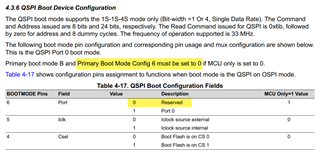

What is then correct value for QSPI mode port - BOOTMODE pin 6 ?  (MCU Only=0)
Text says to set it to 0, which is "Reserved" according to the table.
There is only OSPI port 0 on DRA821U
