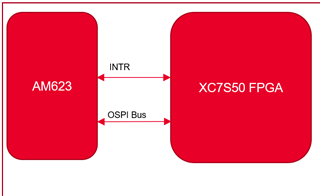

Greetings TI Support Team,
I am looking for information related to the DMA capabilities on the AM62x processor.
In our application, we are connecting AM623 OSPI to an external FPGA. The plan is to retrieve a block of multiple 64bit data from FPGA upon receiving an interrupt from FPGA. We would like to how to trigger DMA transfer upon receiving an interrupt from FPGA.
The following are the questions that we have currently.
  • Is there an interrupt-driven DMA interface available for AM62x?
  • Can this interface be used to efficiently write data to or read data from memory or peripherals?
  • Are there any recommended drivers or examples available in the SDK for implementing such transfers?
Any documentation or guidance you could provide would be helpful.

    And, we have used OSPI bus as our communication interface between the FPGA and ARM processor.
    So, the FPGA is basically sending 64bit data at 10us with some delays (these delays between them are random, typically from 10us to 100us). The problem is that I am not able to read the data fast enough to clear the FIFO.
    Hence, we want to check if moving it to DMA helps us read quicker?

    First of all, Linux currently doesn't support GPIO interrupts directly trigger DMA transfer.
    Does it mean the FPGA generates interrupts in intervals of 10~100us? That is alot of interrupts.

    FPGA to ARM, Register read / write is through OSPI interface
    ARM reads the FPGA's 32 bit FIFO register through OSPI.
    Now, a register from the FPGA allows me to check the status of FIFO. Details like (Fifo Empty, not empty, full).
    FPGA's interrupt pin is based out of a status register. When the FIFO has data, and the status register detects FIFO not empty, in the FPGA, it drives a GPIO pin.
    So, when I get the GPIO interrupt I am supposed to read the all the data out of the FIFO until the status register indicates that the FIFO is empty.
    It's basically one interrupt, and in the interrupt callback there are multiple reads until the status register indicates an empty FIFO.
    The data samples could have a variable delay (10us - 100us), and these are random. But the data that we receive is 64 bits in 10us. Hence, we wanted to check if we can have a DMA interface to read / write data from the FPGA and ARM.

  • Hi Maneesh,
    In a single 4096x64bit frame, does the GPIO interrupt happen once or 4096 times?
    I don't think the DMA can support either way. If the interrupt happen once per 4096x64bit frame, the DMA is unable to pulse for 10+us until the next 64bit come. If the interrupt happens once per 64bits, I think we can program the DMA cyclic mode and each transfer is triggered by each GPIO interrupt, however currently the AM62x DMA kernel driver doesn't support this feature.

  • Hi Bin Liu,
    |--64bit data @ 10us--|---Delay between samples (10us to 100us)---|--64bit data @ 10us--|...
    - The GPIO interrupt triggers after it sees 1st data in the FIFO. FPGA is interfaced via OSPI to the ARM.
    - Right now, from the benchmarks that I have computed, FYR
    * 32 bit OSPI read times
    Average read time:   0.000038298 seconds (~38.2 us)
    Minimum read time:   0.000022815 seconds (~22.8 us)
    Maximum read time:   0.002297820 seconds (~2.3 ms)
    So, for 64bit it is 2 32bit reads, because the read end of the FIFO is 32bit.
    * Time taken by the Interrupt callback to  to kick in after the GPIO interrupt arrives
    Min Time taken to kick the ISR: 0.004383 seconds (~4.38 ms)
    Max Time taken to kick the ISR: 0.005025 seconds (~5.02 ms)
    So, by the time ISR callback kicks in, I already have atleast 72 samples in the FIFO. And, when I read those samples there are newer samples filling in the FIFO.
    Hence, I want the data coming from the OSPI to be directly written to DMA.
    So, once the ISR kicks in, I just program the DMA to read bulk of data from the OSPI.
    So, please help me with resources that can help me read / write from /to DMA from / to the OSPI, program the DMA.
    Does this clarify my query?

    As I explained, the DMA transfer has to be at a fixed frame length per interrupt. But in your use case, the OSPI has 64bit data per 10us without interrupt or unknown data length in each interrupt. I don't the DMA can be used in your OSPI/FPGA use case.
  • Ok, Now I understand.
    I can configure the Interrupt to trigger after 2048 such samples fill the FIFO. Let's say I fix the frame size to 2048 x 64bits.
    Is it possible for me to read that data?
  • Hi Maneesh,
    I checked the kernel OSPI driver (drivers/spi/spi-cadence-quadspi.c), it uses DMA MEMCPY mode to read from OSPI, which means the entire 2048x64bits data have to memory mapped. But it seems your OSPI data FIFO are 16bit wide. So it seems the kernel OSPI driver still cannot use DMA to read the OSPI/FPGA data for your use case.
    For your OSPI/FPGA configuration, which has 16bits wide FIFO, the DMA should use DEV_TO_MEM transfer, however the current kernel DMA driver does not support DEV_TO_MEM transfer on AM62x OSPI interface.
  • Hi Bin Liu,
    From what I understand, the current implementation of the 'spi-cadence-quadspi.c' has only Memory to Memory transfer i.e., DMA MEMCPY and no DEV_TO_MEM right now correct?
  • That is correct.
    Also the kernel DMA driver (drivers/dma/k3-udma.c) doesn't support DEV_TO_MEM on peripherals which do not have PDMA module (if you are not familiar with PDMA, please review the TRM), OSPI interface doesn't have PDMA. So even if spi-cadence-quadspi.c was updated with DMAEngine DEV_TO_MEM transfer, k3-udma.c still doesn't support it.
