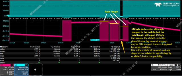

  • Hi Judith,
    In order to distinguish if READ or WRITE operation triggered the error. customer did experiment as below.
    Linux SDK8.3, custom board, mounted 22ohm serial resistor on data line already. refer this post for serial resistor background:
    https://e2e.ti.com/support/processors-group/processors/f/processors-forum/1507836/am623-why-can-serial-resistor-eliminate-emmc-io-error
    Experiment method: Do md5sum to a ~12MB size file repeatedly, compare result of each time to ensure only doing read operation.
    Experiment condition: In temperature chamber at 65c. captured I/O error log, error persist once triggered.
    dmesg_IO_error_of_eMMC_md5sum_operation.log

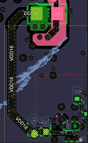

  • Tony,
    The issue on SK-AM62B-P1 EVM has been understood and resolved so that the CQE recovery no longer occurs.
    This issue was narrowed down when the failing data transfer was localized to a pattern of 0xFF00 which then allowed us to reliably recreate the failure. This pattern causes data transitions from 0->1 on every transition, stressing the IO power supply. Once this was identified, the focus shifted to the EVM PDN. It is worth noting, this pattern only failed when transferred in a size of 1480B and above.
    The SK-AM62B-P1 EVM had poor placement of the SOC_DVDD1V8 decaps. These should be placed near the SOC pins, but on the SK-AM62B-P1 EVM they were far from the SOC.
    The EVM was modified following the attached rework instructions:
    /cfs-file/__key/communityserver-discussions-components-files/791/ECN-SK_2D00_AM62B_2D00_P1-_2800_PROC142A_2900_-_1320_-add-capacitor-to-VDDSHV4-pin-T7.pdf
    After these improvements were made, the 0xFF00 pattern transfer no longer failed.
    For the customer to determine if they are similarly impacted they can do two things:
    1. Transfer a pattern of 0xFF00 and see if it consistently reproduces the failure
    2. Inspect their board layout to determine if the placement of the high frequency decaps is close to the SOC or if it resembles the EVM implementation.
    Chris

  • Hi Chris,
    Test with the ff00-3K.dat file on custom board, can 100% trigger the IO error, even on the board which is not triggered by themselves test data file.
    Then modify board capacitor:
    HW: On custom board, VDDSHV4 pin capacitor placement as snapshot: 2mm trace to via, 0201 10V 1uF  and 0402 6.3V 4.7uF.
    Due to space limitation around the via, add extra cap on the original cap pad:
    #1. Add one 0402 0.1uF and one 0402 1uF: still 100% IO error
    #2. Add two 0402 4.7uF.: still 100% IO error.
    Customer did not observe VDDSH4V 1V8 fall outside of recommended range during test, how about the VDDSHV4 power supply fluctuation on AM62-SK-P1 during stress test?
    Further suggestion to custom board?

  • Hi Tony,
    Can you share information about the capacitors and placement of capacitors for the eMMC device? If the problem occurs with reads with the FF00 pattern, then that may indicate eMMC power issue.
    Is it possible to share the layout file privately?
    Also, the software team wants to focus on the SDK9.2 board instead of SDK8.3.

    Since we have root caused the AM62x EVM to the MMC IO power supply issue and resolved this on the EVM this is where we are trying to focus for this customer solution to see if it is the same root cause.
    We have not been able to simulate to get a measure of loop inductance with the layout files as shared by the customer. Mark will follow up via email for additional requests to try and get this information. This will help give us a quantitative measure of PDN performance on the customer board.
    We also request the customer to perform an experiment using the test setup they currently have to attempt to measure the power supply noise in both the read and write direction.
    A way to get an estimate of the impact of power supply noise is to:
    • Hold one data signal high, toggle all other data signals 0->1->0->1... Probe the held high signal and look for fluctuations in voltage level.
    • Hold one data signal low, toggle all other data signals 0->1->0->1... Probe the held high signal and look for fluctuations in voltage level.
    For reference, on the failing EVM this test was performed in the write direction only and the static high signal showed fluctuations from 1.4V to 2.V (1.8V nominal).
    The customer will have to take care to ideally measure the impact of reads and writes separately since they are seeing issues in both directions. This will help to confirm there is some impact from power supply noise to see if the failure is the same as the EVM or if this is a separate issue.
    Please follow up if there are any questions on setup or data pattern.

  • Update the waveform captured during the failure.
    #1. The failure occurs in middle of transmit, so its not related to signal integrity, or eMMC device compatibility.
    #2. eMMC access in block basis of 512Byte, in the fail block, although stopped for ~128clock, but the total length is still 512clock, seems the eMMC controller doesn't stop transmit although the signal stopped output.
    #3. Need analysis from IP, SOC structure level, not application level.
